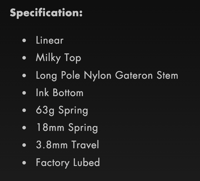

I originally thought the difference stems from the stem material because Cream Soda, as displayed at Keebhut (presumably owned by PunkShoo) say the stem is made of Nylon:

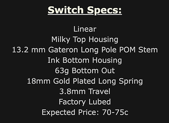

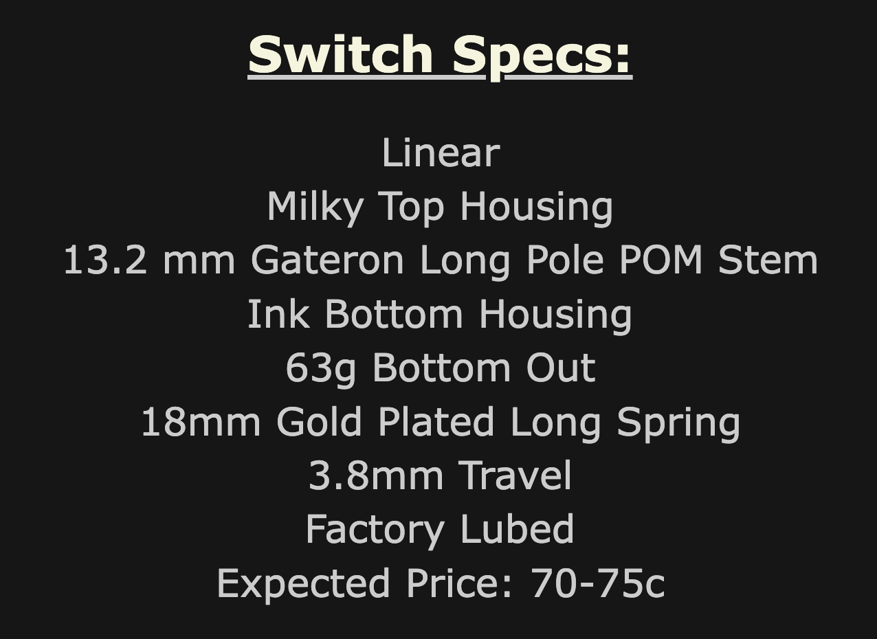

But I just noticed that the original GeekHack group buy post by PunkShoo say the stem is made of POM:
If the stem material was changed from POM to Nylon for the sound difference mentioned above, that’s some fine switchcraft work there.
