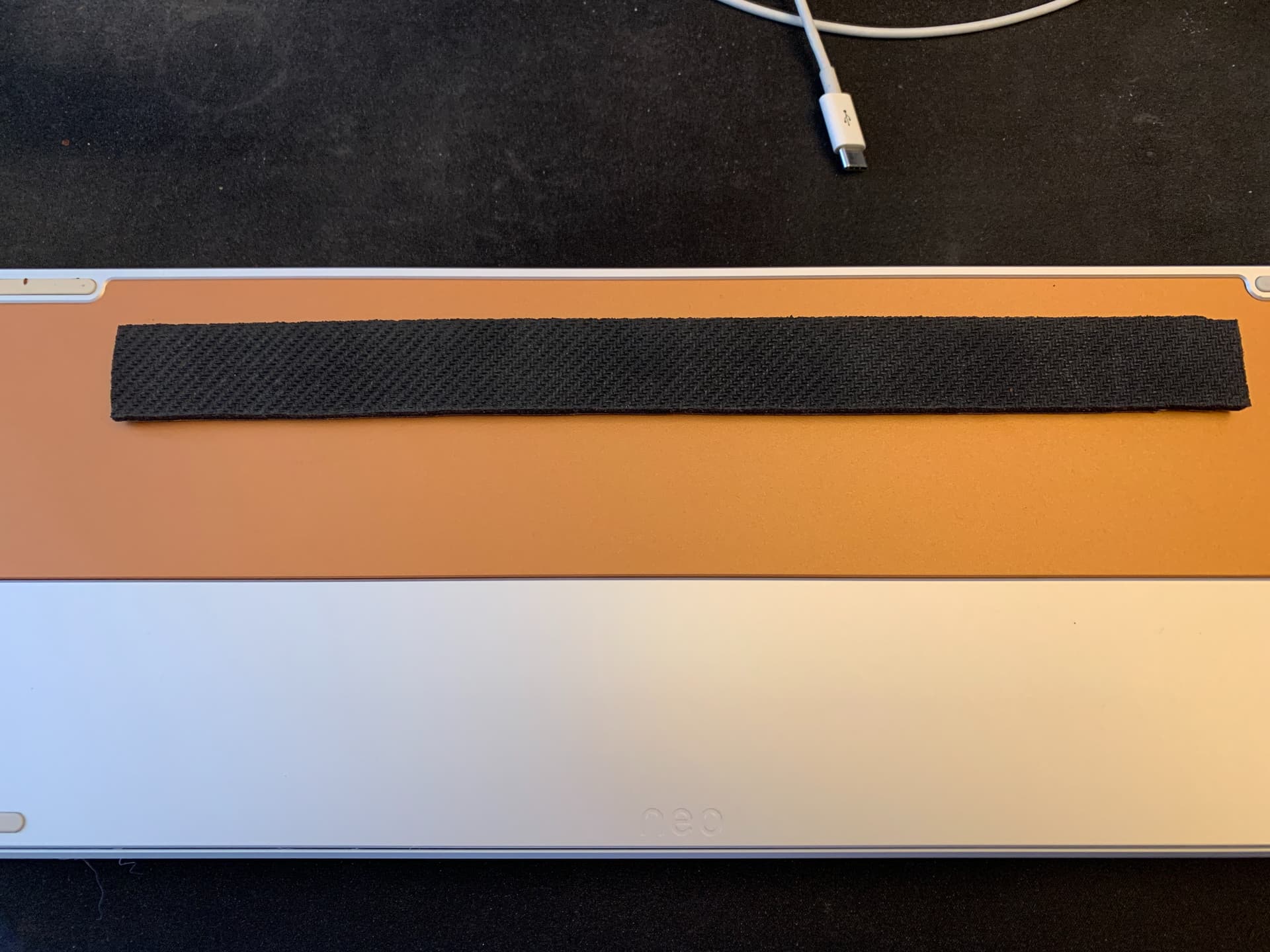

Until I find time to prototype some ideas, this 5-min hack should do. It’s just a long slice of NK Corkie attached using Blu Tack but does the job. Zero wobble. Typing angle depends on where its placed but range is limited.
Thoughts:
  • Angle change increments should be at least 0.25 to 0.5 degree.
  • This could be done at case design level of course, possibly extending the range of angles to negative range. I found that reverse angle can be very comfortable when used with standing desk.

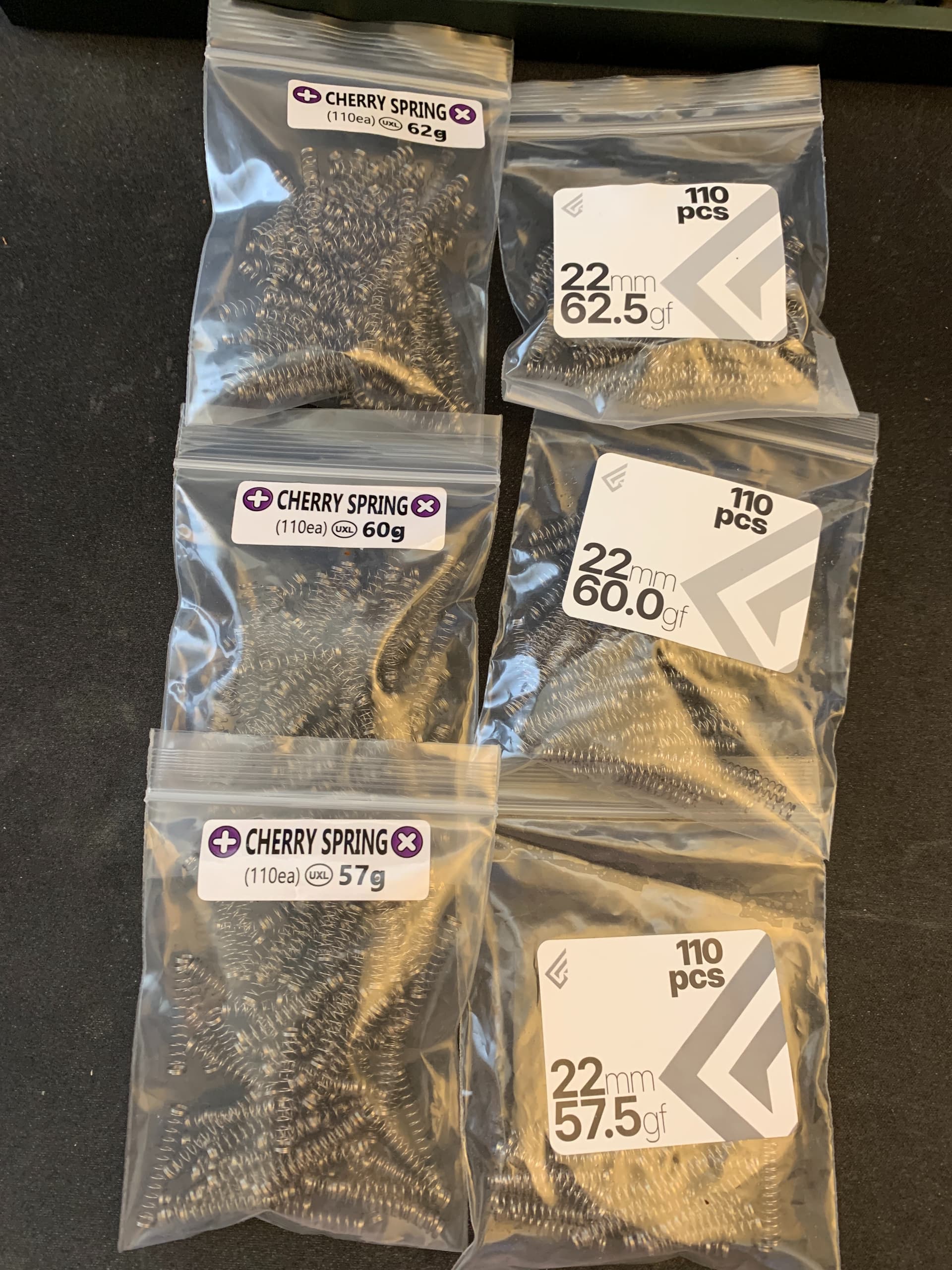

Tested some 22mm single-stage KOS springs from TX and Geon, both via Mekibo.

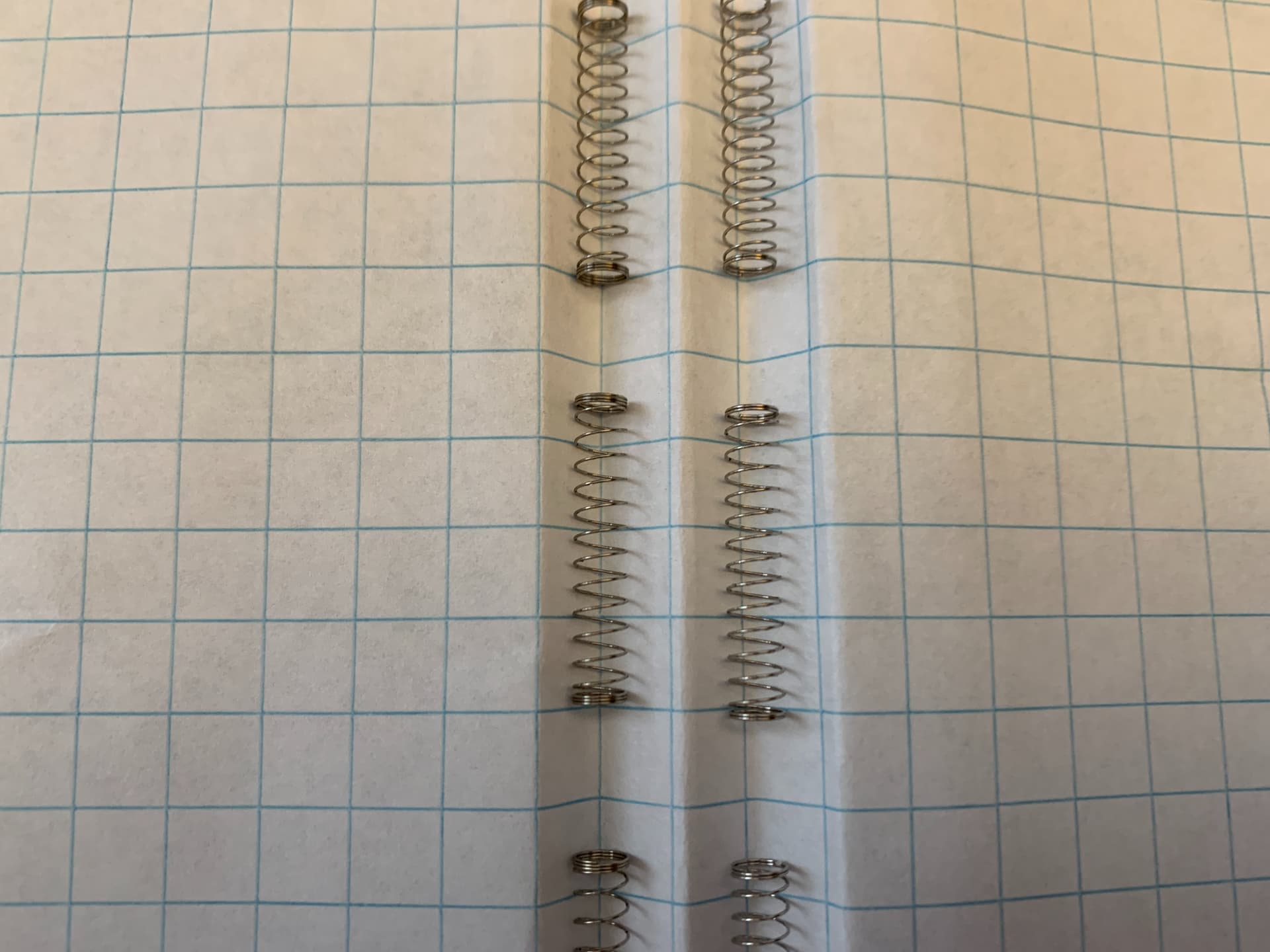

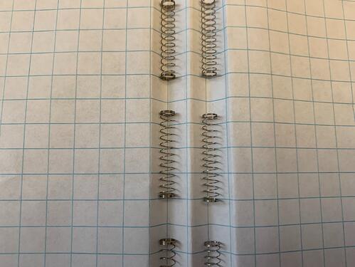

While there is $2.50 price difference (TX: $7.50, Geon: $5), the two are very very similar in feel and weight. Both are sparse and falls apart easily. Who doesn’t love that?
But they’re not the same in appearance. TX has more end coils than Geon. Geon wire looks slightly thinner.
So, go with Geon springs over TX when both are available. Same but cheaper. I also learned that super long 62.5g single-stage spring is not too heavy for me.
UPDATE: Turns out TX 22mm single-stage springs are slightly heavier than equivalent 22mm single-stage Geon springs. Also some minor yet noticeable differences stem from TX single-stage wire being thicker and coils sparser where Geon springs are thinner but more dense. So each have character but the value of the differences is still not enough to erase 50% price difference.
