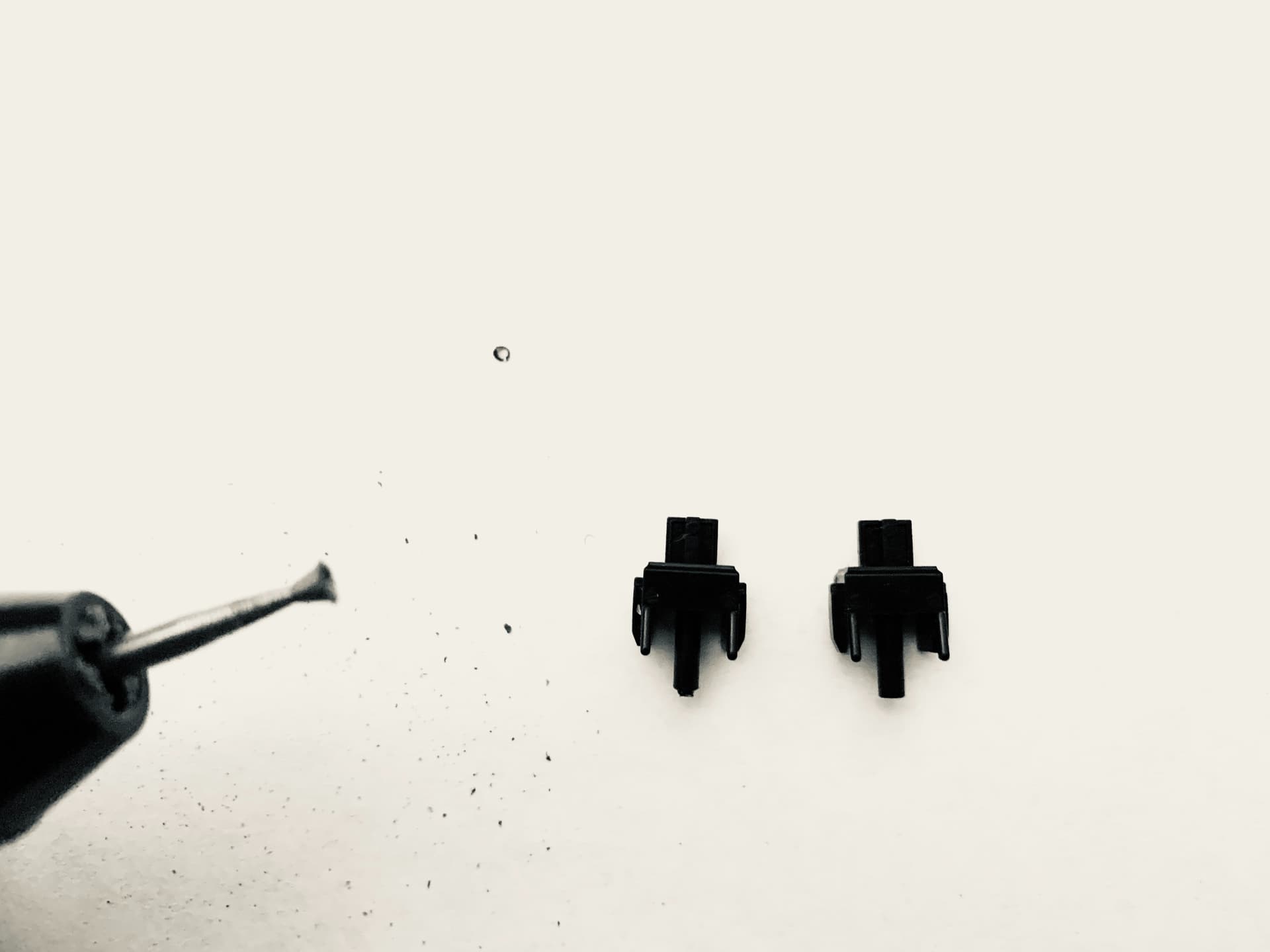

Bowl-shaped grinder Dremel bits arrived. Result from sharpening the tip of one Kailh Black v2 stem (it was hard to see the tip so I had to max exposure).
Among 12 bits I received for $8 something, I chose one that fits just right so only edges would touch. It took a bit more force than I expected but this is what I ended up with. Total length didn’t change but now it has a narrower tip. The stem on the right is the original Kailh Black v2 stem.
Tested and verified that the sharpened stem in a Cherry Black no longer gets squeezed at the end. Sound profile changed to long pole-like sound but that’s to be expected.

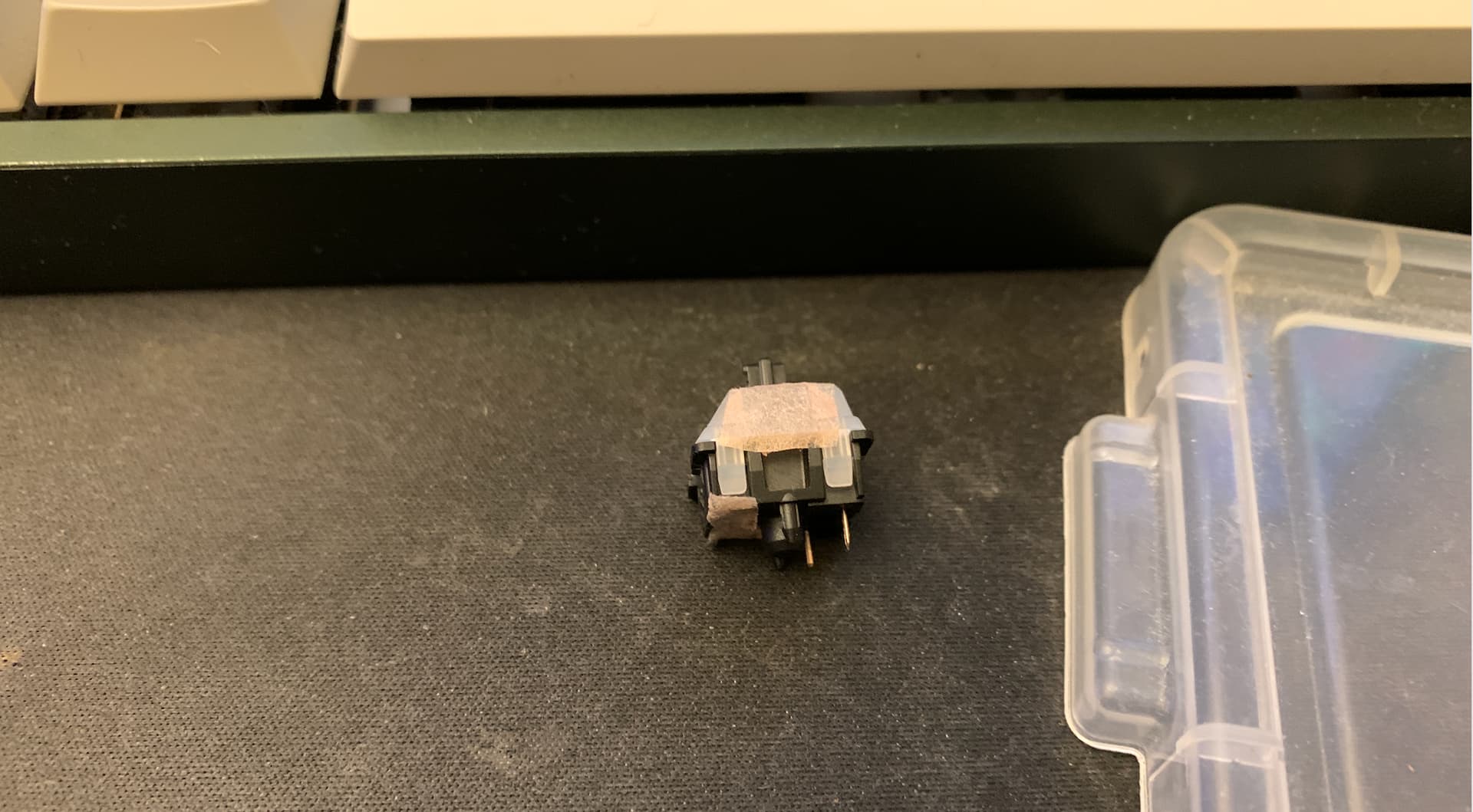

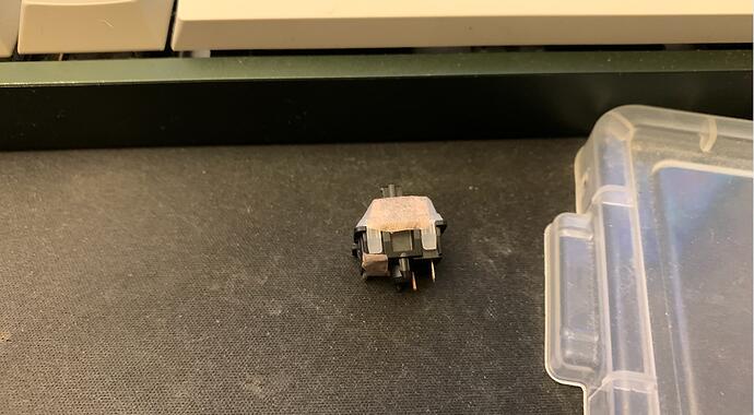

  • Finished coating the second half of Cherry “Hyperglide” Brown set. Whether looks good so I’m going to leave it outside in the backyard to give the final layer some more TLC. This set will be paired with 58g CK Slow Springs to turbocharge the wimpy bump.
  • Successfully degreased 100+ Cherry MX Clear stems using Vertrel XF vapor. They feel like new now. I started coating one MX Clear stem with RO-59 to see whether rest of the pile is worth coating or not. First layer looks pretty good, surface glistening instead of usual matte clorox white.
UPDATE: Tactile switches will likely need some use or time on polishing machine to address initial scratchiness around the bump since legs won’t be lubed. Doesn’t take much though. I just took what I had nearby, a roll of garbage bags, and kept rolling it across the keyboard while I watched a TV show (you’ll need a earphone if you do the same). Now it’s damn smooth with bumps still mostly intact.
