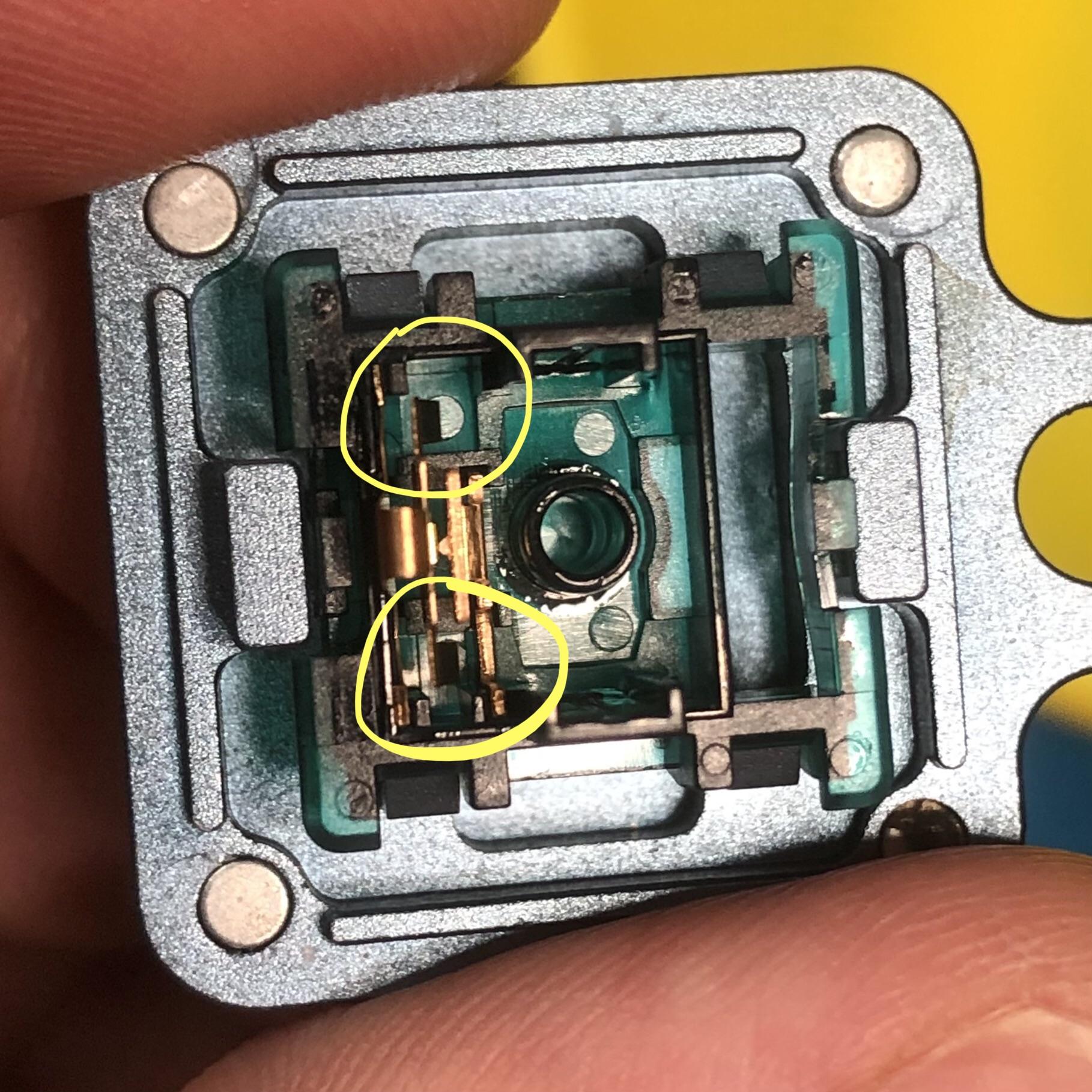

Are u sure about the ““regular”” one in the middle?
I always thought it was the keycaps or the "“roof” of the pole that said stop. :thinking:
I base this on that the legs would bend if that was the bottom out point.
The legs that touch the leaf have a little recess in the housing so they don’t actually bottom-out on anything - it’s the flat surface behind them that does.
Some housings have it looking like a shelf, others just have a little divot for the legs, but every “normal stem” stock switch I’ve seen avoids bottoming-out the legs one way or another.
Not super easy to see and this housing has some other unusual features, but the circled areas are the recesses for the legs.

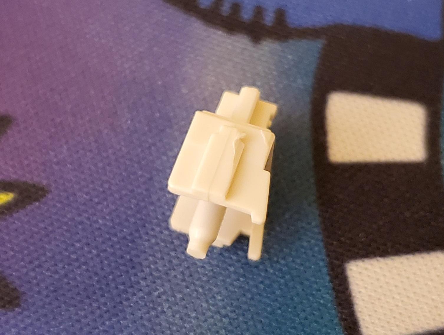

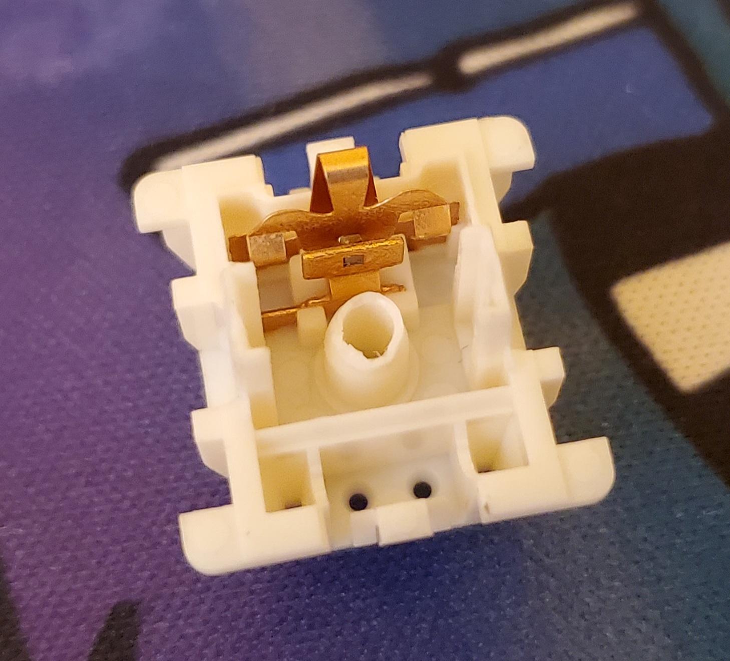

Built another setup for my Meridian last night with JWK Snow Whites. Really surprised at how nice they feel & sound even compared to other popular JWK/Durock switches. I was a little dubious of the polyamide bottom housing making much of a difference, but it definitely does. The smoothness is pretty insane, I used 55g progressive springs in these (lubed with 105), lubed the housings with 205g00, & even on the ones I rejected cause of a little too much lube there really wasn’t any sluggishness. It just made the switch sound much more muted.
Although I did come across a few duds in my batch of 110. A couple had deformed stem wells in their bottom housing, then a few had deformed stems. Not something that is exactly unheard of, but 5 bunk switches in a batch of 110 is pretty bad QC TBH
Here’s a pic of one of the deformed bottom housings & one of the deformed stems.
Anyone else ever see anything similar with JWK/Durock siwtches?
Right!?! It’s so weird. That material feels way softer than most. It’d be nice to see that in a stem one day.
I had a few of those misshapen ones, two or three out of 110 for sure.
Yeah softer is a better way of describing it than I did! It would be nice to see a stem made of polyamide if possible. I wonder if the lesser QC is because of the Snow Whites most likely being a smaller order from a smaller vendor? Like JWK/Durock just churned them out as fast as they could to get to more lucrative jobs. Cause I’ve tuned literally thousands of JWK/Durock switches & while coming across a dud every once in a while isn’t unheard of, this is the first batch I’ve had that had more than one dud in it. Oh well, even taking the duds into consideration I’d still recommend these switches (or H1s) with the caveat of buying at least 10 or 20 extra than you plan on needing.
