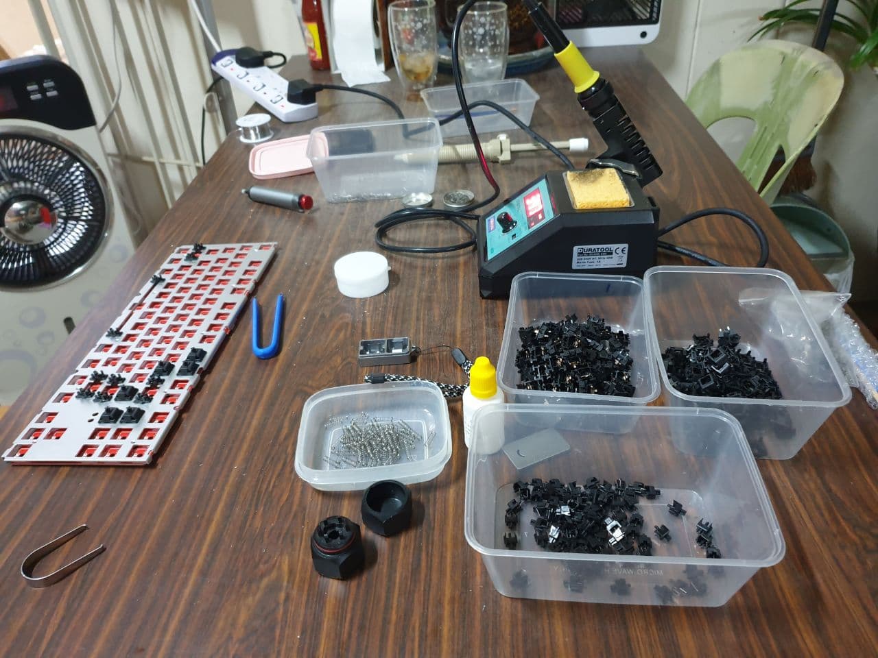

Had a buddy’s help with modding my AR87 - desoldering, lubing and re-soldering the MX Blacks. Can understand why it’s one of @donpark’s favourite linears. It’s smooth, deep and has a nice “scratch” that gives the Blacks a rather distinctive sound :slight_smile:
