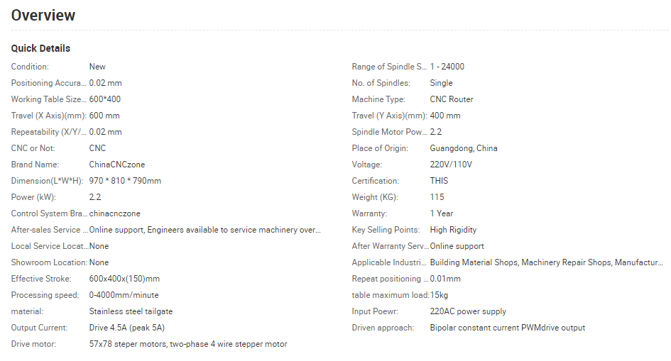

I found a 5 axis cnc machine. I was wondering how realistic it is for me to study/utilize this for a custom keeb case with these specs?
Is this this one ?
Don’t see the price but smaller models look to be at around 3000€, already pretty expensive.
Here is a Youtube video showing the machine in action:
Machinining marks are very visible, the machine is not rigid enough to give something satisfactory.
I’m confident that some CNC routers can do better with less money, but those are 3 axis only.
Either way you don’t really need 5 axis to make a keyboard case, most of the case 3 axis is enough.
