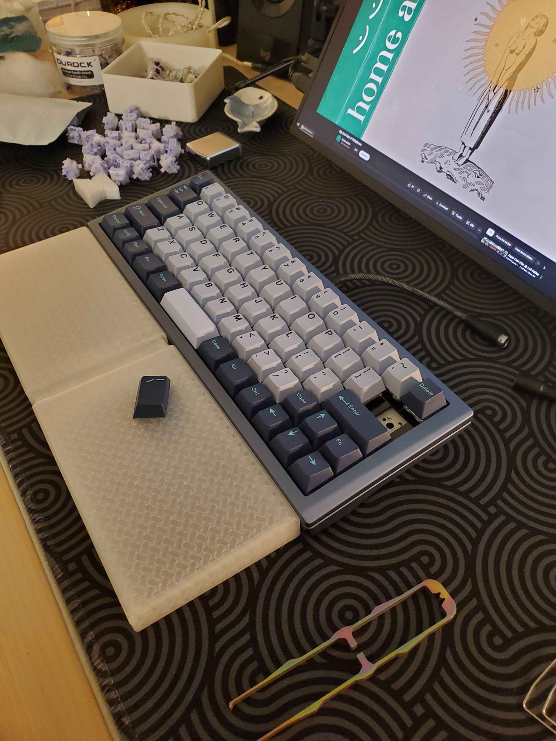

Thanks that makes me feel a bit better lol

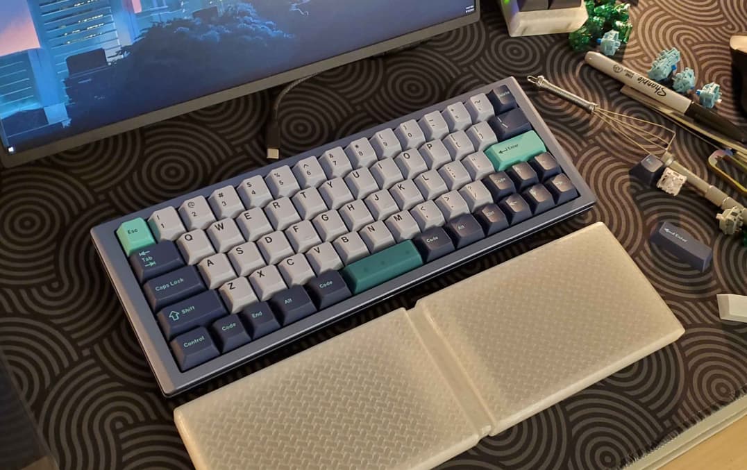

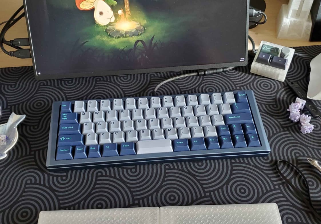

Wasn’t sure if this looks better with the accent keys, or just too many colors
I did end up ordering 40s and spacebar kits for Pacific, Cojiro, and Indigo to test out. Those were the closest I could find in color that looks like it might be close enough in color to pull off.

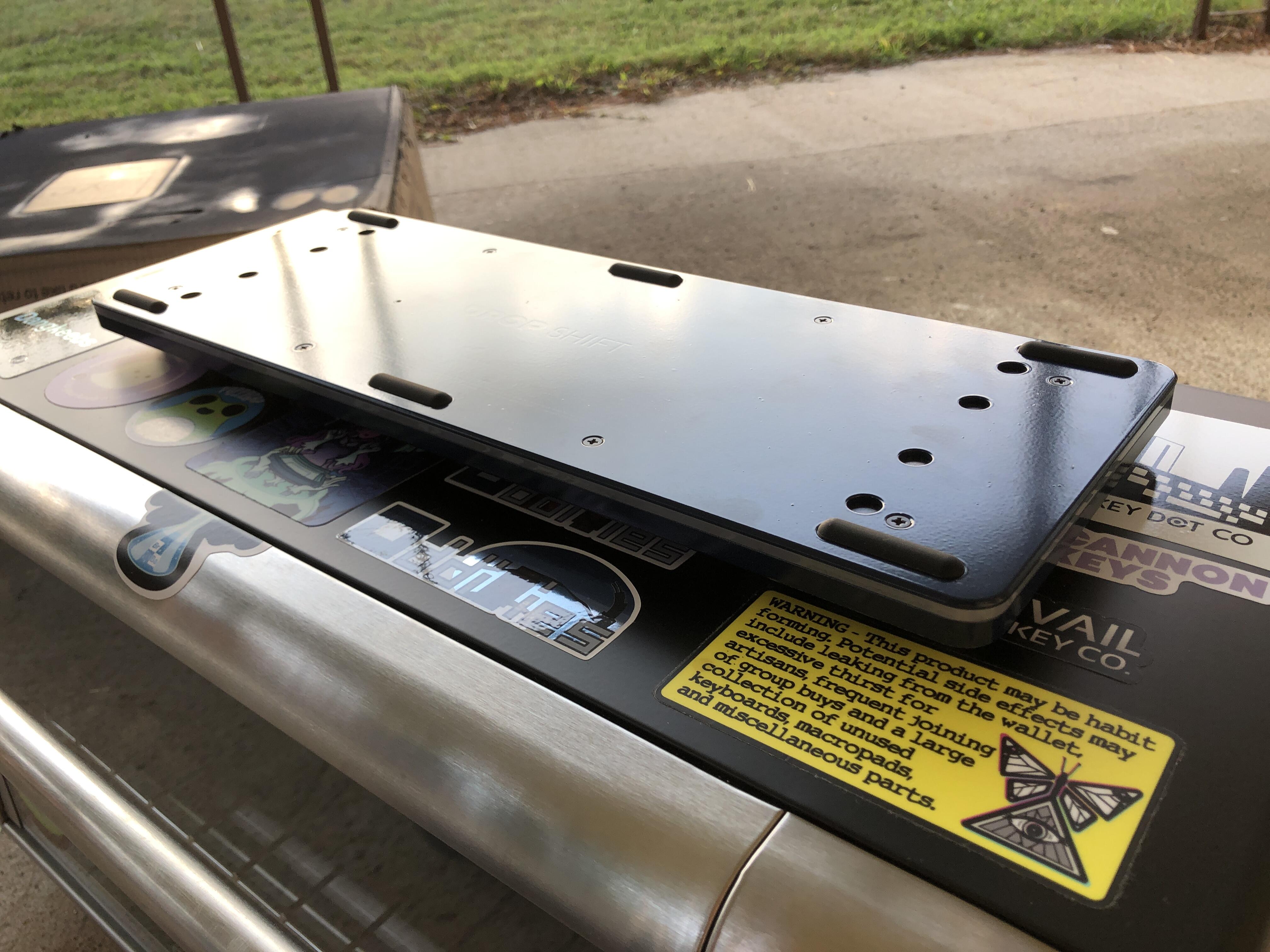

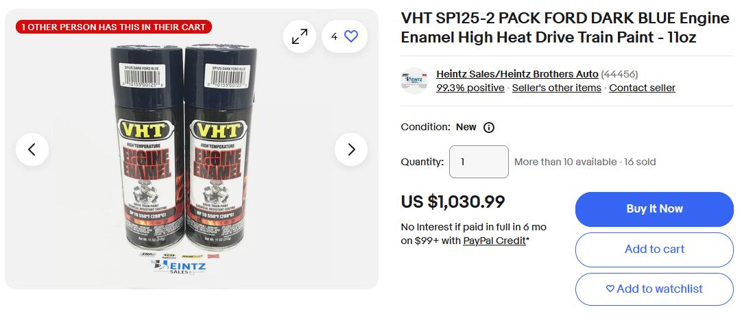

No pics yet because it’s still in the oven (literally), today I’m applying some dark blue engine enamel onto the case of a Drop Shift V2 for my dad’s birthday. I’ve had some success with enamel before using just the color spray on its own, but this time I decided to do more surface prep and use a paired primer.
I’m also using a different brand this time, as the one I’m used to has a weird situation with the color I wanted… they used to make it, and apparently it’s so sought-after that cans are going on eBay for literal hundreds to thousands of dollars. Presumably because a.) it’s quite good and b.) the color name started with “Ford” and wasn’t licensed by Ford so is now all gone from stores. :stuck_out_tongue:
In lieu of the VHT, I decided to give DupliColor a try - I’ll let you know how it goes!
Only noticed the price tag as I was navigating away.
Ouch! Hella special paint there.

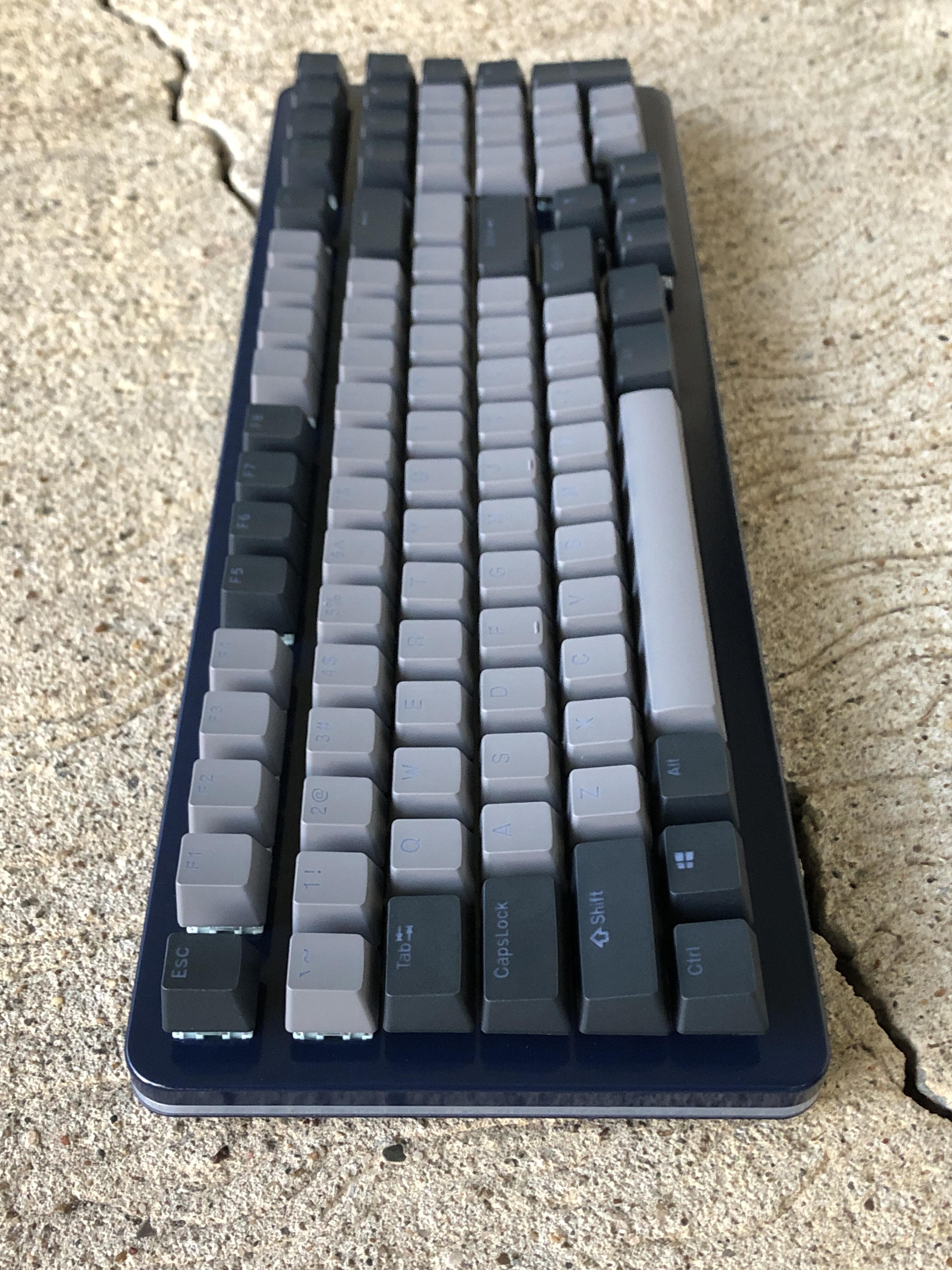

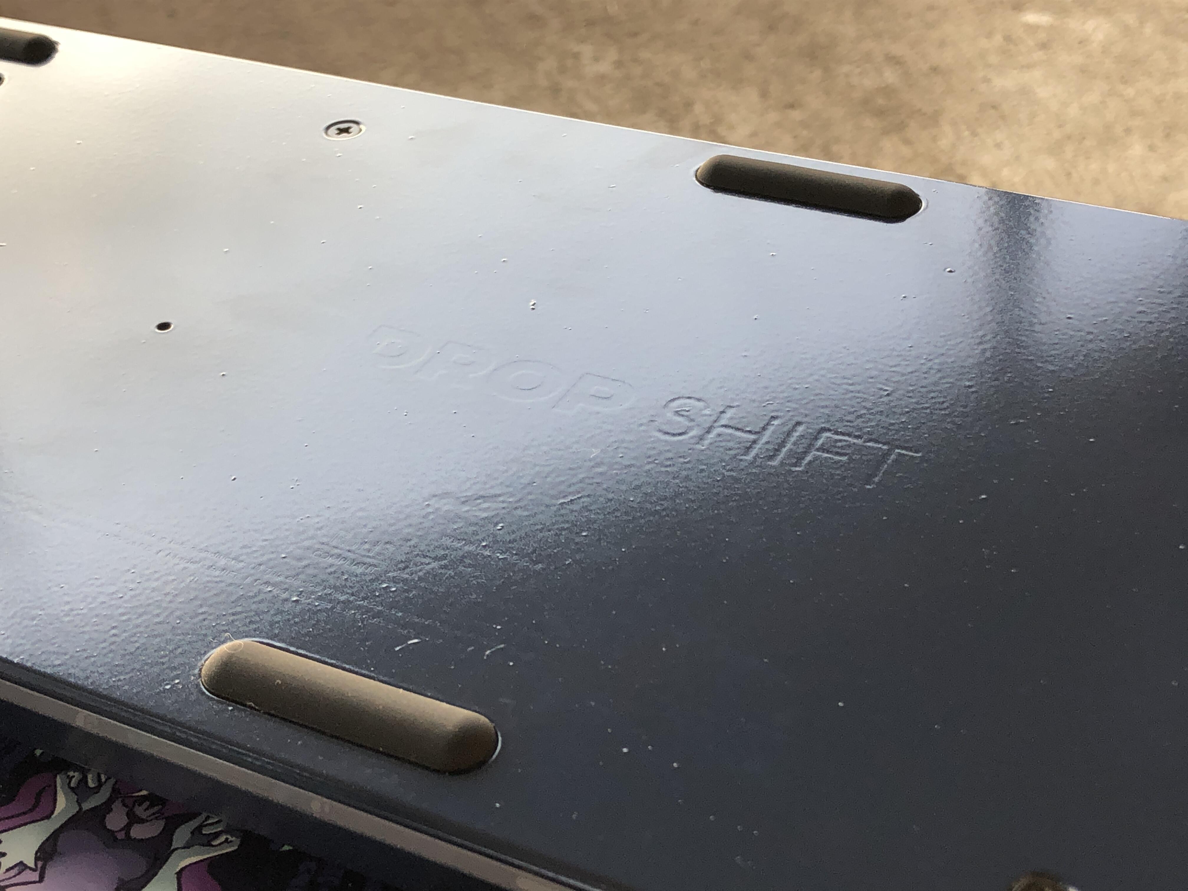

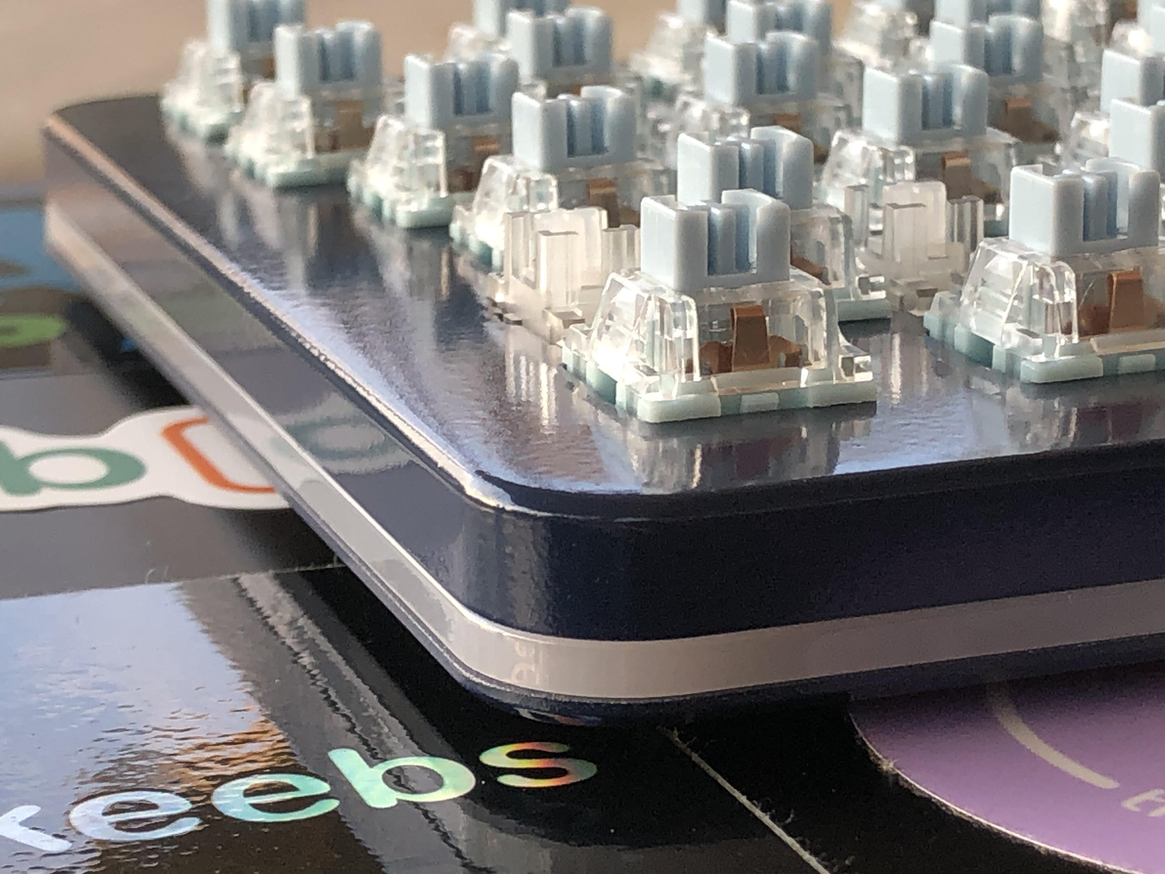

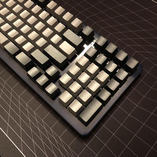

Still some finishing touches to apply, but the enamel finish for my dad’s keyboard (a modded Drop Shift V2) is done:
I like the dark blue he picked
He also picked some of my favorite switches, TTC Silent Bluish Whites
More
If you don’t look too close, I think it looks great

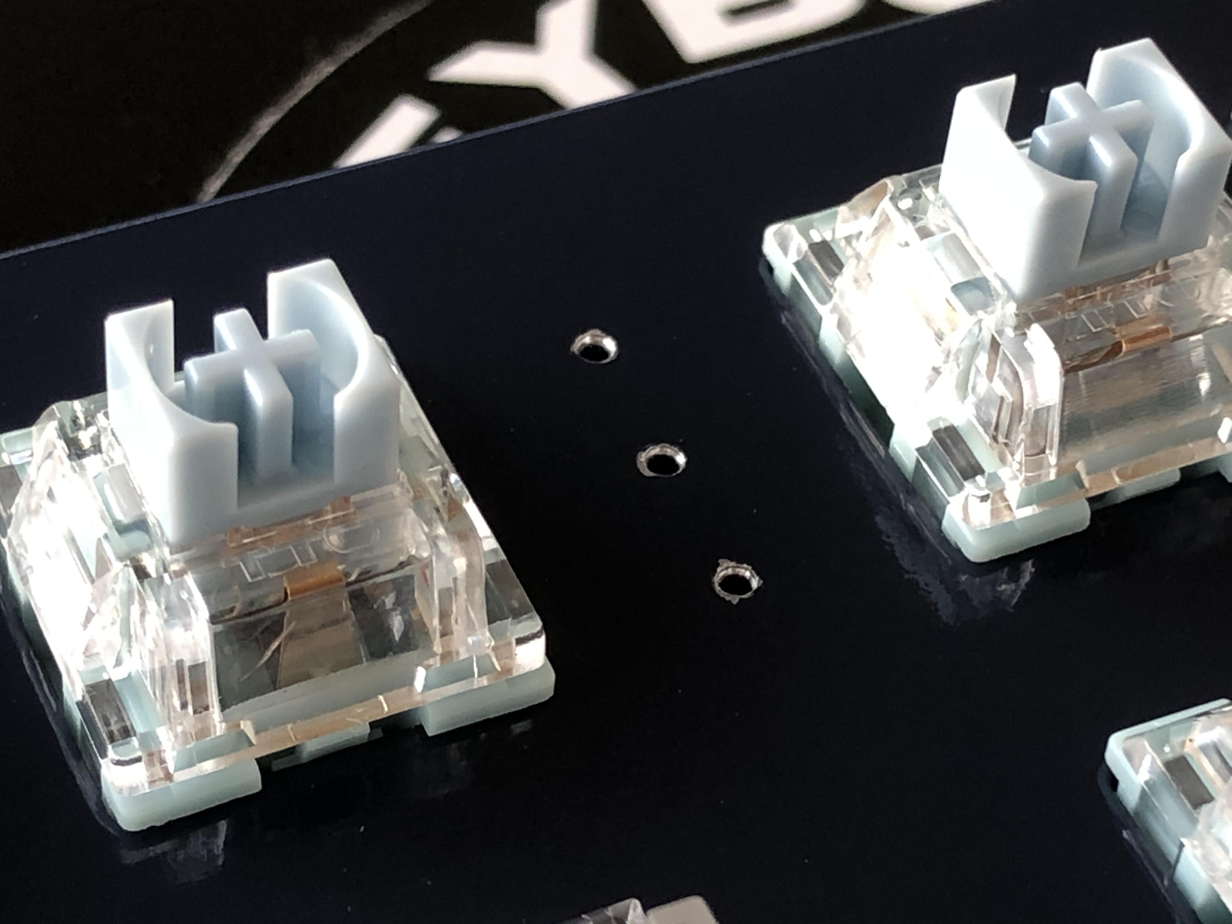

Leaning-in for details reveals why professionals use paint-booths, but my dad doesn’t mind
While I’m talking about the rough bits, I had toothpicks in these holes to make sure they didn’t fill, and removing them flaked the finish. I evened it out a little bit using a sharp tool but it’s still a little scraggly - I might find a different way to preserve small openings next time

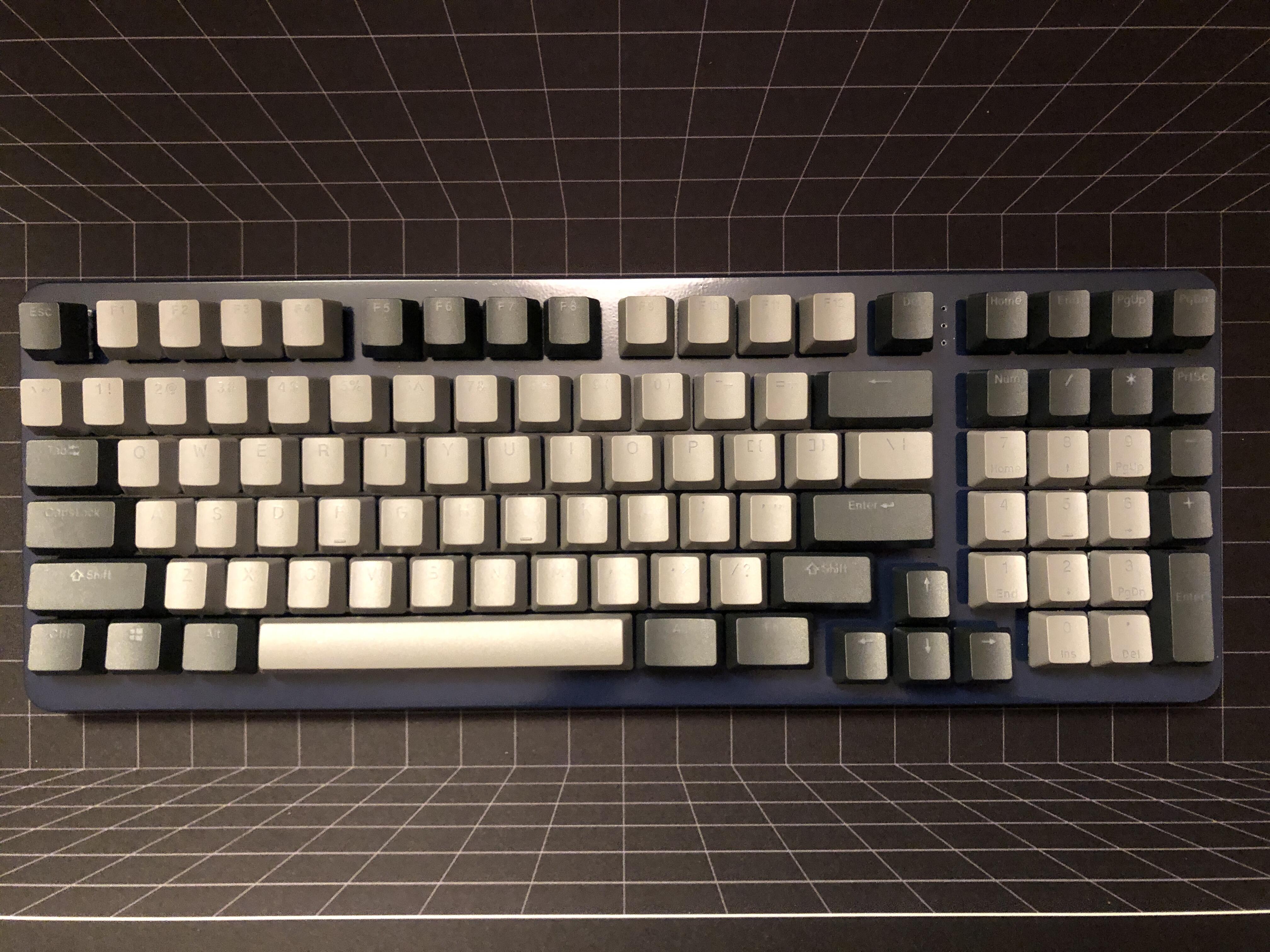

I think the stock grey caps go really well with the dark blue; almost a naval theme. These caps are much nicer than the ones that came with Massdrop V1 boards

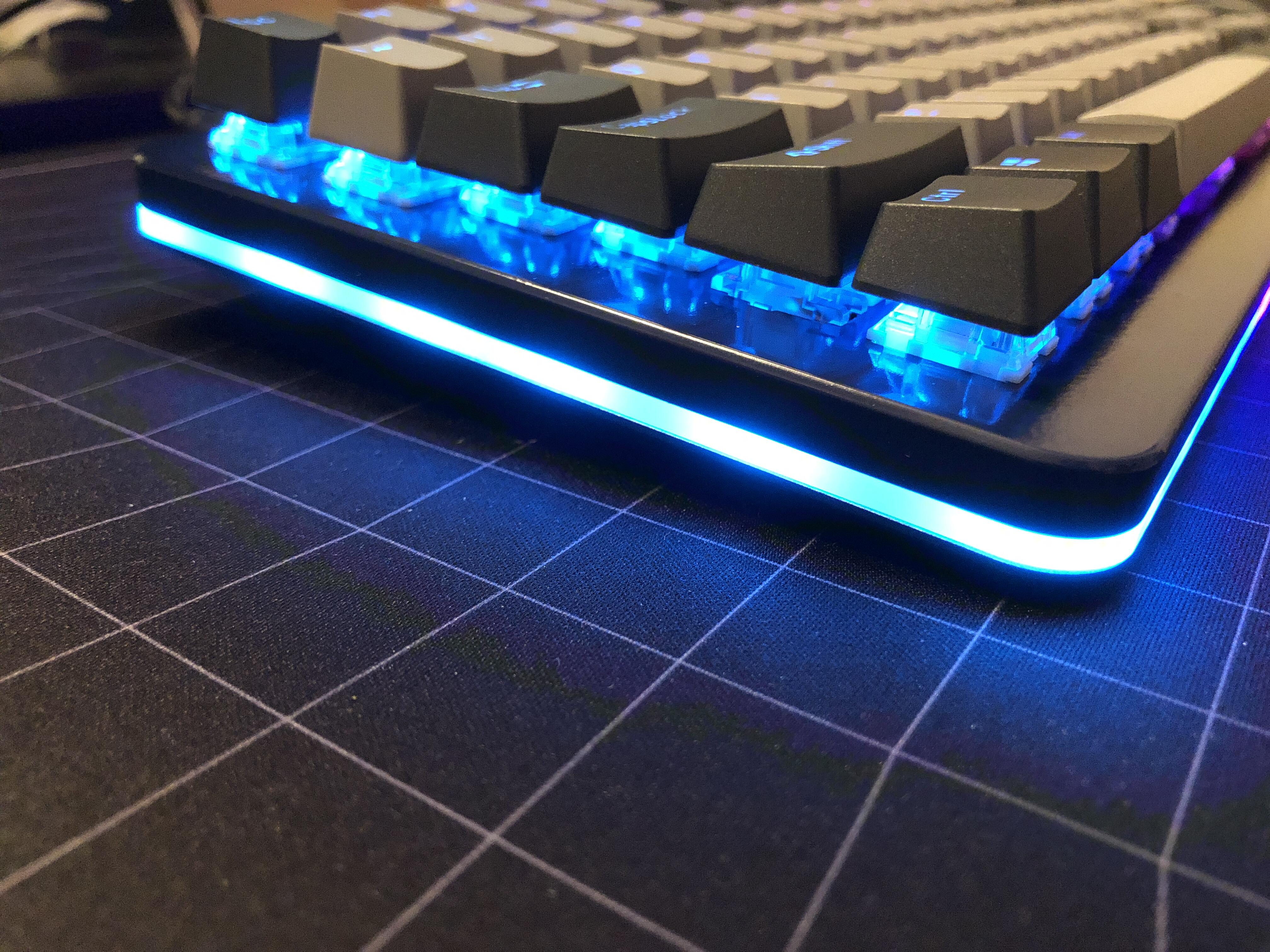

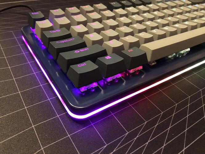

Indoor lighting
Shiny
I kind of like the mirror effect with the back lighting
Top-centered (North-facing) per-key RGB was a deciding feature for my dad in choosing this board
Another look at how the gloss and RGB do

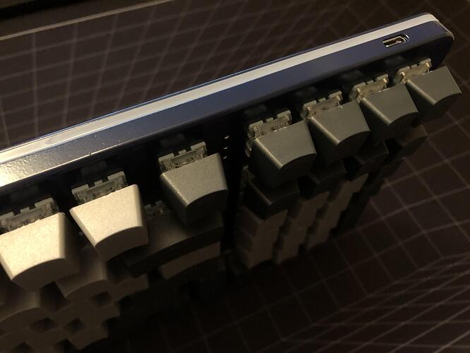

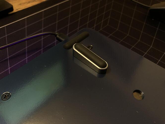

Angle with feet, which I left the stock anodized grey
Bad photo but there’s the feet; they match the caps and tie-into that navy-ish theme
Back edge with one of the two ports
Still to do: custom silver decals on the back with each of our monograms, stab tuning
The DupliColor seems comparable with the VHT; the finish is smooth and shiny, resistant to oils, but brittle to sharp impacts or scratches. I cured it at 300 degrees Fahrenheit this time based on a forum post instead of the 200 recommended for the VHT

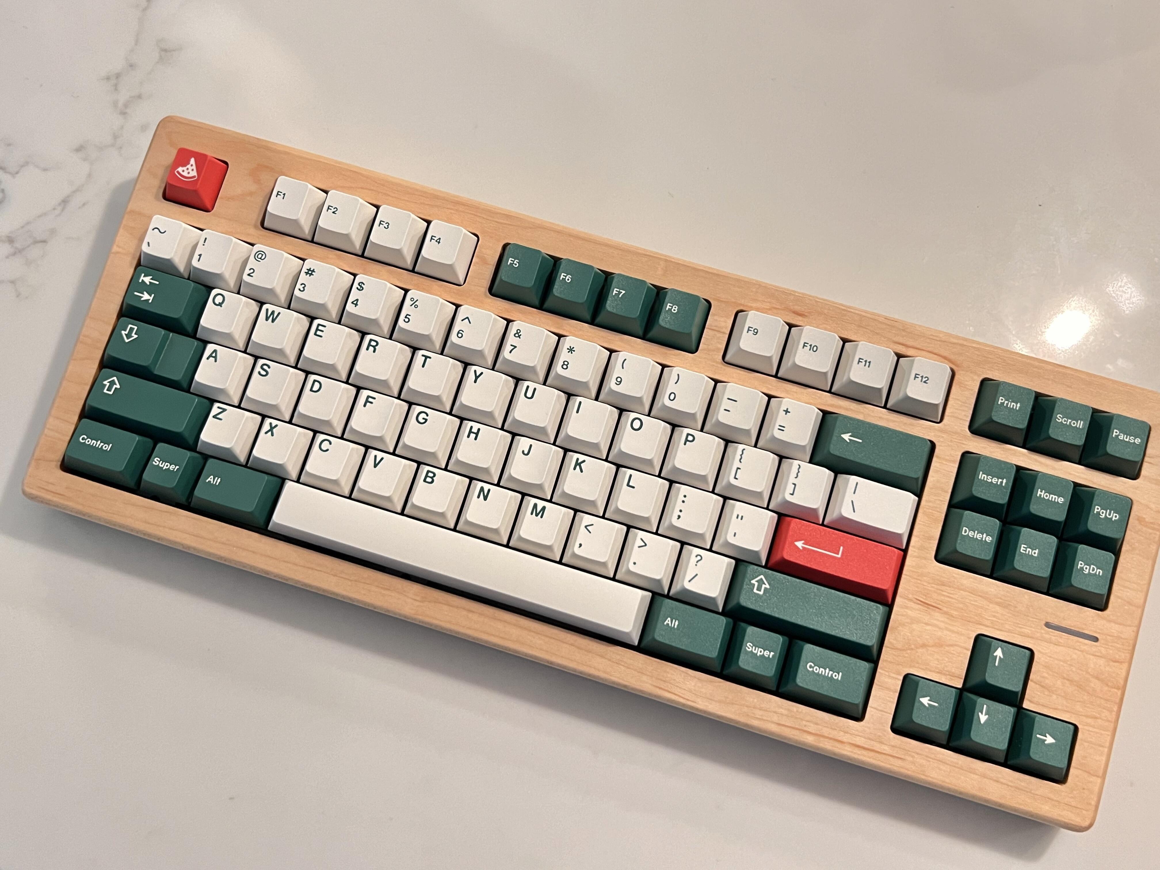

Built my tree80 with NK Dream switches today.
Very fun board that sounds and feels perfect. A few small things I have to fuss with, but definitely worth the price.

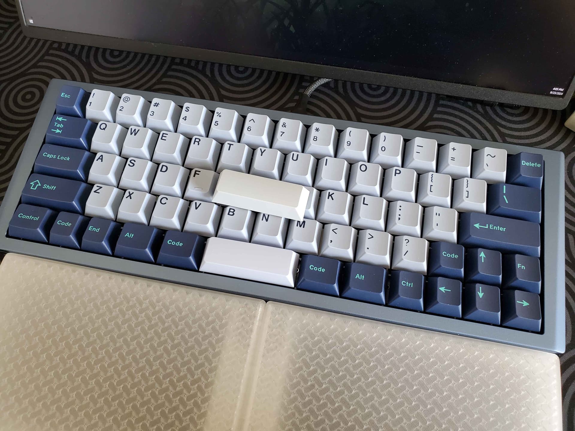

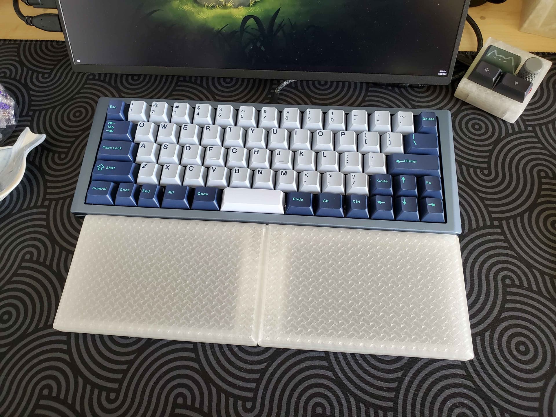

Cojiro spacebar, Pacific on top.
Cojiro
Pacific
Turns out they’re both similar but lighter. Pacific is more a blueish grey, Cojiro is more icey blue. Cojiro has a twinge of lavender, but in direct light looks blue (maybe too blue). Pacific looks more muted but may be too gray. I have Indigo on the way, but hopes aren’t high lol
Ya’ll think Cojiro or Pacific?
Would stick to the Kabuchi spacebar actually. Imho both of them stand out even more (and too much)
You’re not wrong. It might be the (terrible) pictures in that post but in person I think I’m leaning Cojiro. With sunlight it’s almost close to the hammerhead light blue.
Trying to go for a light blue look.
Damn I wish there was a alpha colored spacebar for this set.

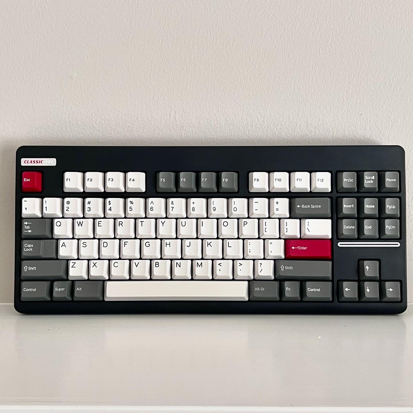

Today I built my classic TKL from Novelkeys. Hey @mgsickler you made a nice thing!

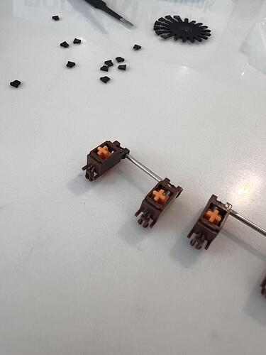

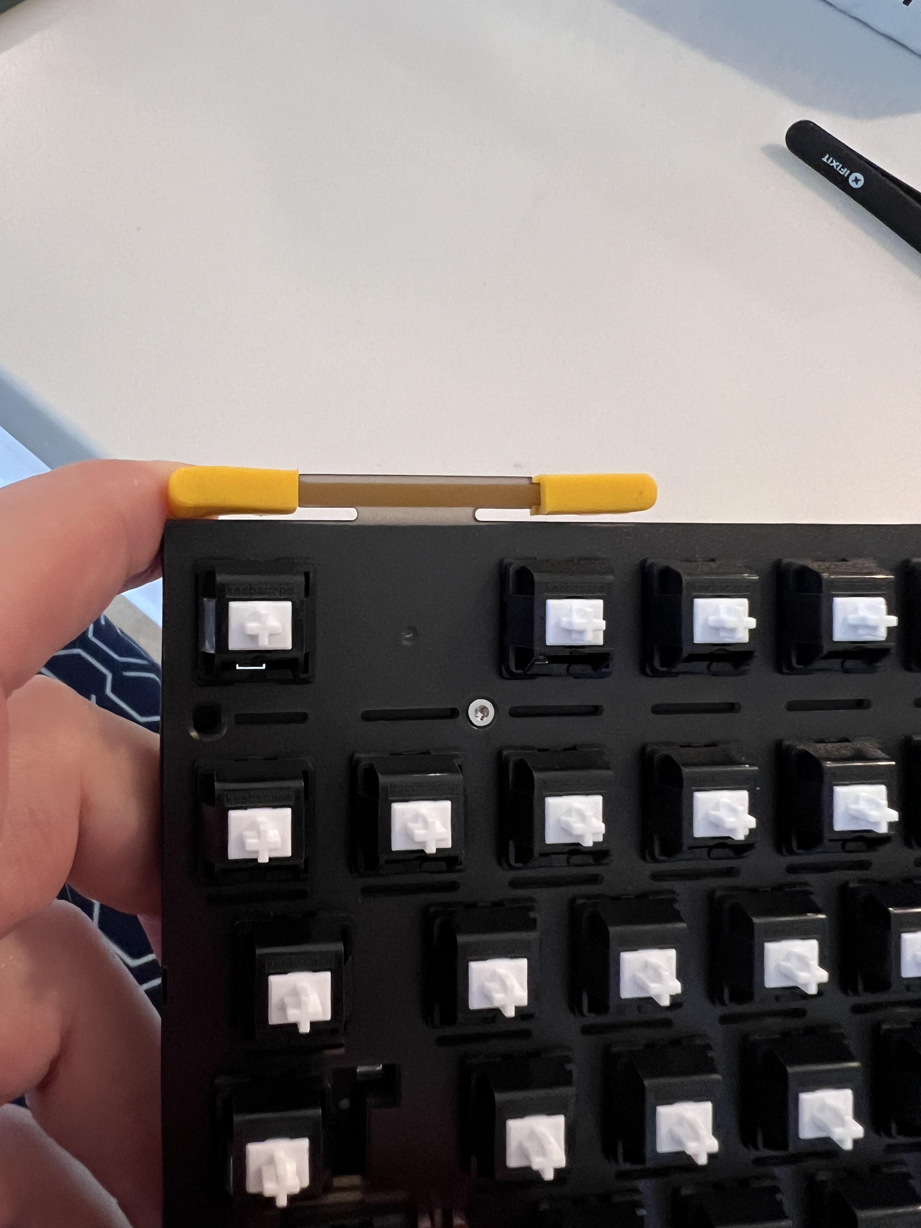

I used the WS Stupid stabilizers for this one. Mike had cautioned that this first plate was tight on stabilizers and these appeared quite slim. It was a good fit:
Notes on the stabilizers:
  • Overall, on this board they are on par with TX stabilizers. Maybe even better. The added rubber material on the wire clip in and the stem hole make them easier and almost foolproof to tune. I used my regular 205g0 on the stems and Nyogel on the wires.
  • The way the wire goes in from the bottom is a nice quality of life improvement. It’s very easy to install the wires without accidentally missing a hole and losing lubrication. :face_with_hand_over_mouth:
  • There’s no way in hell I could get the shims into the clip in backs of the stabilizers. I’m not sure if it would differ on other PCBs. So they’re in there without the shims. I pulled hard and they didn’t budge.
  • They feel cheap. Everything feels a bit thin and cheap. But it didn’t seem to affect the results.
Small review on the Classic-TKL
The keyboard is very nice and well worth the price. Super easy to build.
Things I like:
  • The plastic is firm and the texture is pleasing. It looks premium
  • Everything comes assembled so you get the keyboard in a box without 20 extra baggies of parts. There is one baggie with extras.
  • The plate is precise. Switches clip in perfectly and easily.
  • These gaskets.
(Let’s just have everyone using these now. It’s so much easier and faster than having to put adhesive backed gaskets on.)
  • These plate screws
  • Finally. Plate screws that aren’t shitty 2mm dinky pieces that always work loose.
  • Case tolerances. All edges line up beautifully. And the space around the keycaps is perfectly uniform all over without any effort.
Only 2 issues:
One very minor issue is that the box is lovely and vintage looking but almost impossible to open without damaging. It’s glued down on the main flap like a USPS priority box. I managed to almost get it cleanly open by going very slowly with heat and a pry tool.
I figured it out! There is an option! See below update

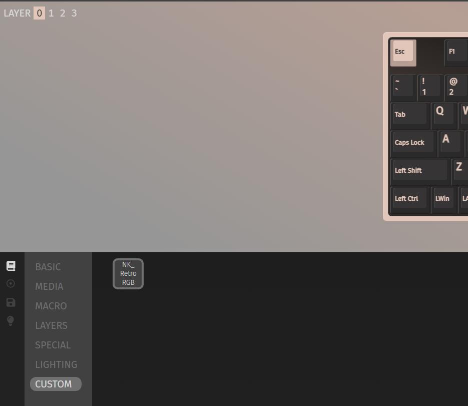

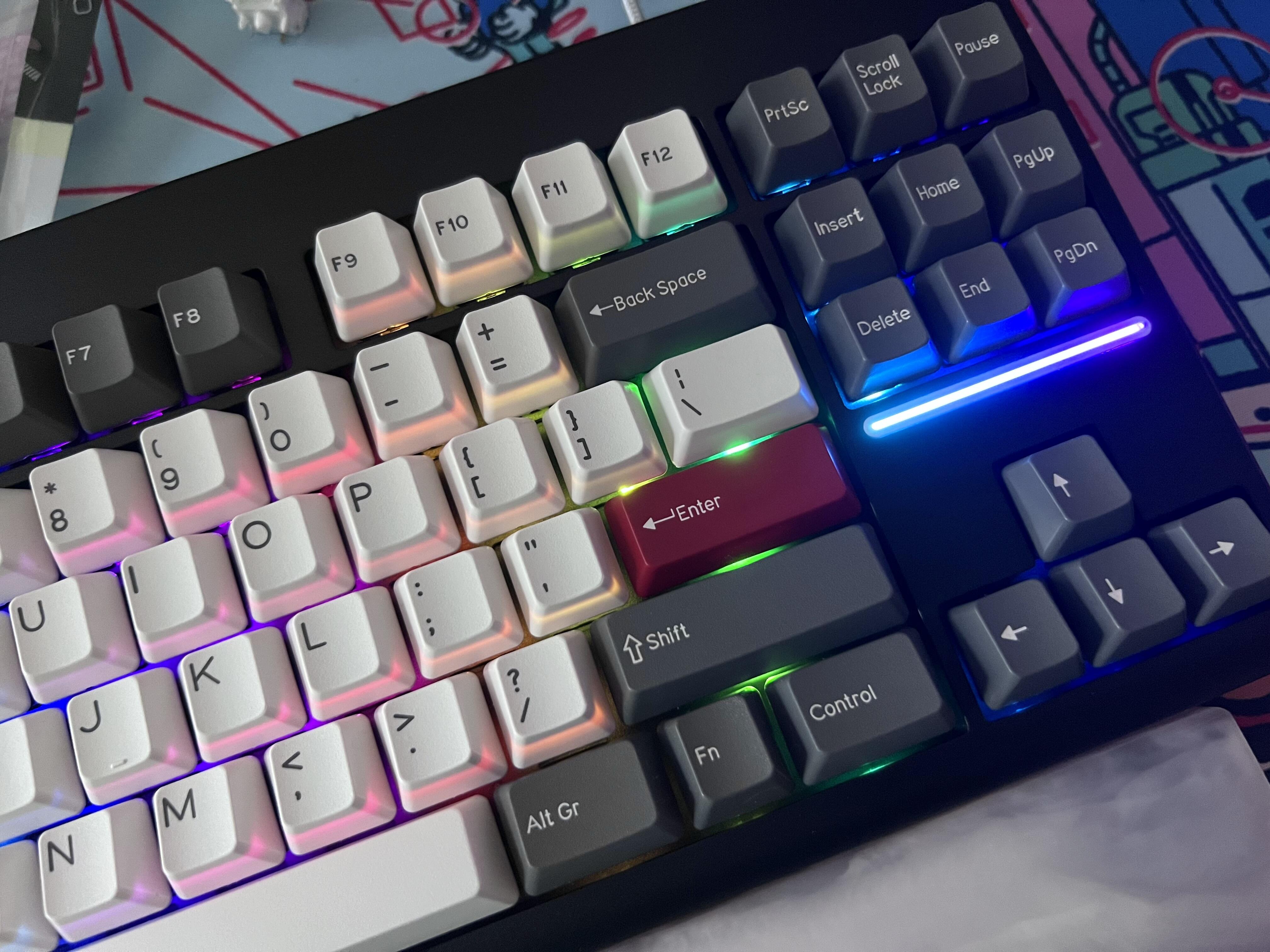

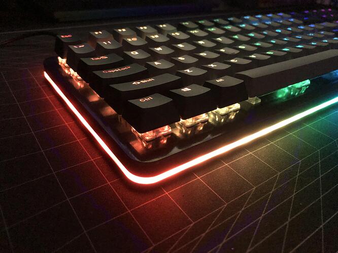

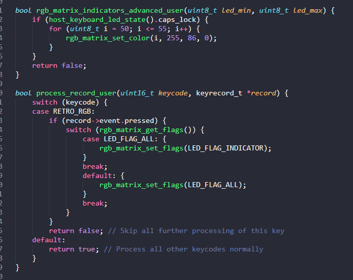

Small update on the Classic-TKL.
One bummer for me was that the RGB per key backlight shared the same options as the led accent above the arrow keys.
I was typing today an realized that the LED accent was, indeed, individually addressable. I noticed that it turned yellow with caps lock on. Even with the backlighting still doing it’s own thing.
I thought… hmm, let’s look at the qmk code
Yep, rgb_matrix_indicatiors_advanced_user
but wait! What’s this “retro_rgb” mentioned later???
I thought I remembered seeing it earlier in VIA:
It’s a keycode! This turns off the per key RGB and only uses the accent section. It’s perfect! Now I can have a sweet led animation on that accent instead of the entire keyboard.
:partying_face:
Board looks great! We love using just the lightbar on these (default is just right function + spacebar) to toggle that on/off.
