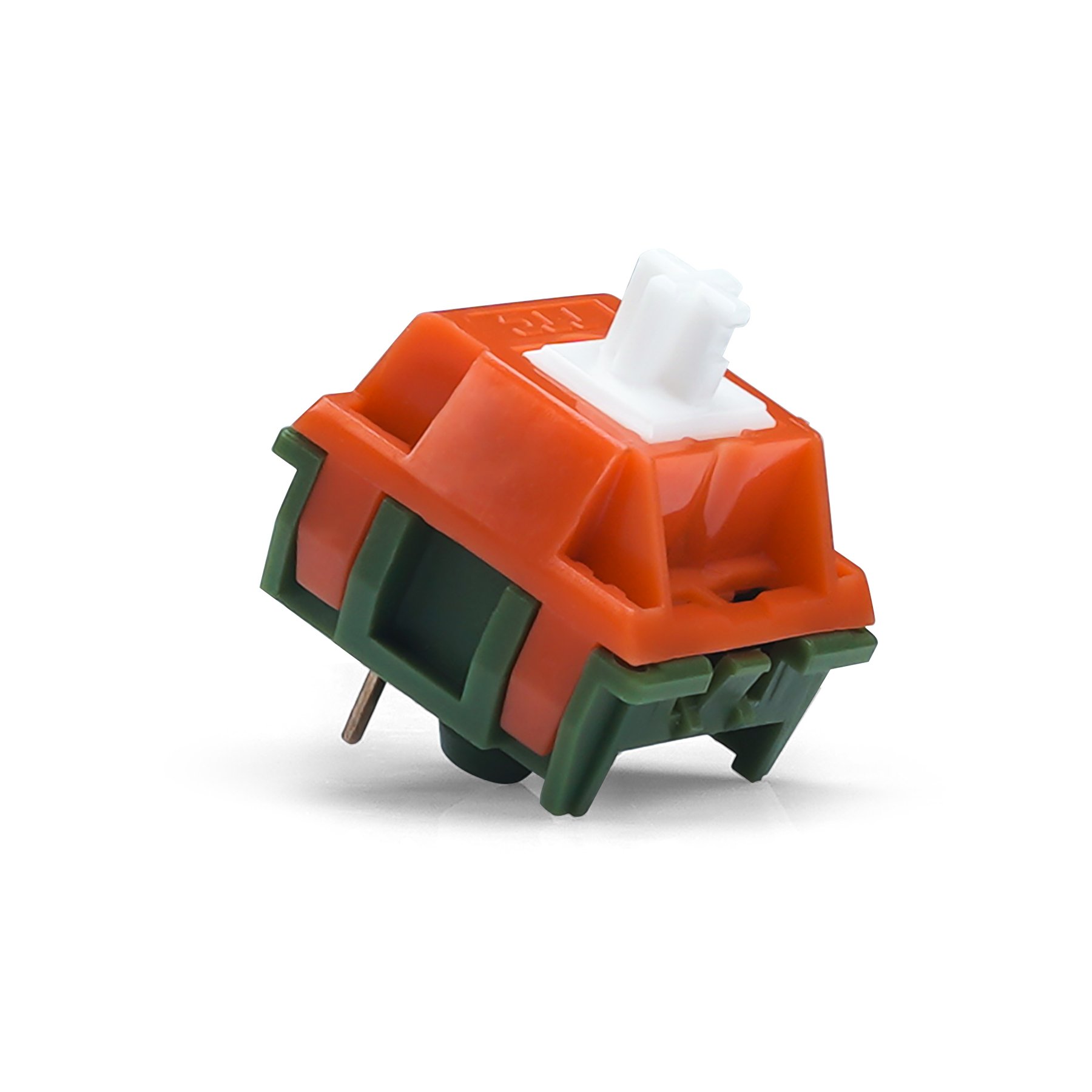

TTC Watermelon Milkshake Switches
Keyfirst branded - the same folks behind the Gateron Cream switches, this time having TTC do the production.
They don’t seem particularly interesting or exciting, but they certainly do have an unusual colorway. From the short description, these sound like mild, traditional mx-compatible tactiles that come factory lubed. I’m not sure if “large tactile ahead” means a strong bump, a long bump, or something else - gotta love marketing filtered through the language barrier.
I was a little underwhelmed by TTC’s browns, but that’s more my fault for expecting mole out of milk-chocolate - and for that, they’re fine. These don’t sound like they’d too different to me from the description, but the non polycarb(?) top housing might improve the already decent sound a bit, at the sacrifice of SMD friendliness.

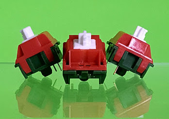

Here they are!
20210206_114627
They have mild slight sharp tactility that is somewhere between MX Brown and MX Clear. Smooth travel, with oil lubing on tactile legs and stem pole. A bit of wobble. Sound is slightly muted.

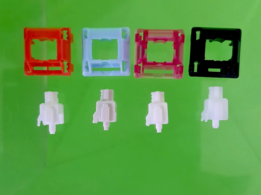

Here’s a comparison to other switches marketed as MX Clear clones.
From left: Watermelon Milkshake, Penguin, Dragonfruit and MX Clear.
That stem bump reminds me of Aliaz switches. Or browns I guess. Funny, because if I remember right, Aliaz was less tactile than Browns. Maybe these watermelons :watermelon: have a leaf that increases the feel. :man_shrugging:
