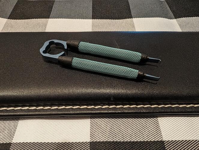

This is a fantastic switch puller. Used my old Techflex trick to make it a little bit more awesome. As a bonus no longer sounds like a tunning fork when I drop it :wink:
(Mod: 2 layers of techflex, black heatshrink, then a final layer of techflex and heatshrink on the tips to keep it together, makes the handles about 8mm thick and very grippy / squishy about 8.5mm thick vs 4mm stock)

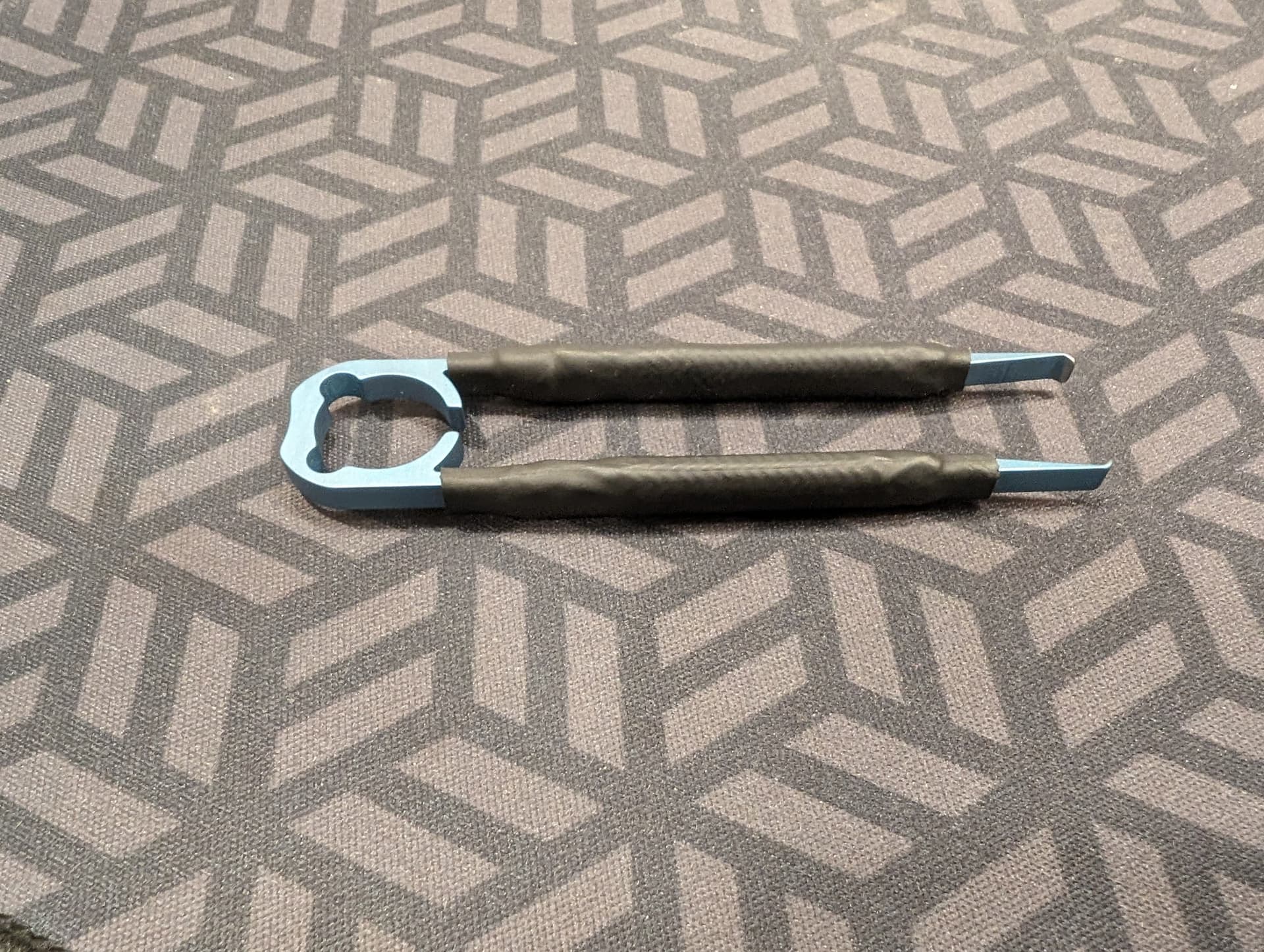

In progress
2 layers of Techflex with a layer of heat shrink over it.

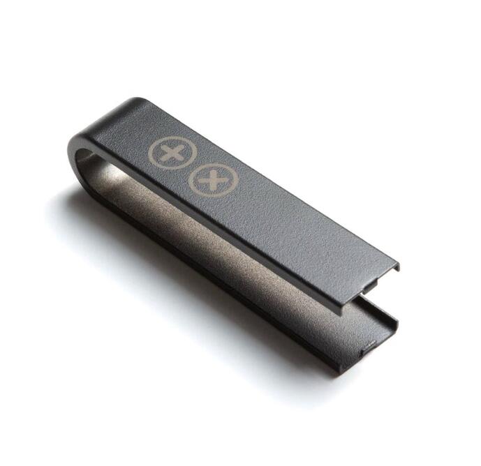

I’ve been super pleased with this TX Switch Puller. It addresses my biggest complaints about the metal being too thin and bending where it engages with the switch.
Image stolen from the Divinikey website.
I think as long as they aren’t made of aluminum they’ll work well. Definitely steel or titanium is the way to go

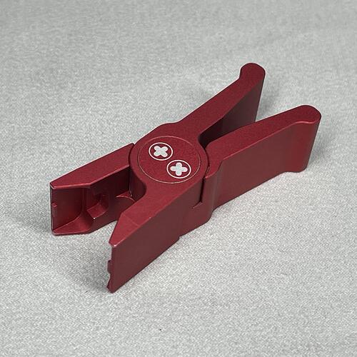

These are the last switch pullers I ever see myself buying.

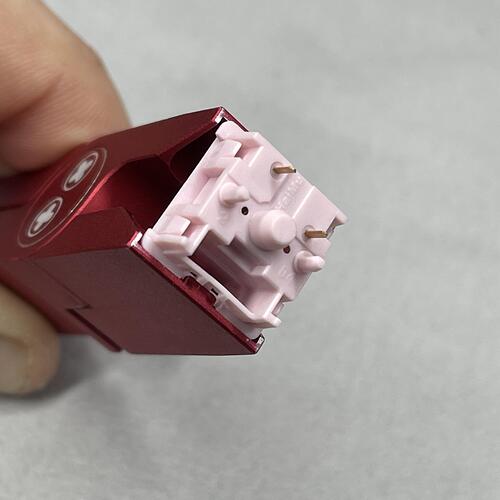

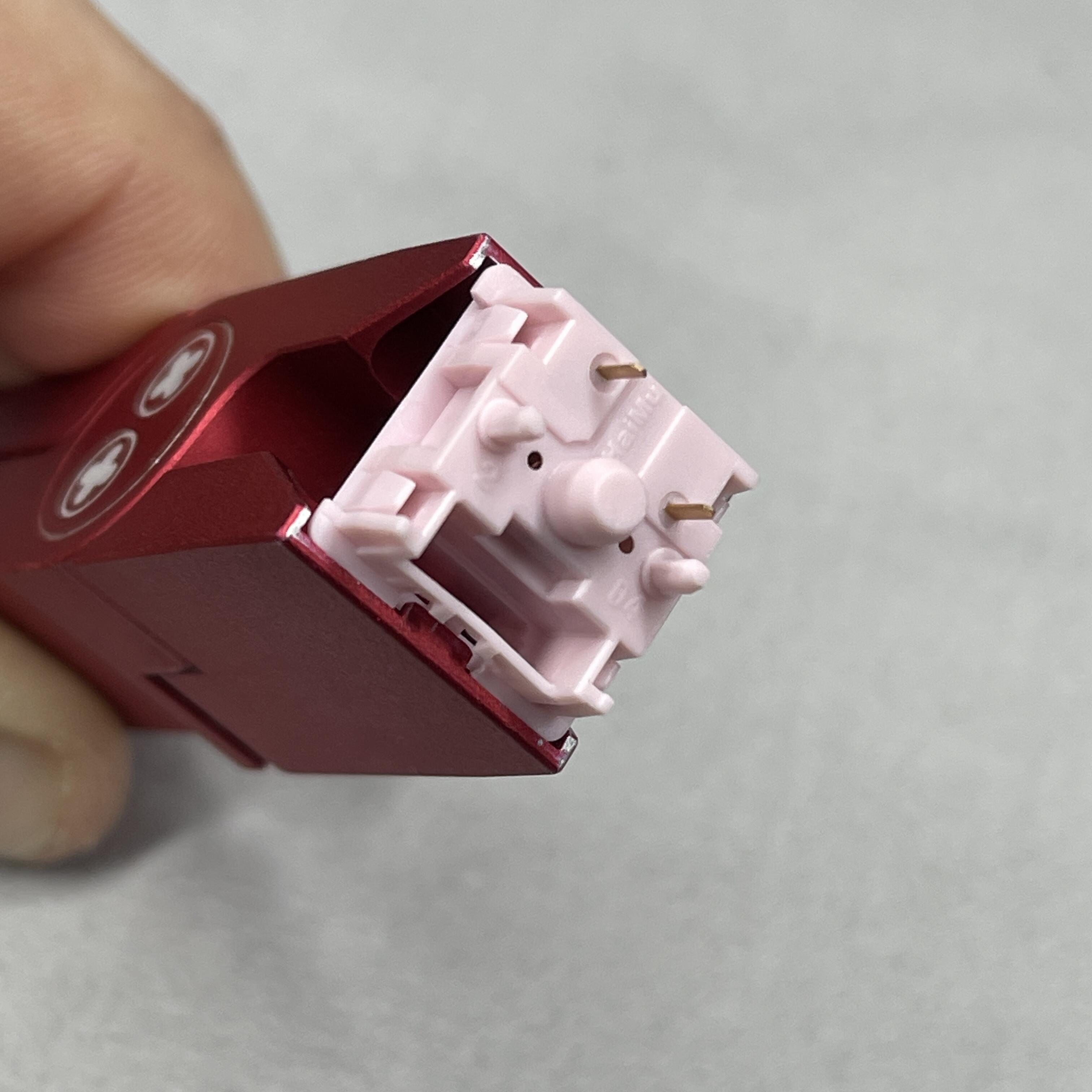

chonky boi :heart_eyes:
Now THIS kind of aluminum design would work
