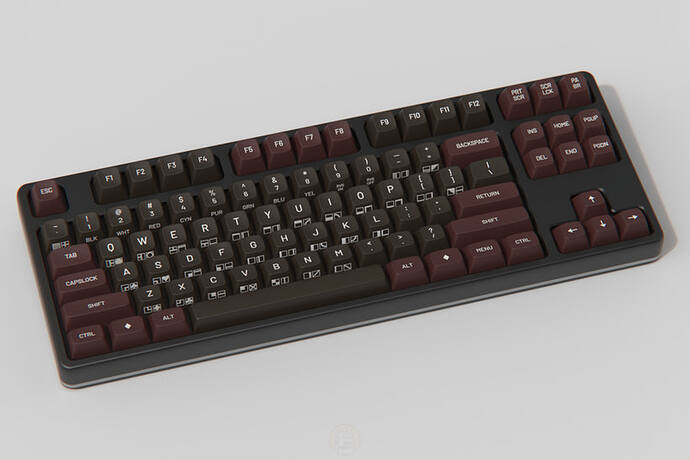

As an example I love typing on my MT3 PBT Serika keyset and it is significantly textured, at least much more than for a GMK set for example.
