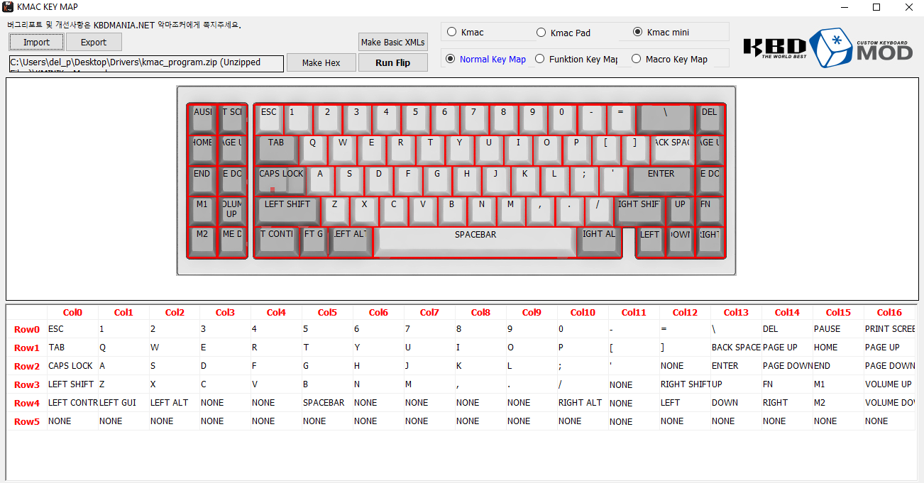

I hope the following will help. This is what the program looks like that I use to make the hex file.
So I don’t input any codes at all like you do in QMK unfortunately. I select the layout I want, press make hex and use that hexfile to flash the keyboard using QMK Toolbox.
To reset the keyboard I have to hold caps while plugging the keyboard in. Where should I look to help you find out what firmware etc the keyboard has?

As for macros … the easiest/only way to do that is likely going to be to reverse engineer the physical matrix and port this to QMK/TMK/etc.
It looks like the KMAC is actually in QMK. And if both models are using similar boards, then the Kmac Mini is using an atmega32u4, and can be ported.
But porting isn’t exactly simple or straight forward.
Yeah, I figured porting to QMK would be the best option. I have somebody nearby that might be able to help me with that luckily so I’ll see how that goes. Still hope that isn’t needed though, just to make it easier for me
