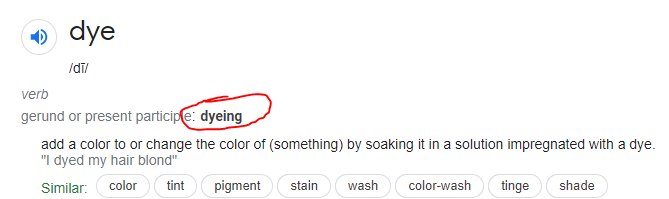

lol. i was really confused b/c i thought your polycarbonate board was “dying”
Gotta love the English language.
Yeah I was thrown off until I read it. I had to double check myself
RIP Me.
no, RIP the polycarbonate board :stuck_out_tongue: :stuck_out_tongue:

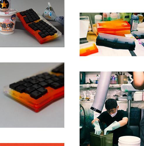

Tokyokeyboard.com has some shots of their dyed keyboard. I just can’t imagine working with that much acetone though. You can see in the picture of the dude doing the dipping, there’s a big ventilation setup above it.
I swear I’ve posted this before for some reason. My brain is a cluttered mess though.
