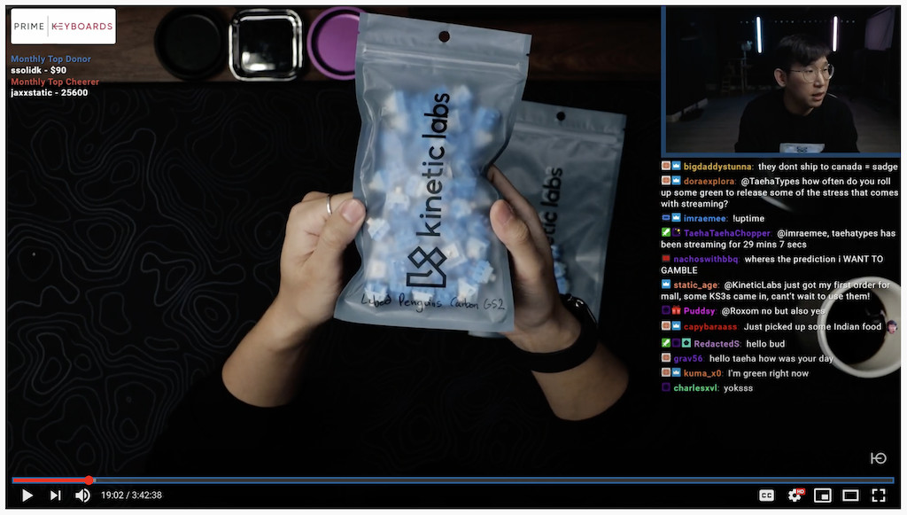

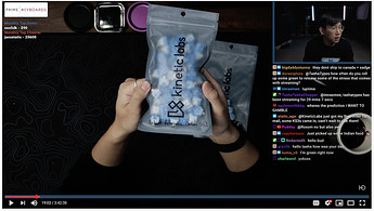

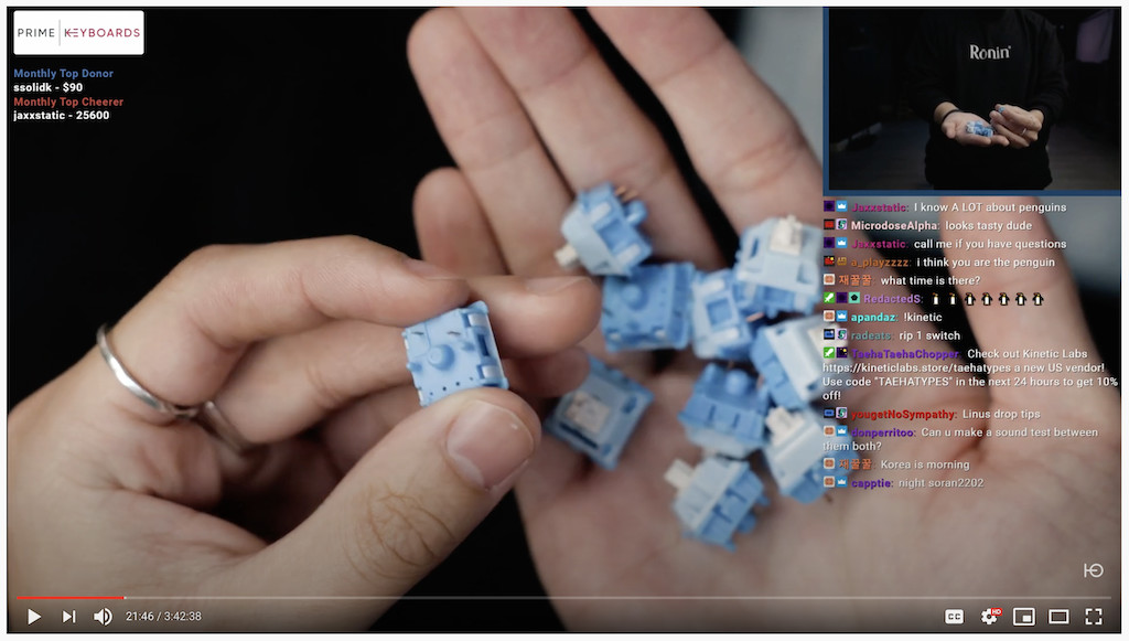

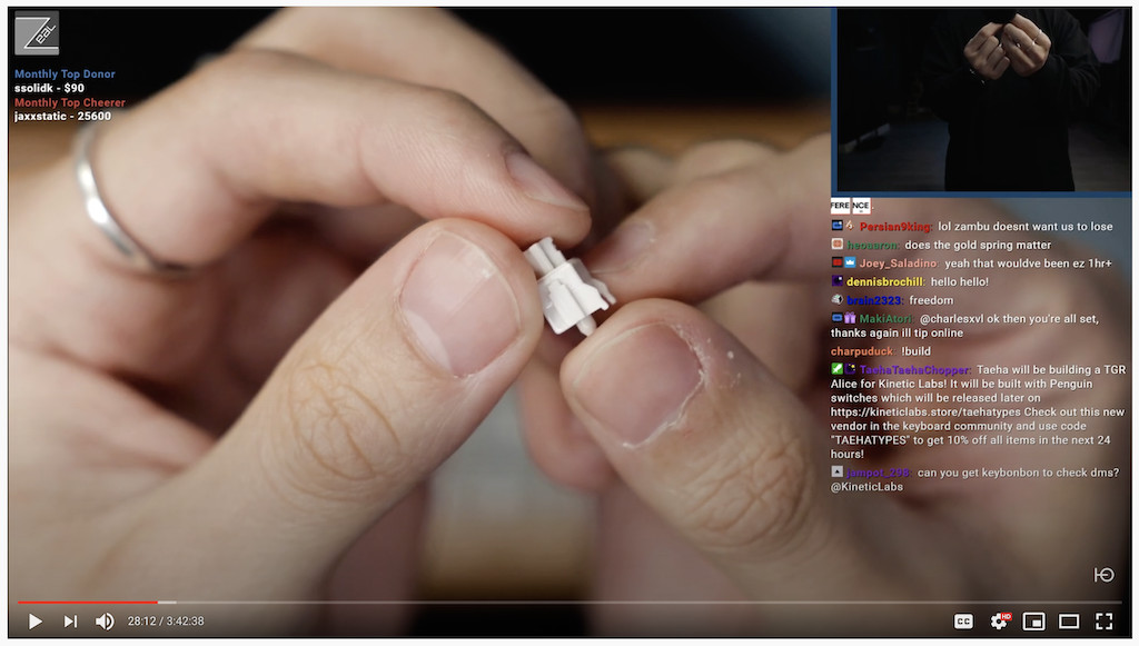

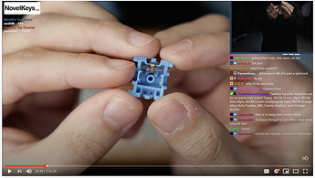

I caught a portion of the TKC Twitch stream about these, which I think might still be viewable - anyway they mentioned on there that while the bump is less big / round / heavy than the Kiwis, it’s still intended to be up-top on the key-travel.
Edit - here’s a YouTube archive of it: - YouTube
