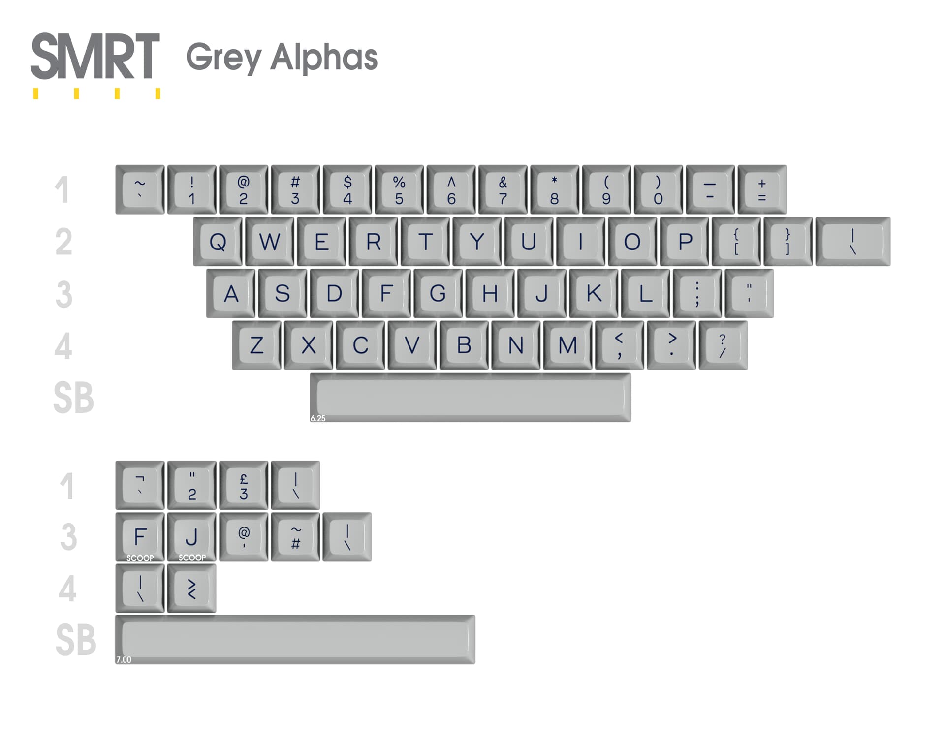

This is a project I’ve been working on for a while now, SA SMRT. It’s a tribute to, and updating of, classic Wyse terminal keyboards of the early 90’s. Designed to be mix-and-match, you can rock the traditional navy-on-grey colorway, or go bold with navy blue ASCII alphas, and a yellow monolegend alert-style number row.
I’ve seen Wyse reproduced in DCS and Cherry profiles, but never in SA, and never with this degree of layout coverage, or with alternate alphas and accents offered.
SMRT is my second design; my first SA set is currently in production for an in-stock sale later this year. So I do have some design experience, though this is definitely more elaborate than my previous effort.
The colors are stock SP resins matched to the Wyse colorway (GSX light grey, GTD dark grey, BBI navy blue, and YY yellow). I believe all the legends used are extant molds, with no new ones required. Mod legends are drawn from various Wyse boards from their heyday; it’s not based on any one Wyse board.

UK ISO is baked-into the alphas and mods. This is probably the one thing I’m unwilling to change, because I use it on most of my boards, and I don’t want to go the route of a hyper-expensive international kit, or a UK minikit that’s either sold out too soon, or left orphaned.

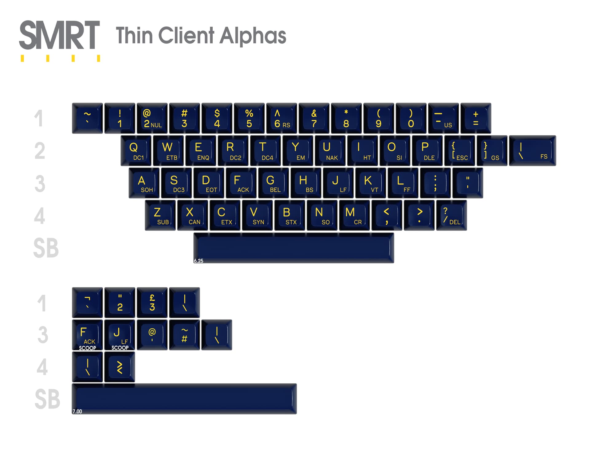

Grey alphas, and “Thin Client” ASCII navy alphas

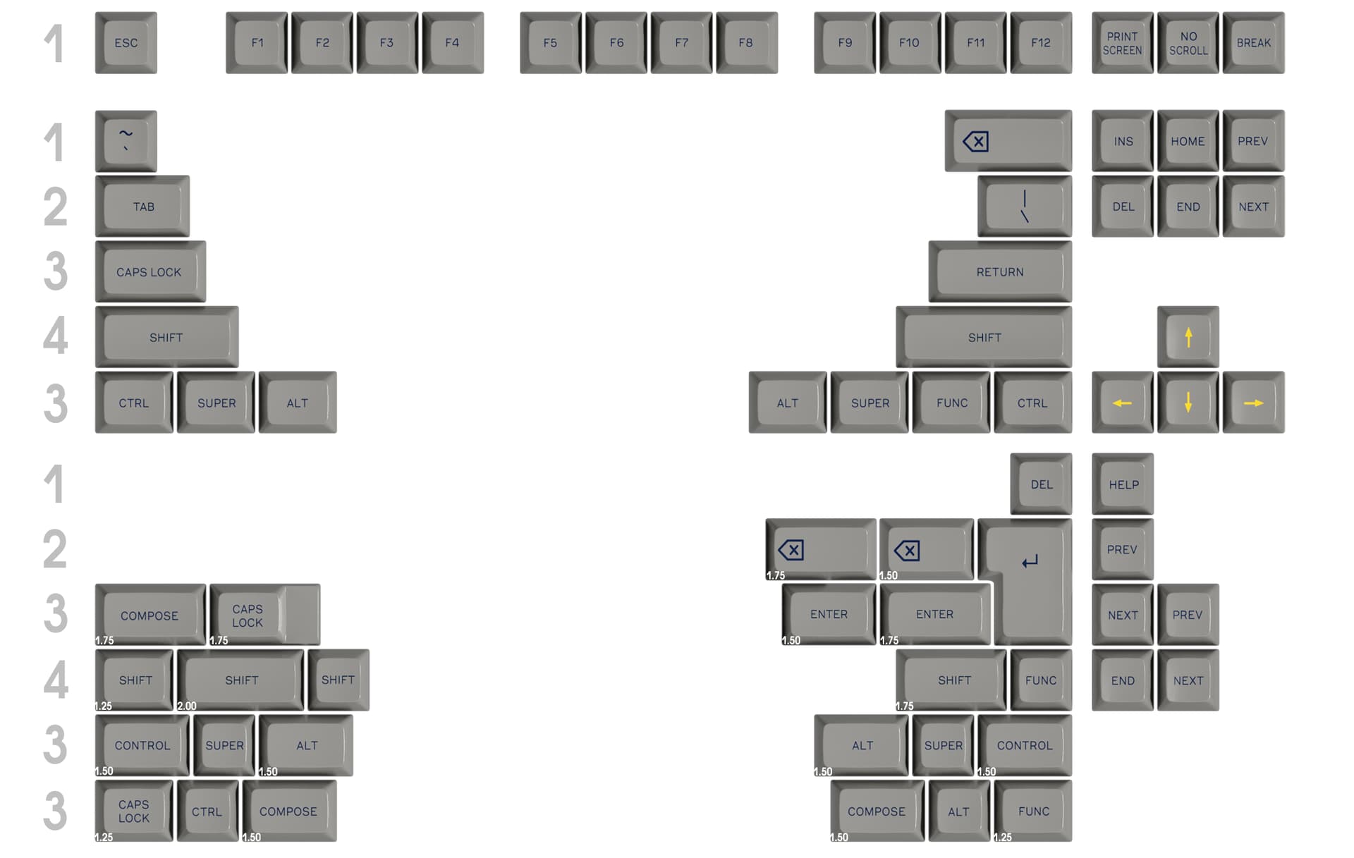

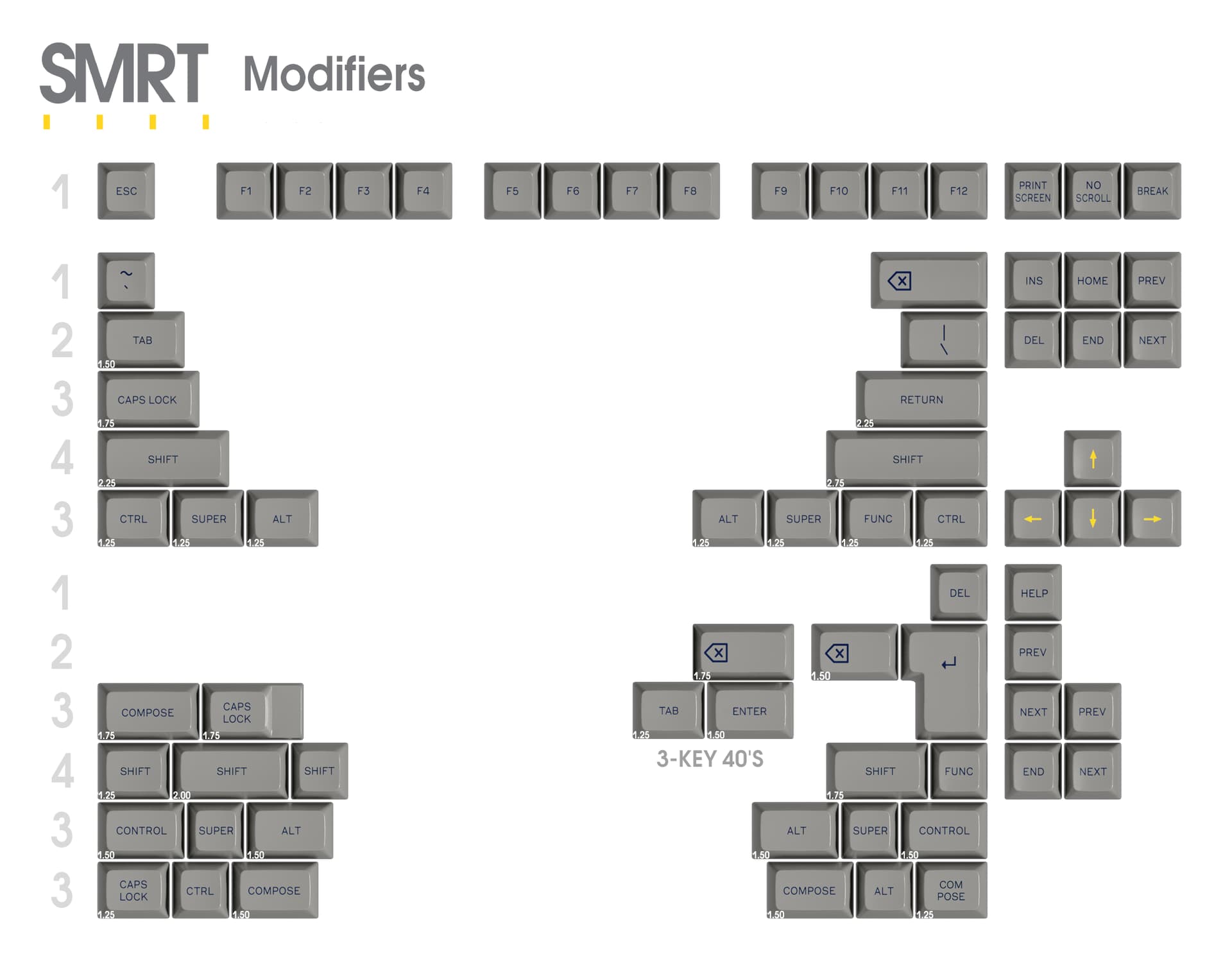

Modifiers

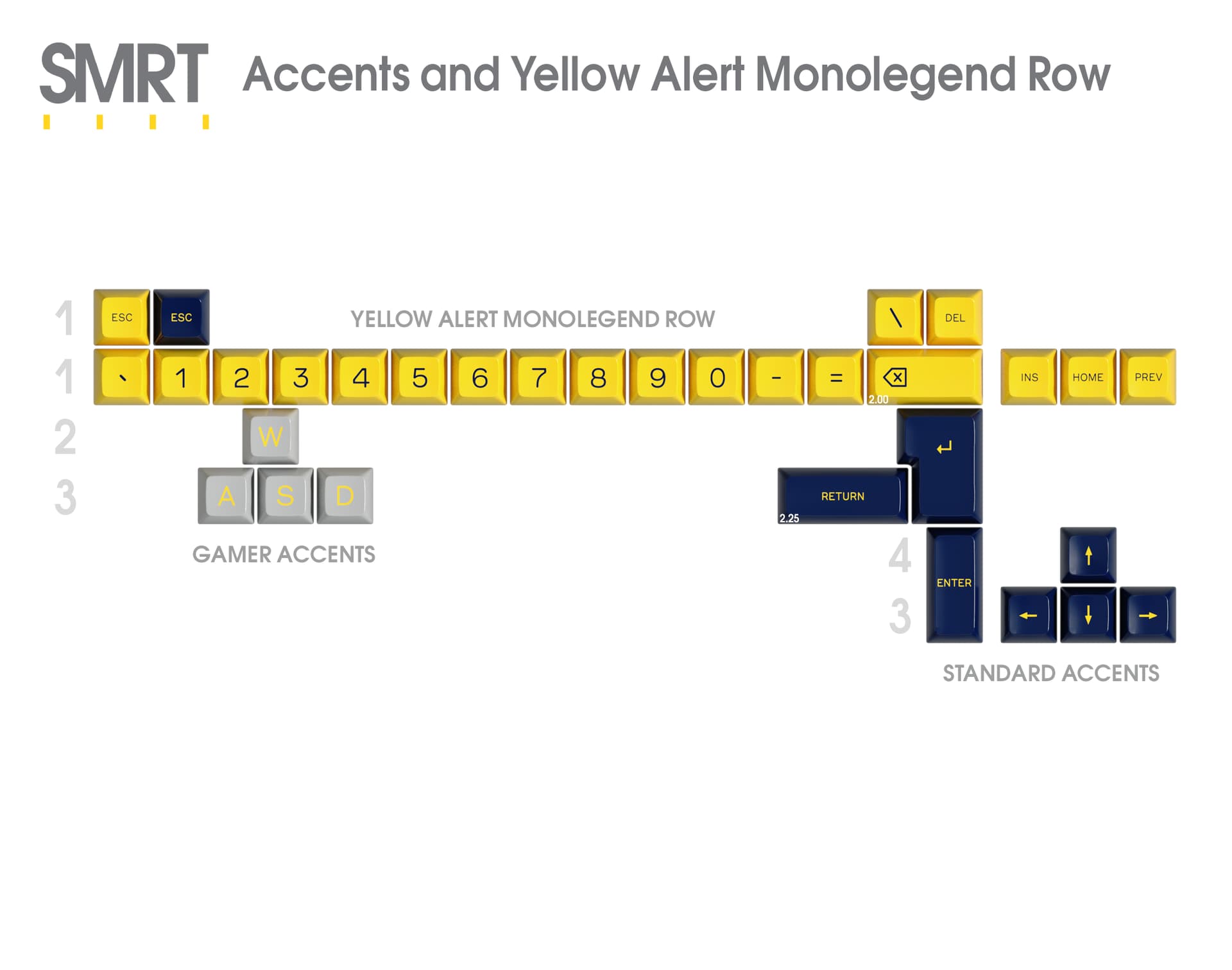

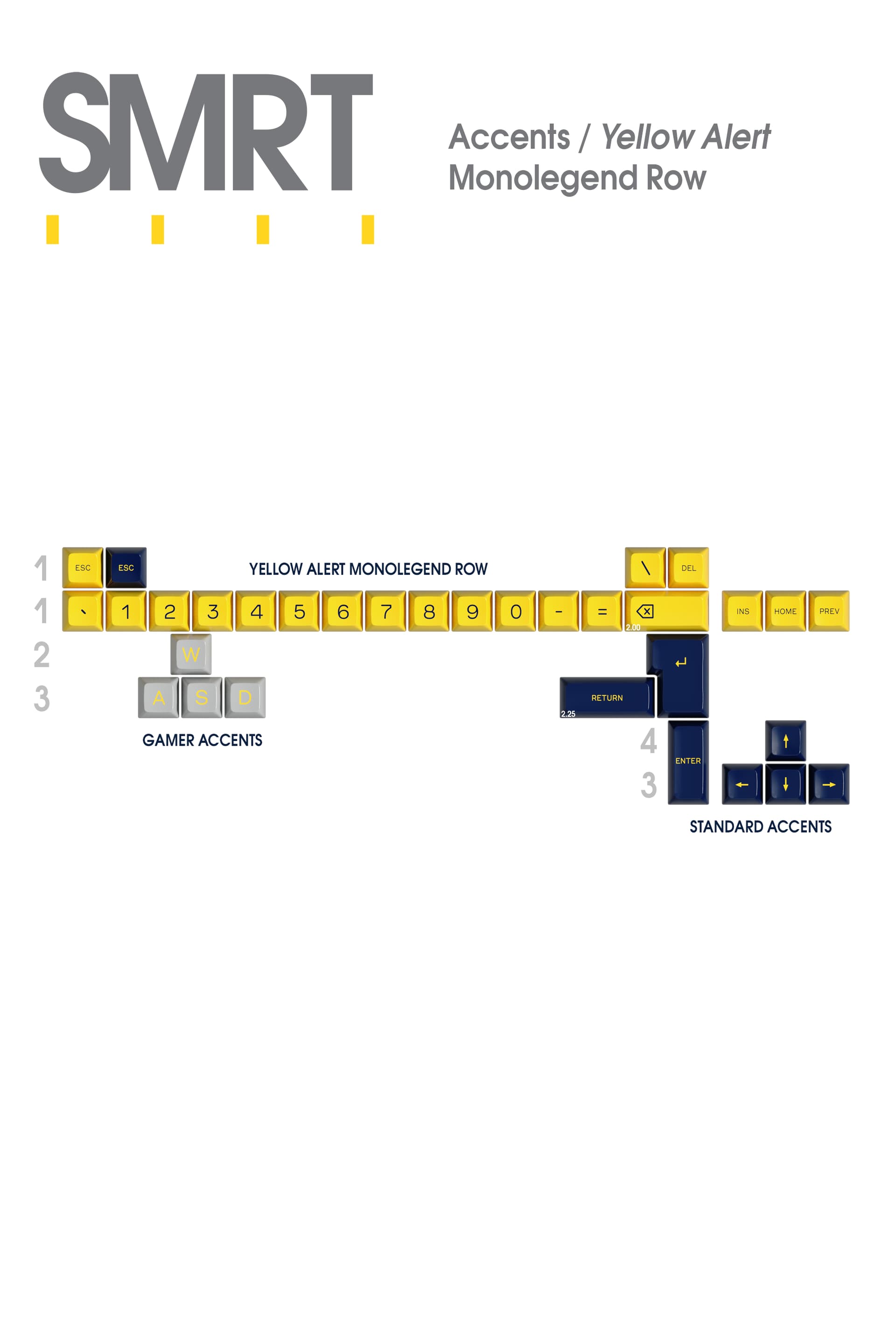

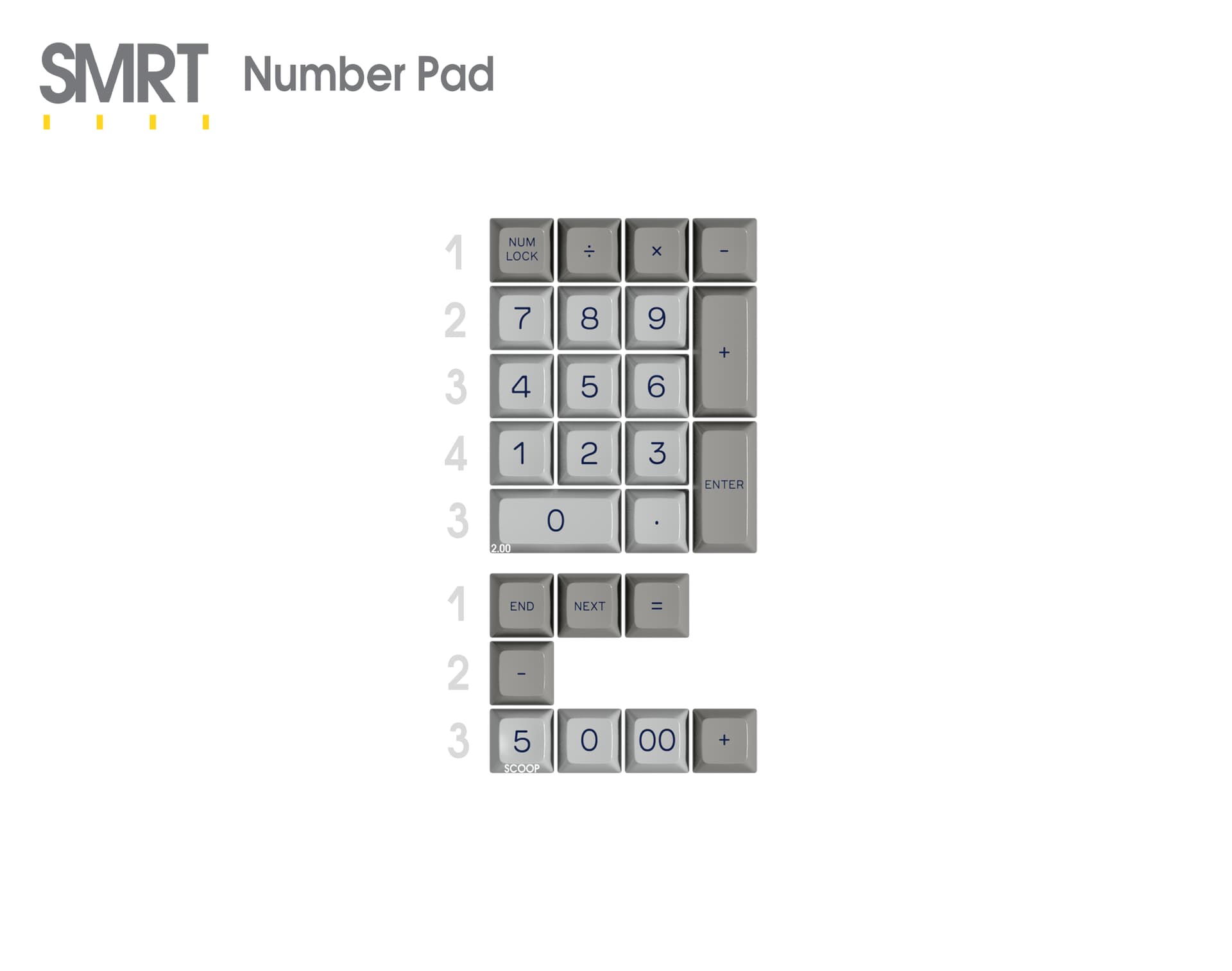

Accents/“Yellow Alert” Monolegends, and Number Pad

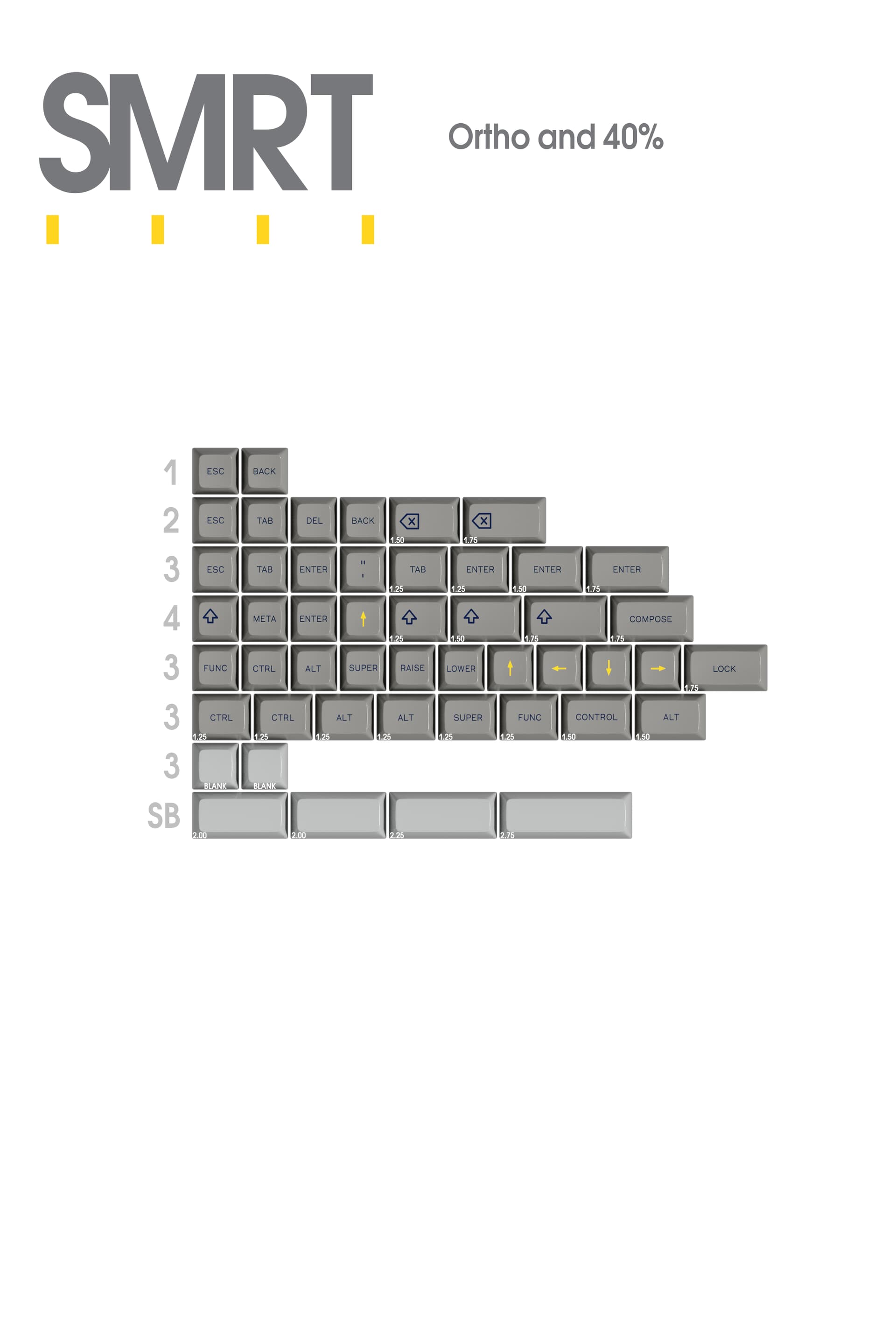

6/20/24: Created alternate Modifiers kit with 3-key 40s support, if 40s kit needs to be dropped
6/20/24: Replaced duplicate 1.25 R3 Func modifier with a 1.25 R3 Compose modifier
6/23/24: Fixed incorrectly labeled 1.5u R2 Backspace mod (was labeled as 1.25u)
6/23/24: Fixed 3-key support in Mod kit (Switched 1.75u R3 Enter for 1.25u R3 Tab)

I love the WYSE colorway and am very interested in this set; however, I do think some pieces should be considered further.
  1. Would you consider deviating from mixed icon and text legends? My personal favorite wyse boards have texticon or text-only mods (excl. arrows which are always yellow). Though mailbox 1.5u backpace would be tough to leave out.
  2. Do those alpha molds for the thin client exist already? If not, that could bump up price even more. The color mixing of dark alphas/light mods isn’t for me but, for those interested, it may be worth considering using the same legends as SA ASCII/Oblivion with the vertically-stacked centered legends.
  3. While SP kits 40s like that on their site and it’s great for 40s-only folks, I think it’s a tough sell for a GB and I’d recommend adding basic 40s support into the base kit instead (only requires a few keys in base if you have a separate spacebar kit anyhow).
  4. To the extra Tab question, iirc it’s more expensive to add those to alphas kits than modifier kits though I can’t be certain at this point. So while that seems nice in theory to throw a tab in every alphas kit, the cost might not be worth it. You can always add the extra to the modifiers kit; though I can’t be sure if there’s a lot of value add there either. (Sculpted Bliss went this route)
  1. I do like the “x-box” backspace legend and the back-arrow ISO Enter (which seem to have been used on some Wyse boards even when the other mods were text). I tend to think of those almost as forced novelties. But I’d be fine with going with text legends for Tab and Shift, which would definitely give the legends more consistency. The current mix was the result of me going through a bunch of Wyse boards and picking whichever legend appealed most to me visually in isolation, versus how they looked together side by side.
  2. The molds do exist. In fact there are two different sets of ASCII molds; one with the ASCII text towards the bottom right (used in SA Silent Assassin) and one with the ASCII text above (used in SA Oblivion and SA ASCII). I went with the ones in the bottom right, since SA ASCII came out last year (and Oblivion is still in stock on Drop), and people have had a chance to pick up a kit like that recently. While it’s been longer since we’ve seen the other variation, and it feels more unique.
  3. I’m not a 40s user (most of my own boards are 75% or 1800), so I went with a copy of existing kitting just so I’d know I had all the “right” keys required for coverage. But 3-key token 40s support would be fine by me (again, as a not-40s user). I obviously want to cater to as many layouts as possible, but I didn’t even bother making Norde or Colevrak kits because I know realistically they would be a hard sell. 40s may wind up being the same. (Oh, and if anyone is curious, the monolegend top row also exists, and was used in SA laser.)
  4. I’m leaning towards omitting the extra Tab, because its usefulness is so niche, it probably wouldn’t be worth it. While I’m fine making everyone subsidize ISO in the base (socialism!), I’m less fine with having everyone pay for Tabs that 3 people might ever use.

Here’s a quickie render of how the grey base would look with most of the icon mods changed over to text, to match the other mods:
And here’s what a Mods kit would look like with 3-key 40s support in lieu of a separate 40s/ortho kit:
Ideally, I’d cut the mod-pipe and mod-tilde, but I think some people feel very strongly about having those.
EDIT: Also realized the spacebar set had no blue Alice B, so I’ve added that:
Can they do Gorton font in SA?
Centered legends on the light alphas, but upper-left aligned on the dark alphas? hmm…
I wonder if SP still has the odd size molds they used to use, like the 2.5u stepped that uses a 2u mount. That would really be Wyse!
The font for SA is technically Gorton too, though in all-caps, centered, and wider than what DCS uses. (I can take the Gorton Perfected font from my renders for example, cut the width to 80%, and it looks identical to DCS’s.)
But I get what you’re saying about more DCS-style legends. Unfortunately, I don’t think any SA molds like that exist, at least as plain alphas without sublegends built into them.
There’s one set of SA molds with top left-aligned alphas, that MiTo commissioned for SA Laser Cyberdeck, with Japanese sublegends (and Cherry mod legends!):
And then these with ASCII sublegends, introduced with SA Silent Assassin, that I’m hoping to use myself on the navy blue keys:
Those are the only two sets of SA molds where the alphas are top left-aligned, that I know of.
As for stepped keys, I’d love to do a bunch of weirdo stepped keys like Wyse used to use. But I don’t think they exist as SA molds. They probably have the old DCS molds laying around, but even if this was running in DCS, it’d probably be a tough sell when modern boards can’t fit those keys.
All the Filco caps are made by SP as well and have left aligned legends.
Oh, that’s right! I stand corrected!
I like having the ASCII sublegends, just because they feel fun, and somewhat unique since only a handful of sets use them. And there’s some tenuous connection to Wyse, in that they produced what they called the ASCII Keyboard for a period (though it had no actual ASCII legends).
If the sublegends are a turn-off for a lot of people though, I’d consider doing plain alphas, and see if I could use the left-aligned Filco molds.

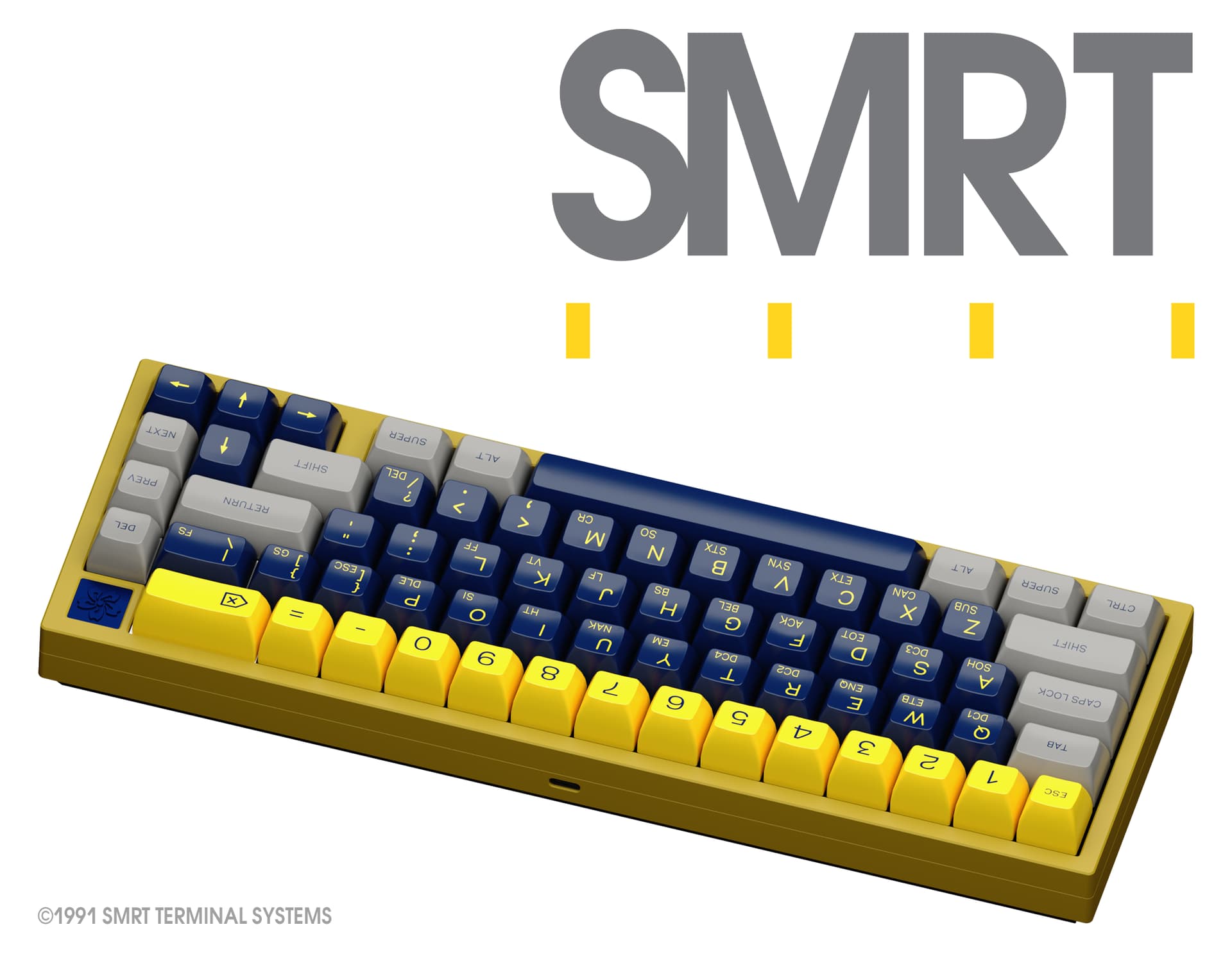

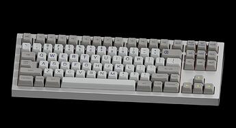

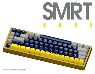

Gonna take this opportunity to post my current kit renders:
And some update board renders with the changes I’ve made:
I’ve been trying to make all the promotional materials look like pages from a fictional 1991-ish tech brochure.
