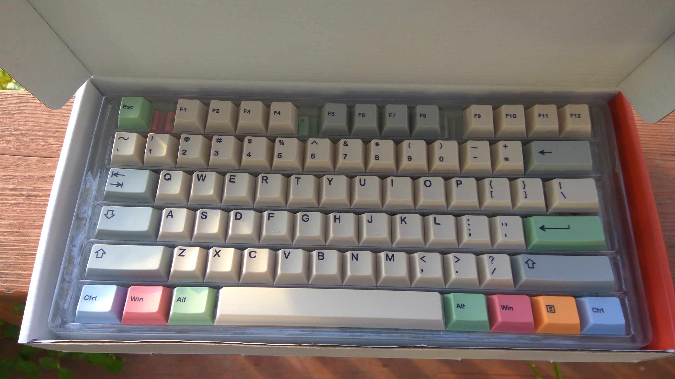

Hi quality, low cost PBT keycap set PSA
Also, it looks like Drop is working on expanding their color-way offerings. kunalkumar is polling the community to see what they’d like to see in the future. Looks like black-on-black might be a possibility as well as RGB and cyan mod kits, yay!
I swear I’m not trying to shill for Drop LOL, but it seems like there’s some interest in this topic.
Haha, yes, I was just thinking about TreeCaps.
The colour is certainly similar.
Now I really regret not getting any. Because they could have been used with these accents.
Also, if they are looking for ideas, maybe they could draw some inspiration from ePBT Slate.

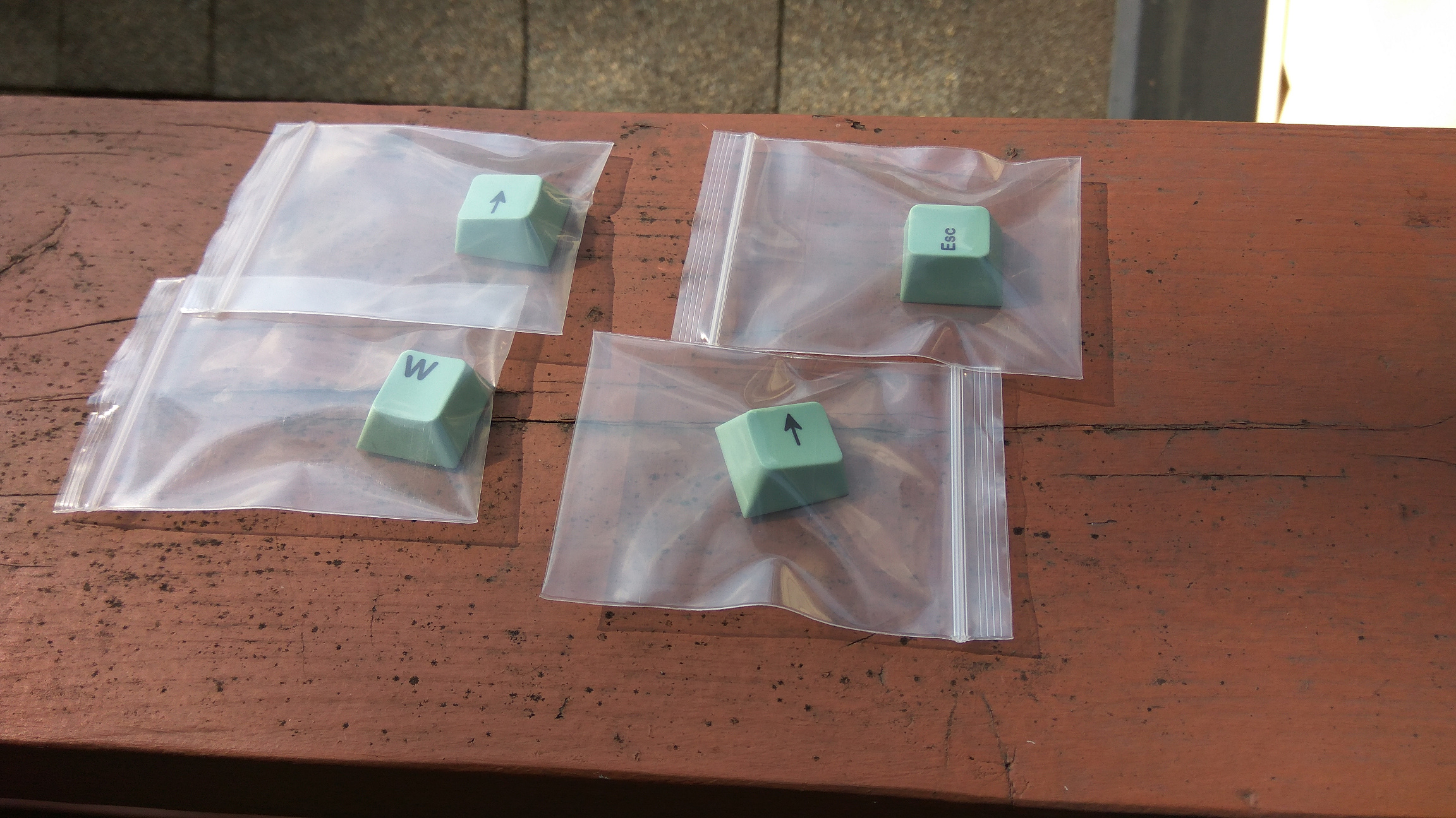

lol, those baggies. I remember getting extras of Godspeed MT3 and each cap came in a baggie. I had like 60 baggies. I kept them all and I do, in fact, use them to store springs!
:slight_smile: Dev tty Round 1 kits also had baggies for each key. I still have a bag full of baggies :))
I’m sure the smoothness of these was mentioned on this thread, but holy hell are they slick. I got a set of the blue accents to go with a ePBT Grayscale set and noticed how much smoother than ePBT they were (which I find to be really silky to the touch). Honestly, I’m not sure if I could type on a full set. The Dye-sub is great though and the color is vibrant so no complaints in those departments.
Yes, that’s a good point.
They really are abnormally smooth, to the point where I doubt they are actually made from ePBT tooling. That was kind of a wild speculation.
Plus, I haven’t done any measurements, and these are probably thinner than ePBT.
It remains to be seen if I can actually type on them. I’m curious. I ordered the Vintage set, so we’ll see!
I’ve been using the set for a couple of weeks now and I actually prefer the smoothness to that of an ePBT keyset. They provide enough grip for my fingers.
