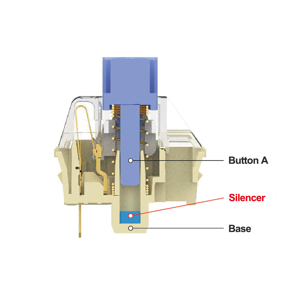

So, I recently ordered a batch of TTC Golden Blue switches to try…they should be arriving tomorrow… Tonight I was looking at AliExpress and noticed the TTC Brother switch, which looks almost identical to the Golden Blue switch. And, indeed on closer examination the actuation force, the tactility force, the reset, etc. all looked the same. But then I saw another diagram that explained the difference: the Brother switch has a pad at the bottom of the shift that is supposed to dampen the bottom out sound from the switch.
Here’s their diagram:
I took a look on here, and saw some discussions about TTC switches, and even a reference or two to the Brother switch. But no one has said they have actual experience with them. Has anyone tried them?
Yes! They actually are the same as Golden Blues; just different names depending on the seller - that silicone plug is there either way. It’s the same plug used in the Bluish White, and all of TTC’s other dampened switches.
They’re pretty much classic jacket-clickies, but minus the “clack!” of bottom-out, replaced with a muted “thud” that accompanies the click. The travel is also slightly shortened by the plug.
Yeah, there’s about a difference of 0.15mm in travel according the specs… Interesting, if I like the Golden Blue switches at all (which I have my doubts) I might order in a batch of the Brothers.
