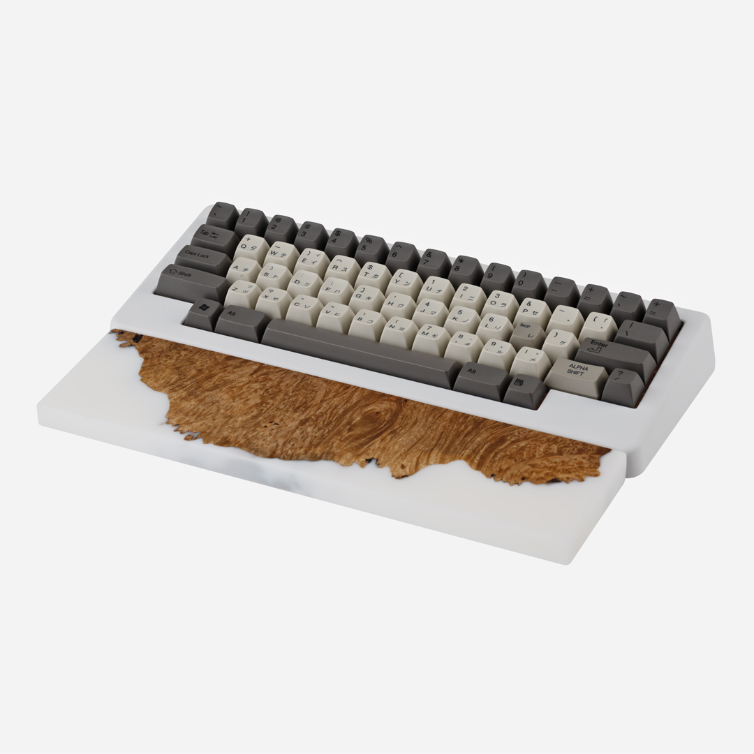

I picked up a VHS housing for my Pro 2 with HASU controller. :slight_smile:
@norbauer Do you have any photos portraying the entire case from an angle? Your cases have such a unique form that I feel top-down photos alone don’t do them enough justice.
I do have this one, if it’s helpful.
