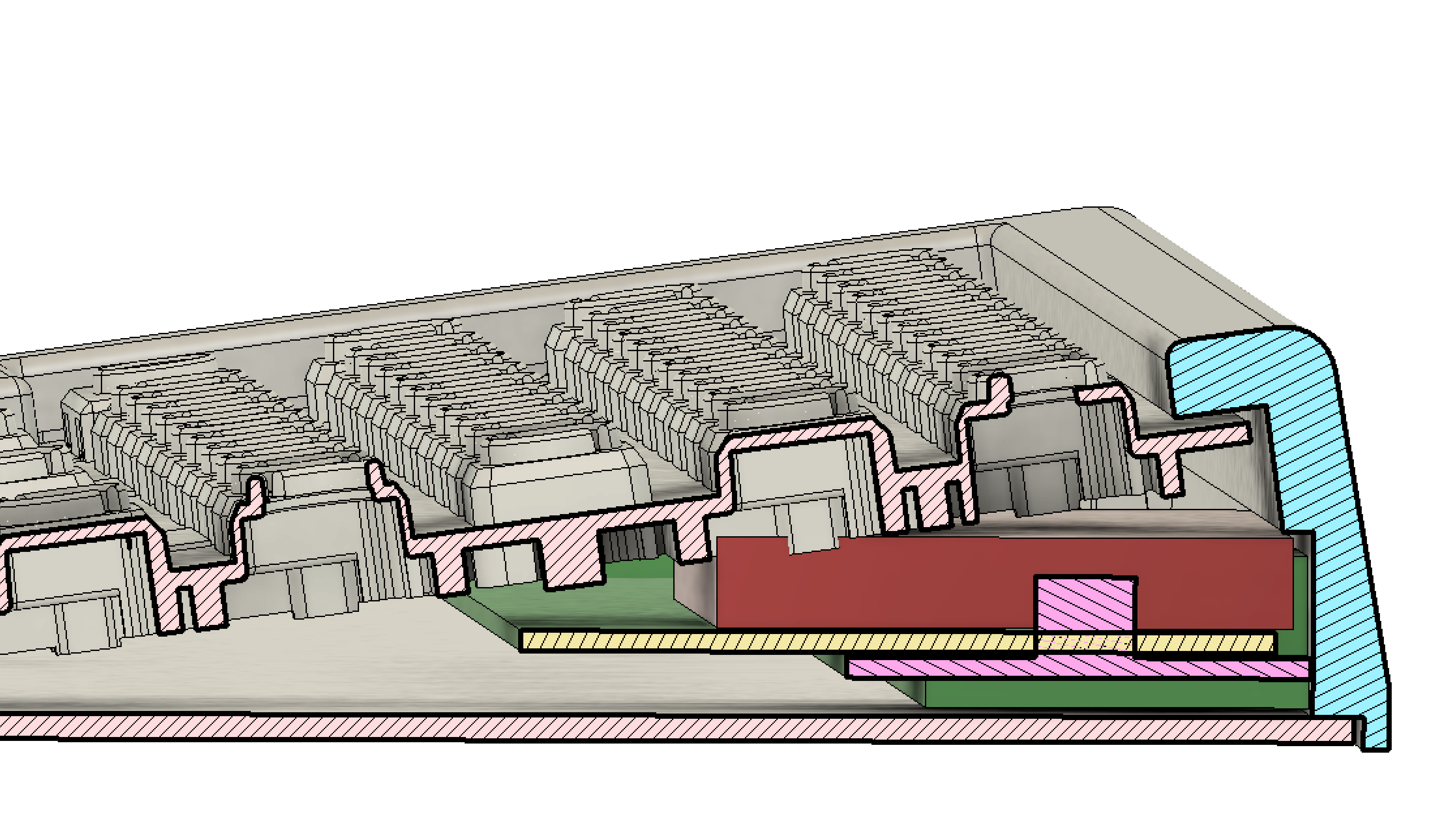

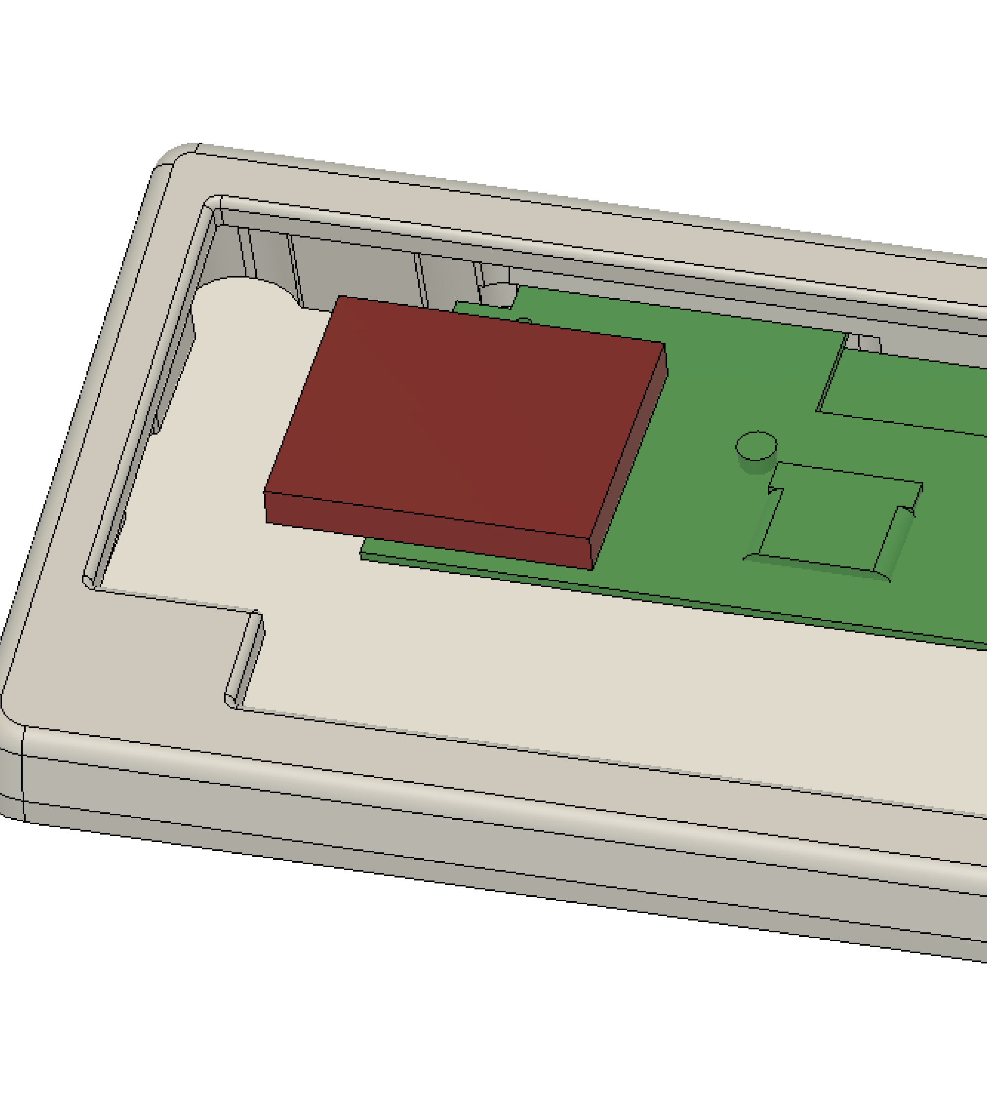

Do we know for sure whether the Pro 2 chassis will have sufficient room for a battery for use with aftermarket BLE controllers, given the sound dampening material in the case?
If you know the dimensions of the object you want to try to fit inside, I can mock it up in CAD and let you know.
Thank you for the update! Dose that mean we can expect steel to be ready once the switch plate is done?
Very generous of you Ryan, thanks! The one I’m eyeing up is 54 x 45 x 7.1mm
No, the stainless housings take a considerable amount of time to finish after machining since they’re all polished by hand here in Los Angeles, so I still expect these to be ready with everything else sometime this summer.
A bit too large, I’m afraid. Those dimensions are the red block in this image:
You could sort of fit it here to the left of the breakout PCB, but it’s the height interfering with the switch plate that is the issue
Thank you so much for this, Ryan, and to madphoenix for raising the topic. This is super useful.
I just put in an order for a Heavy Grail and intend to use the Yang BLE controller for it - bit of a Hail Mary strategy in terms of the battery but I could not miss out on the extra pre-order slots. It looks like you could fit a thinner and longer battery to the left of the breakout PCB if you compromise a few mAh. This matches my rough conclusions from sleuthing around on the existing stream recordings where the Heavy Grail prototype was disassembled. Thrilled.
