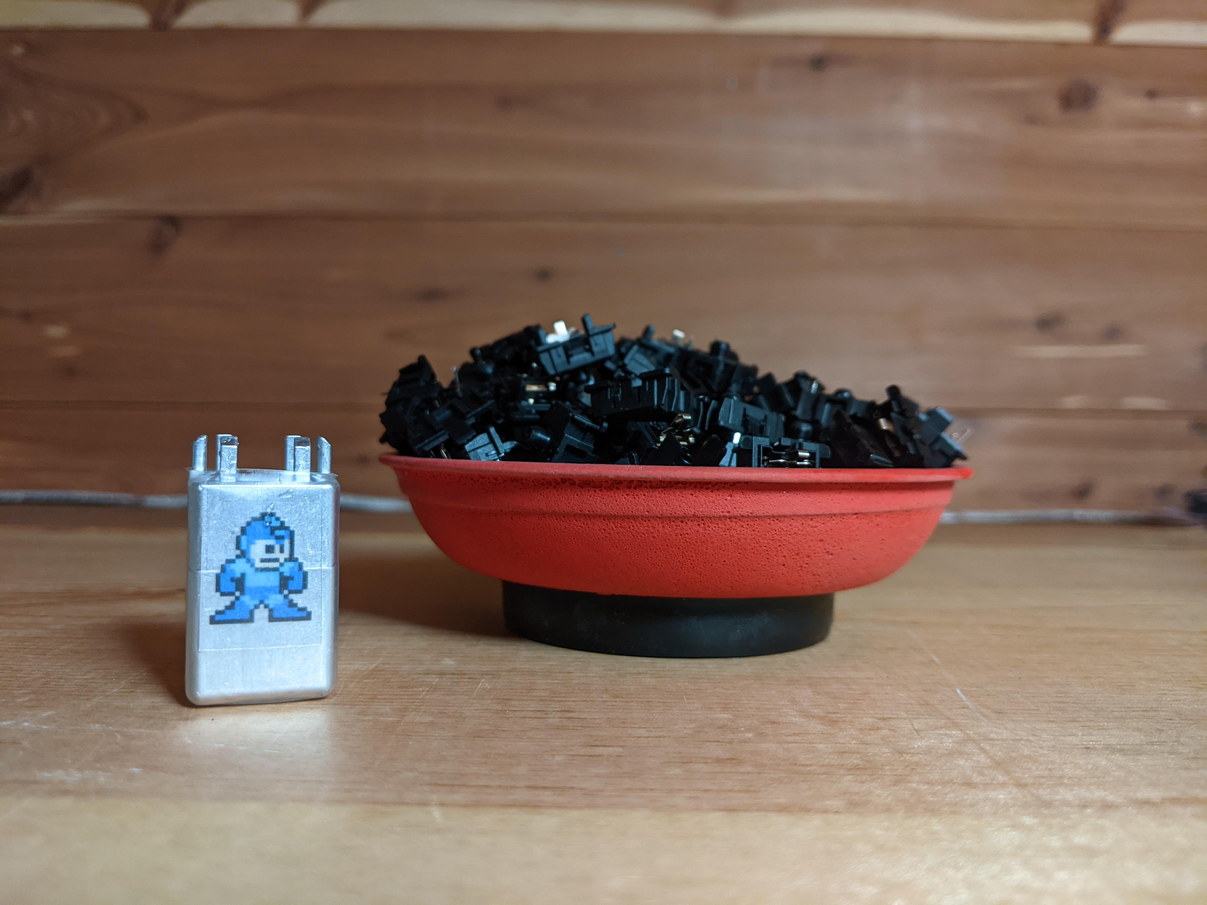

In the mean time KiiBoss was still going strong today on a bowl of Cherry Switches.
