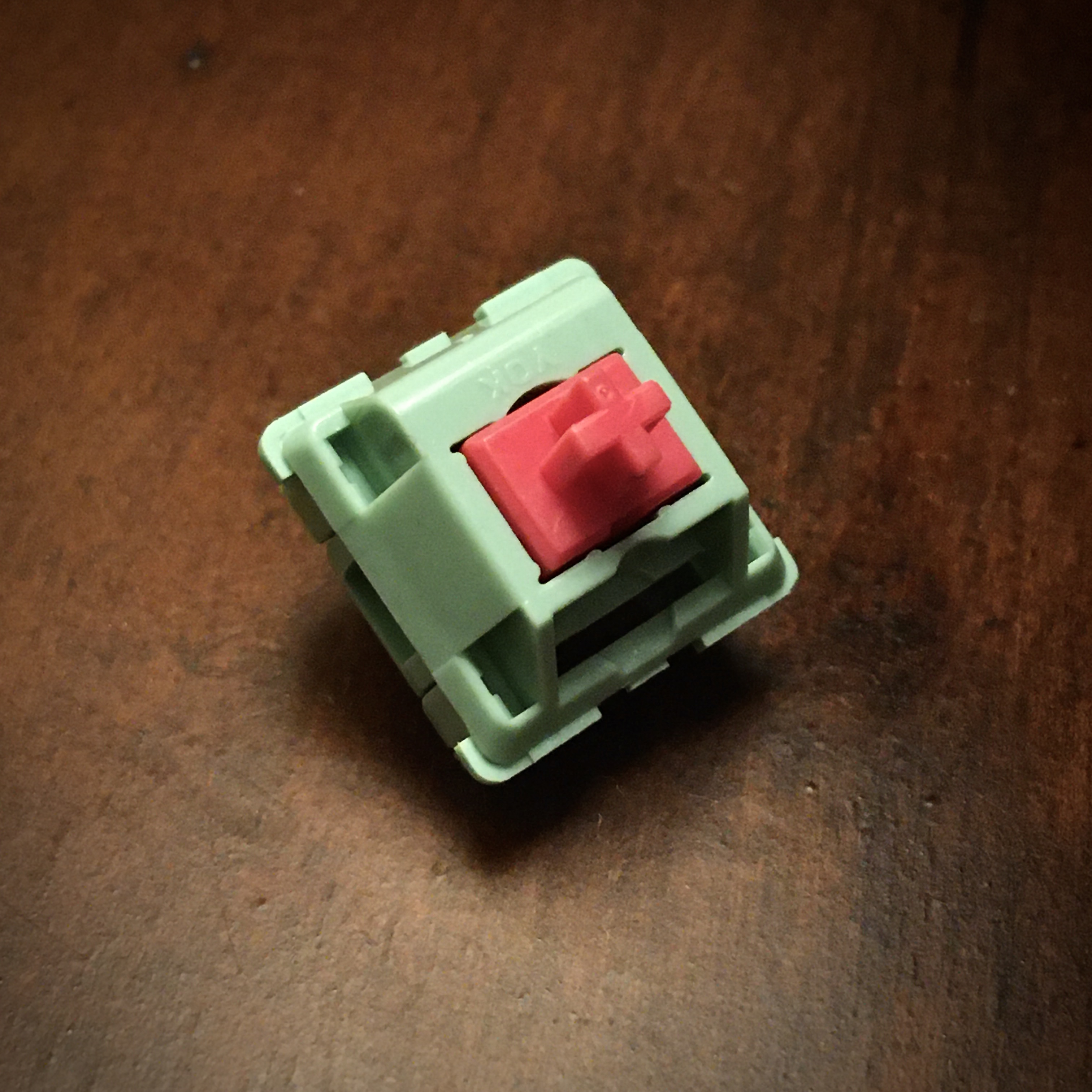

Ahoy, all. In light of the exploding variety of switches and components this past year or so, I thought it might be fun to have a thread dedicated to frankenswitches, whether they be failures, fantastic, or just for fun. I’ll get things started with one of the just for fun variety:
Strawberry Mint
  • YOK Mint Panda housing and spring
  • KBDfans Aliaz stem
  • Reasonably quiet
  • Moderately tactile
  • Looks neat
  • Doesn’t really excel at anything though
More tactile than an Aliaz - which isn’t saying much - and also louder. More wobble and less refinement than I like in a switch - but those colors…

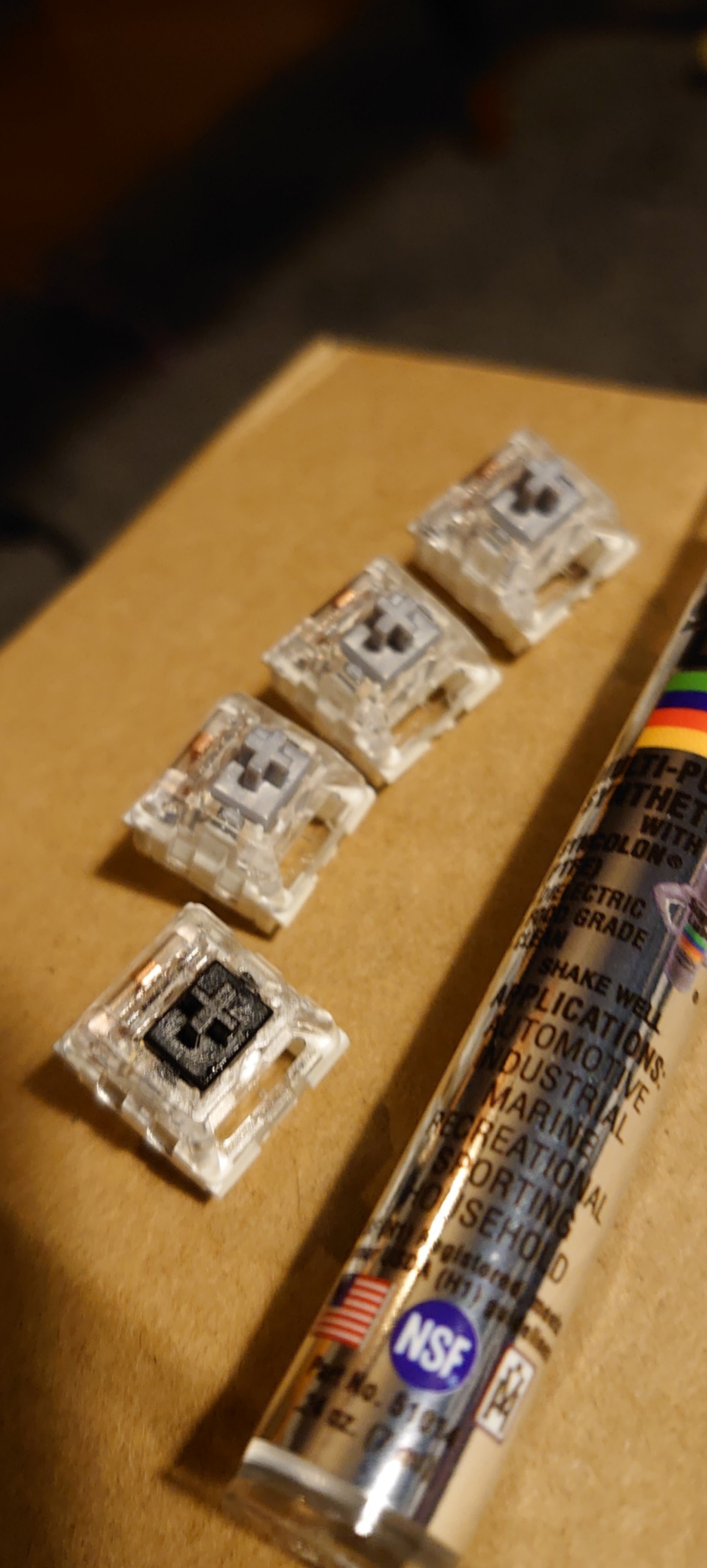

I put together a switch that has turned out to be one of my favorites, I dubbed “Skream”:
  • Outemu Sky v2.2 housing
  • Novelkeys Cream stem
  • Sprit 45g spring
  • Sliders and stem lubed with Krytox 205g0
  • Spring bag-lubed with HOPPE’S No. 9 Lubricating Oil
They look and sound awesome! Watch the linked vid for sound test: (I’ll hopefully have one up this next weekend of these switches in my custom Preonic with aluminum case and copper plate)
Typing Test

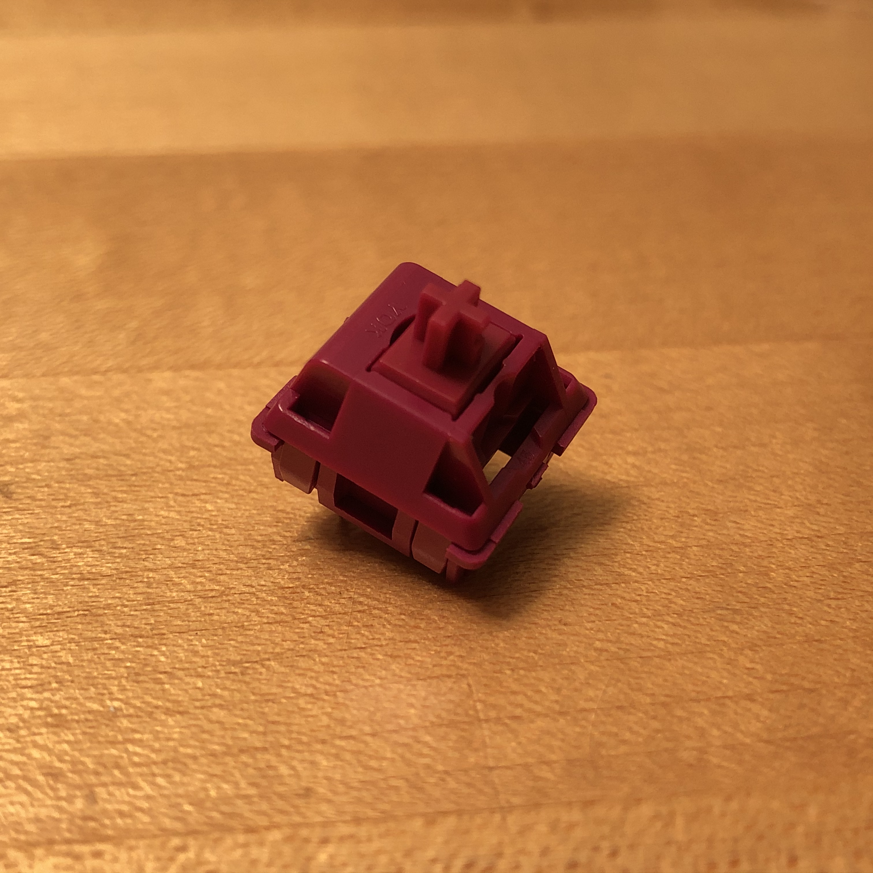

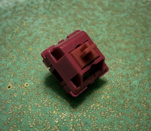

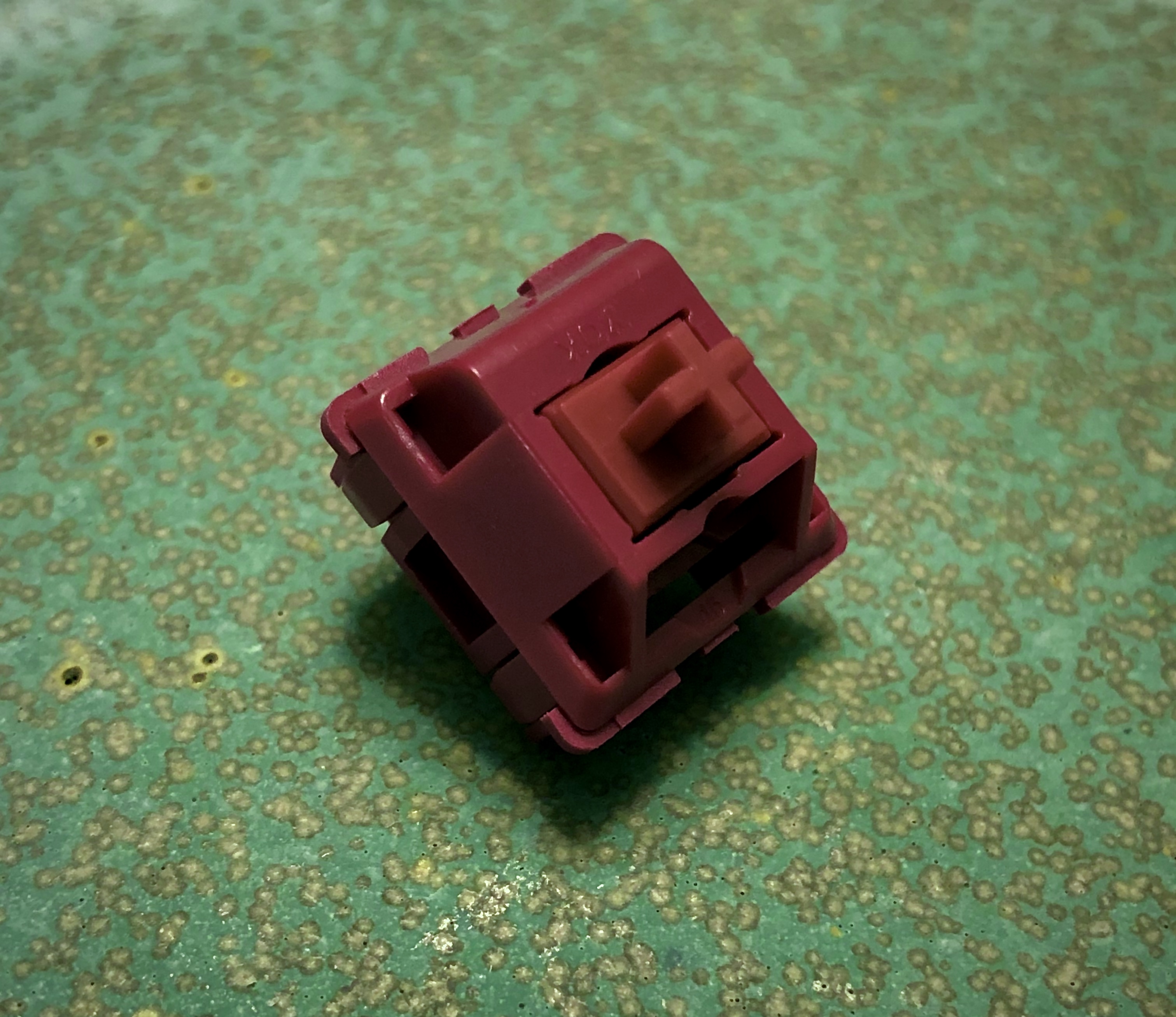

Red Burgundy
  • YOK Red Panda housing and spring
  • Kailh Pro Burgundy stem
  • Distinctive sound
  • Red like wine
The Kailh Pro Burgundy’s long-posted stem gives this a similar bottom-out sound to a Holy Panda, minus the tactile element beforehand. Not the same as a Cream, but still has a fairly “creamy” element to the bottom-out sound. Less harsh housing vibrations or a slightly softer plastic than my imaginary baseline, maybe?
I put this together specifically to have a linear with that great “tak! tak!” Holy Panda bottom out sound - but once again, I’m all about that color. More serviceable than my last colorful frankenswitch, I might actually use these after a bit of lubing.

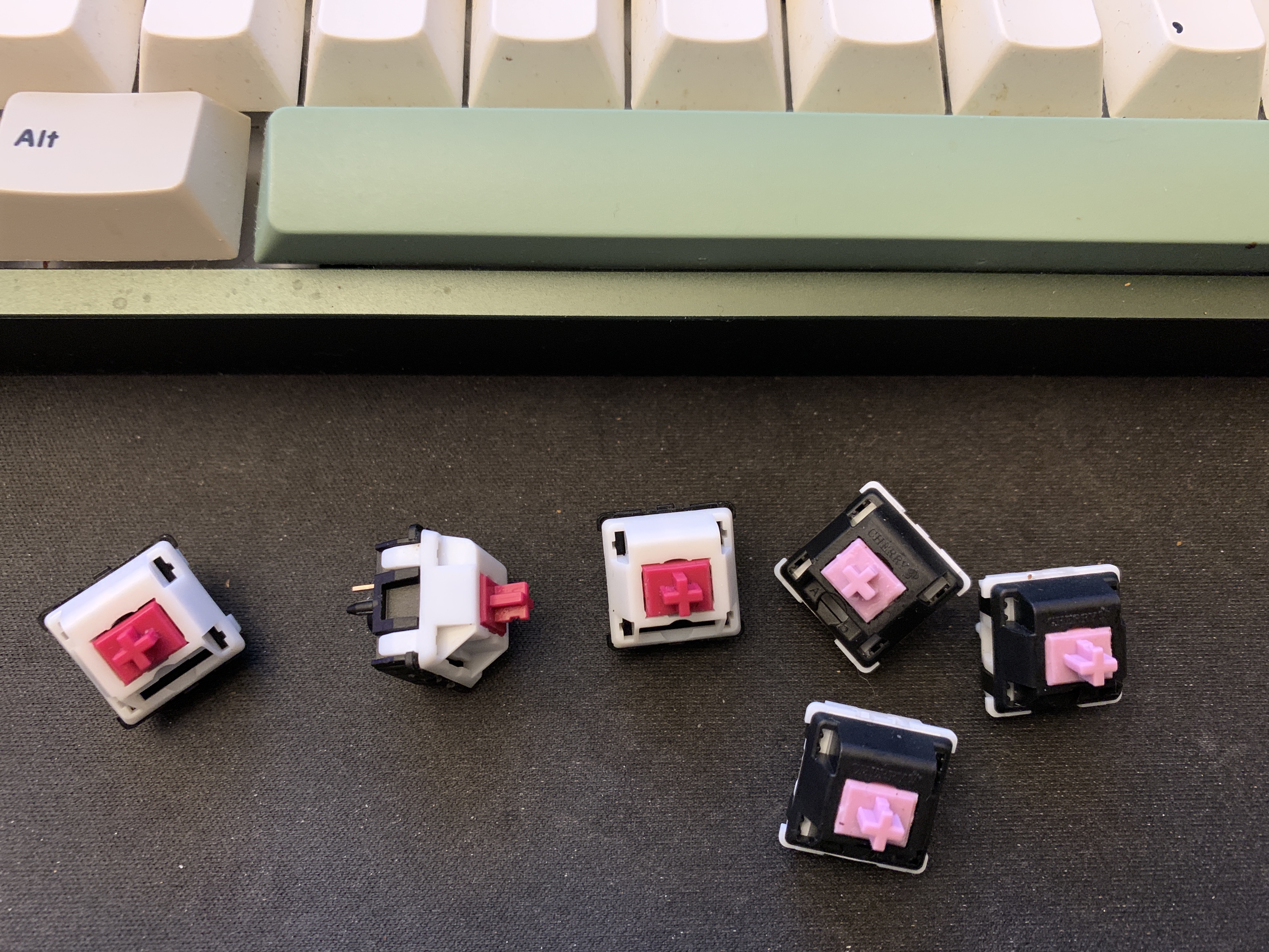

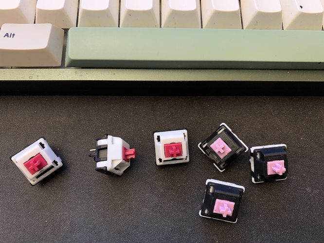

Right: Black Mauve - Mauve with Cherry MX Black top housing. Sounds more solid (warning: subjective) than regular Mauves. Still not as good as Cherry MX Black but closer.
Left: Red Tap Dancer - Cherry MX Black bottom housing + Mauve top housing + Kailh Pro Burgundy stem. Extended stem tip striking Cherry MX Black bottom housing makes sound that reminds you of tap dancing. Two issues: shorter key travel, somewhat scratchy.
UPDATE: Mauves sound pretty nice but there is a slight hint of cheap plastic soap case sound to it. Cherry MX Black top housing reduces some of that.

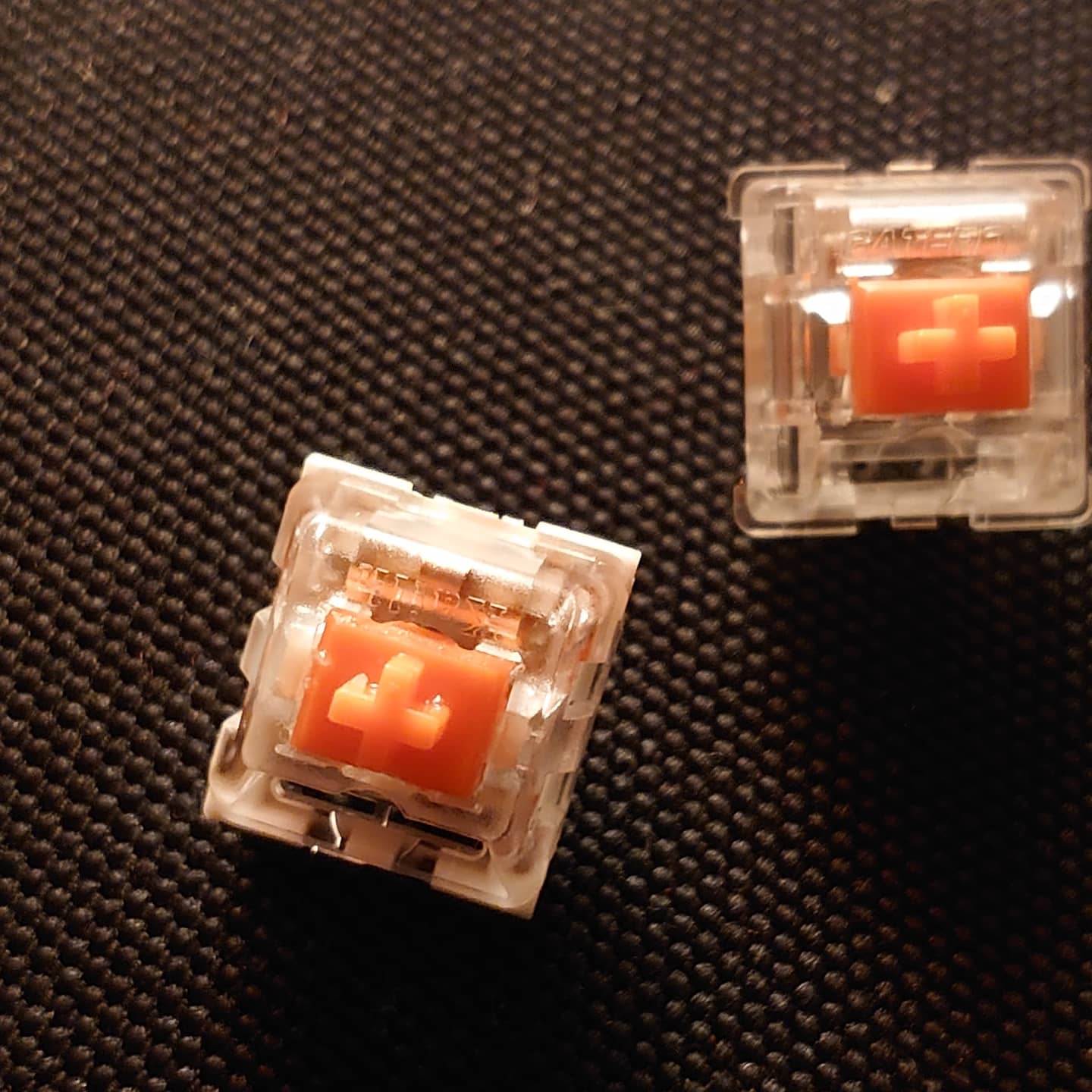

Have you ever wanted to flex an entire board of Hirose Orange switches, but can’t because you’re poor as all hell? Well oh boy do I have the frankenswitch for you! And it only needs two switches to make! WOW!
Stealirose Orange Switch
Top Housing: Cherry (for the logo)
Stem: Tangerine Rev2 (Gateron-made)
Spring: Cherry Black (or similar)
Bottom Housing: Black Gateron (or really any black bottom housing)
Name inspiration is taken from “Stealios.” The two switches that I had in mind are the Tangerine and a Cherry Black. You could do this with vint blacks, too, but the point is it’s cheaper. I don’t have a pic or a sound test yet but if someone has some extra Tangerines on the cheap then hmu.
Maybe just me, but if you put ‘ios’ in the name it should be a zeal switch part in there. But then again, there are no rules in frankenswitches. =)
But will try if I ever get some tangerines.
Is there something fun to do with the tangerine housings?
It’s “irose” to denote the Hirose switch it’s imitating. The housings afaik are just Gat milky top housings.
