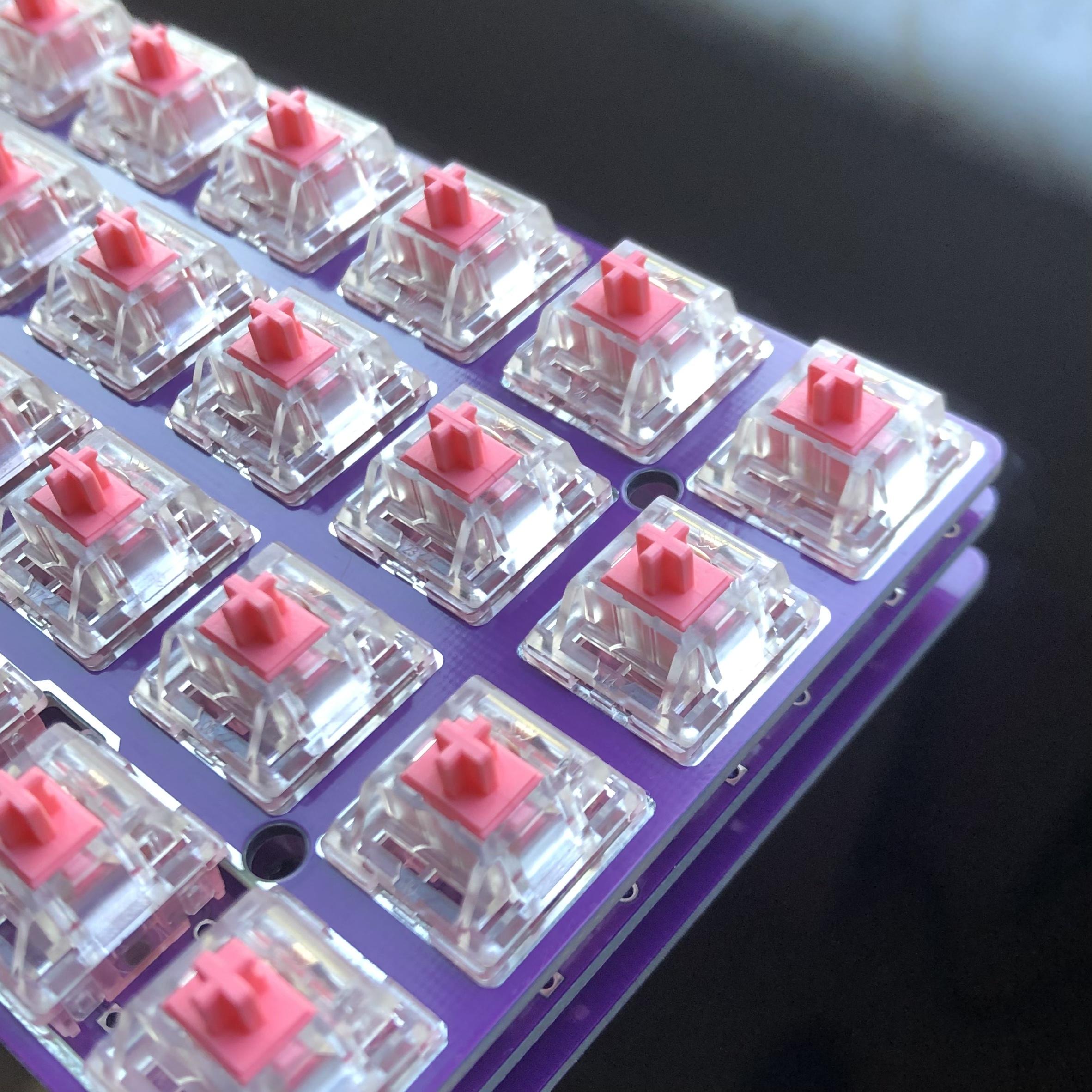

Bought and been using some KTT Strawberry switches for the past week or so now. Light (43g A, 62g BO), stem-pole bottom out (while still sounding muted and not losing much key travel @4mm), very adequately and evenly factory lubed. Polycarb top and bottom, POM stem. Minimal wobble with GMK at least.
I might just leave these unlubed and solder them into my next bluetooth yasui build… it’d be my first time not modding switches but they really don’t seem to need it badly if at all.
