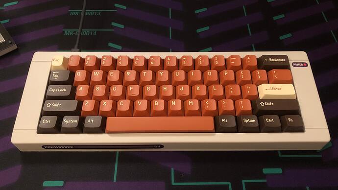

Matrix 2.0 add wkl Beige
Cherry mx blacks on alu
Razer viper ultimate mercury

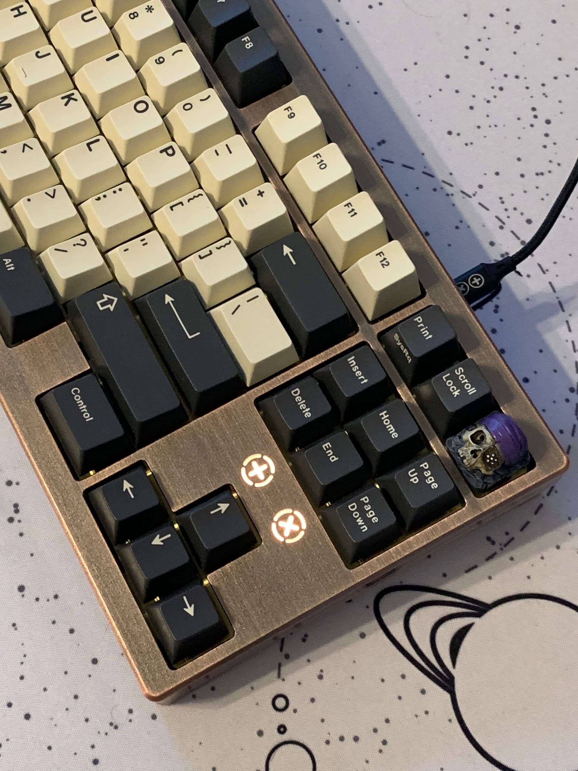

what kb is that? layout is so cool and the caps look great on it
That’s an Exclusive E8-V1
It was a god-awful group buy and many still don’t have their boards. I was lucky to get mine as well. The layout is called “Chinese WKL” usually. Board looks great with Plum

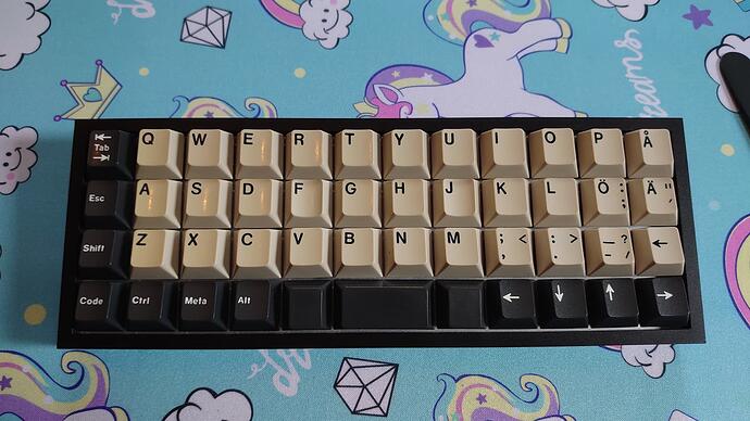

Great idea. Pulled this out of Davy Jones’ locker for the day
TX 84se with Gateron FEI, GMK Carbon Boneyard, Clackkeys One Eyed Willy

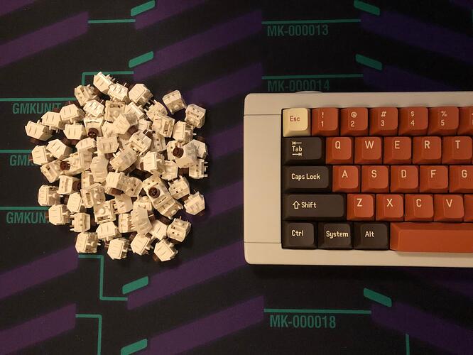

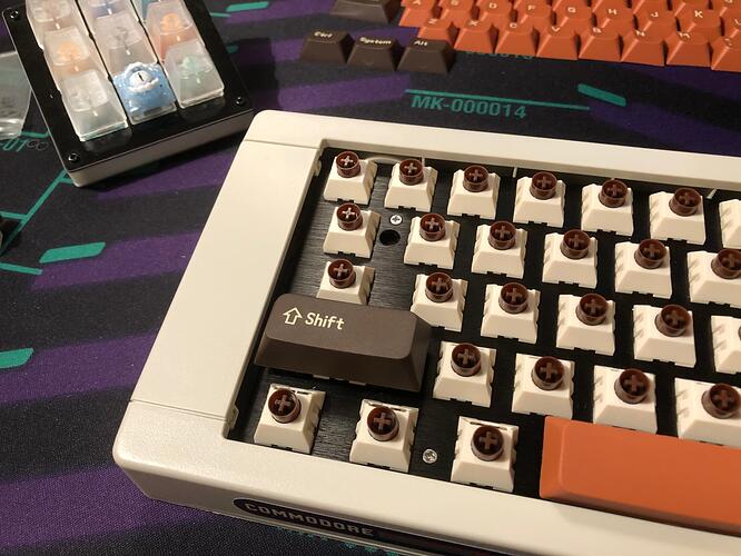

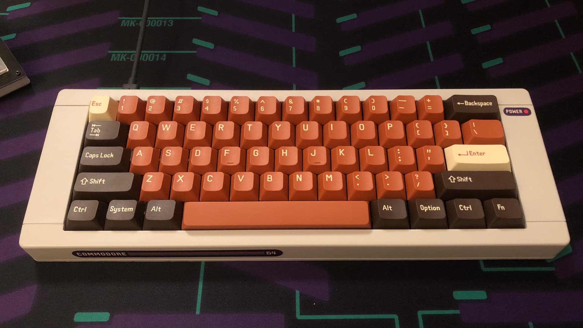

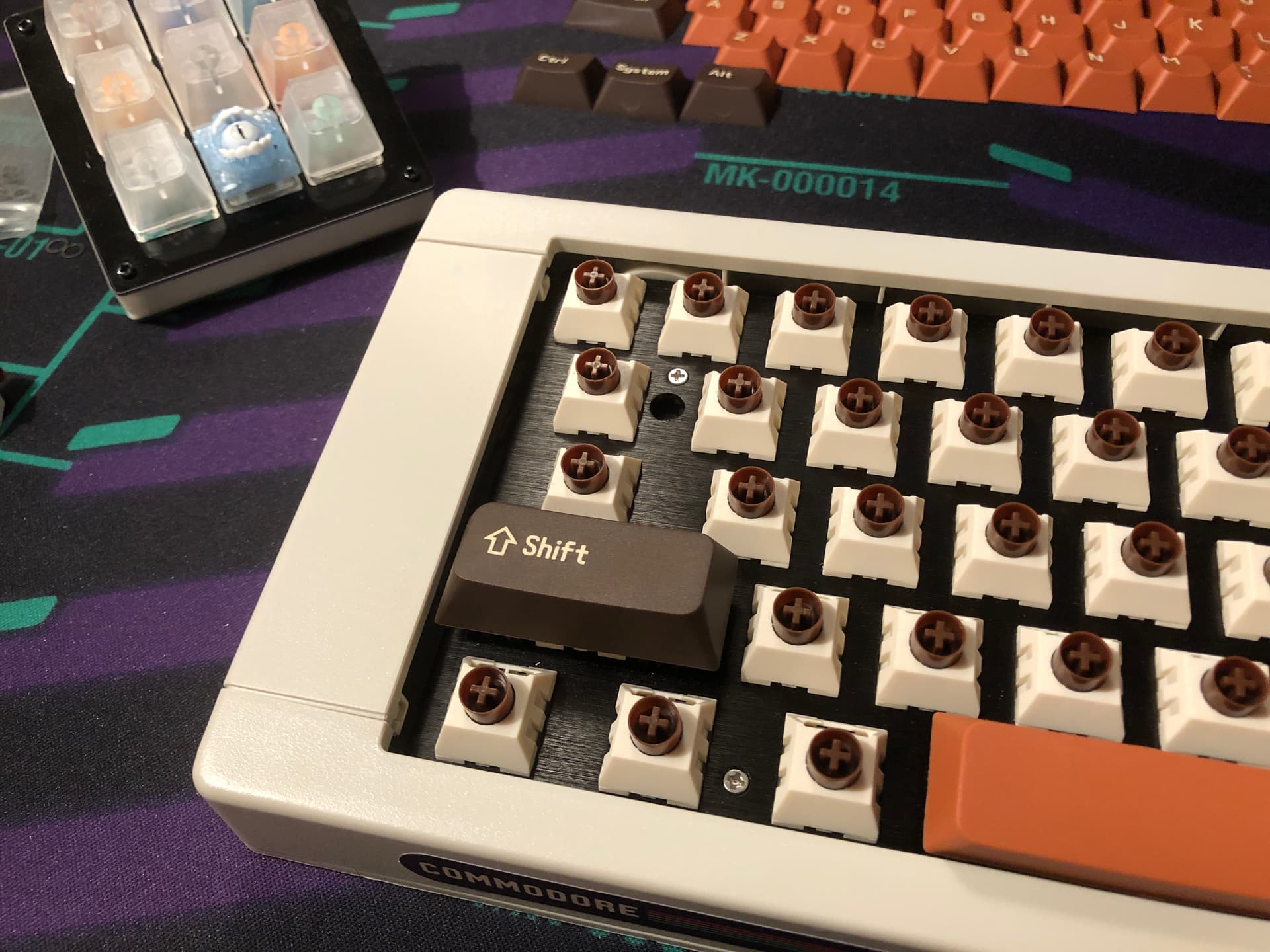

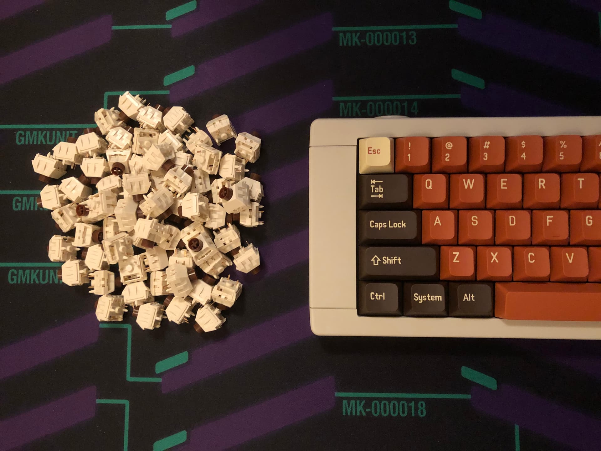

Since the MCR caps are interfering with the North-facing silent Outemus, I’m swapping-in some switches that avoid the issue.
These are BOX Creams with BOX Silent Brown stems. Both of those switches are interference-free, and this combination happens to match the case and caps.

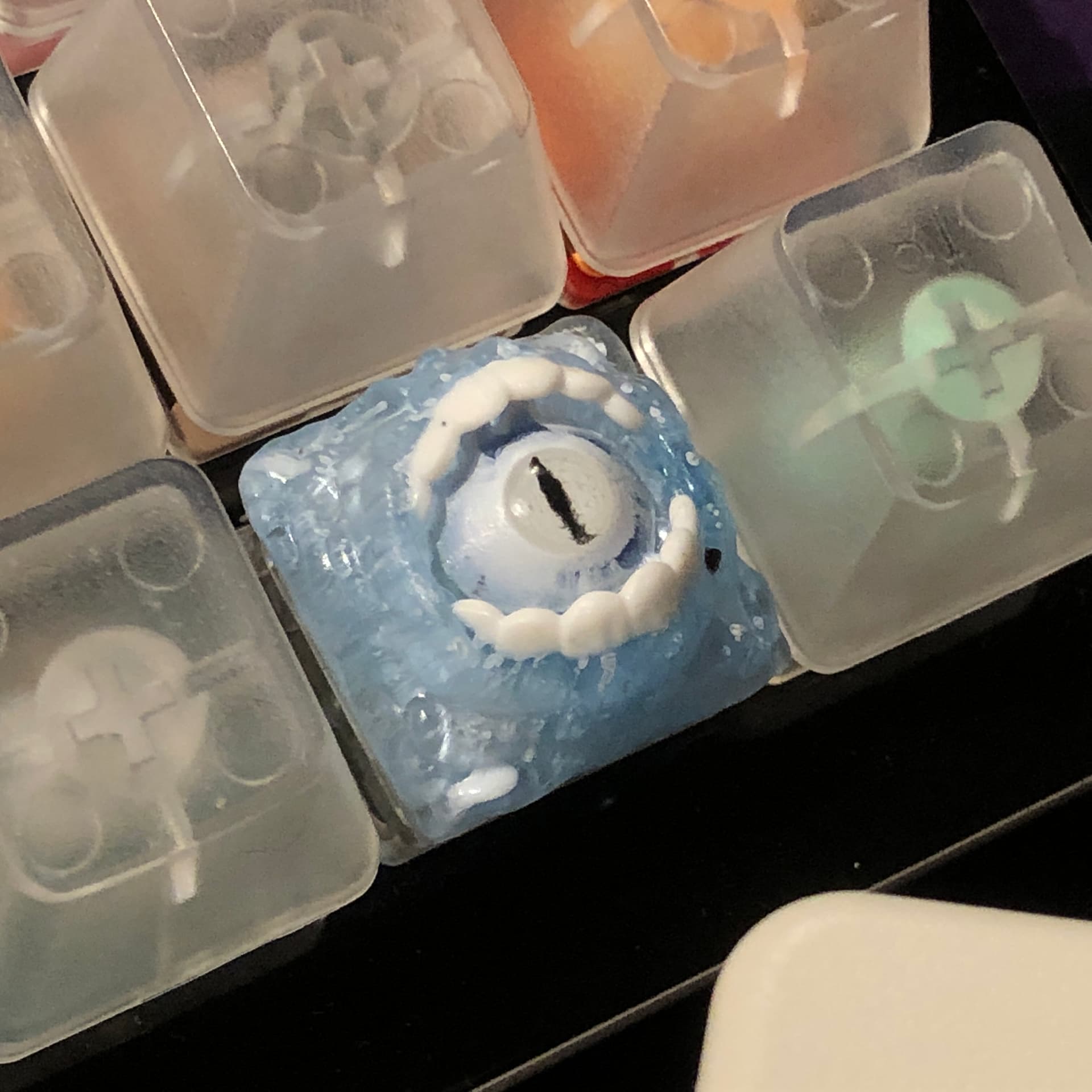

One of @vkeycaps gnarly artisans on my tester in the background there:

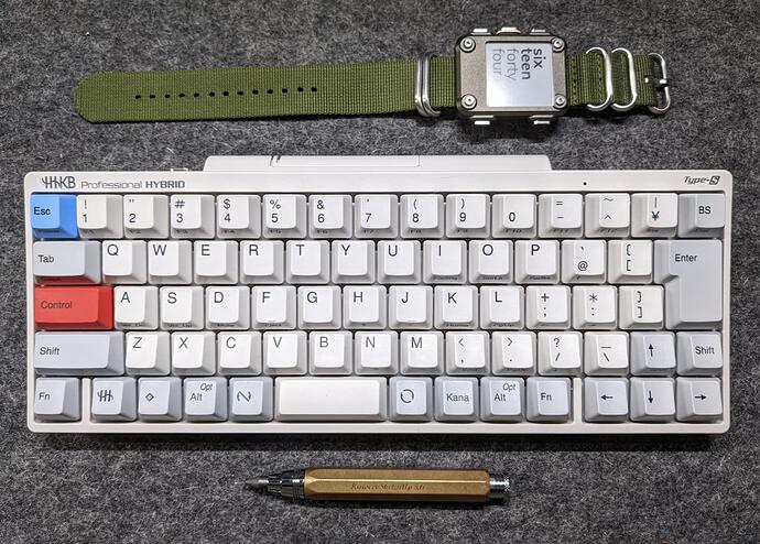

Tell me more about your watch! It looks fun!
It’s a quasi-DIY watch called Watchy.
Mine has an aluminum case that they manufactured for it as well. It’s fun, but the battery life isn’t outstanding.
