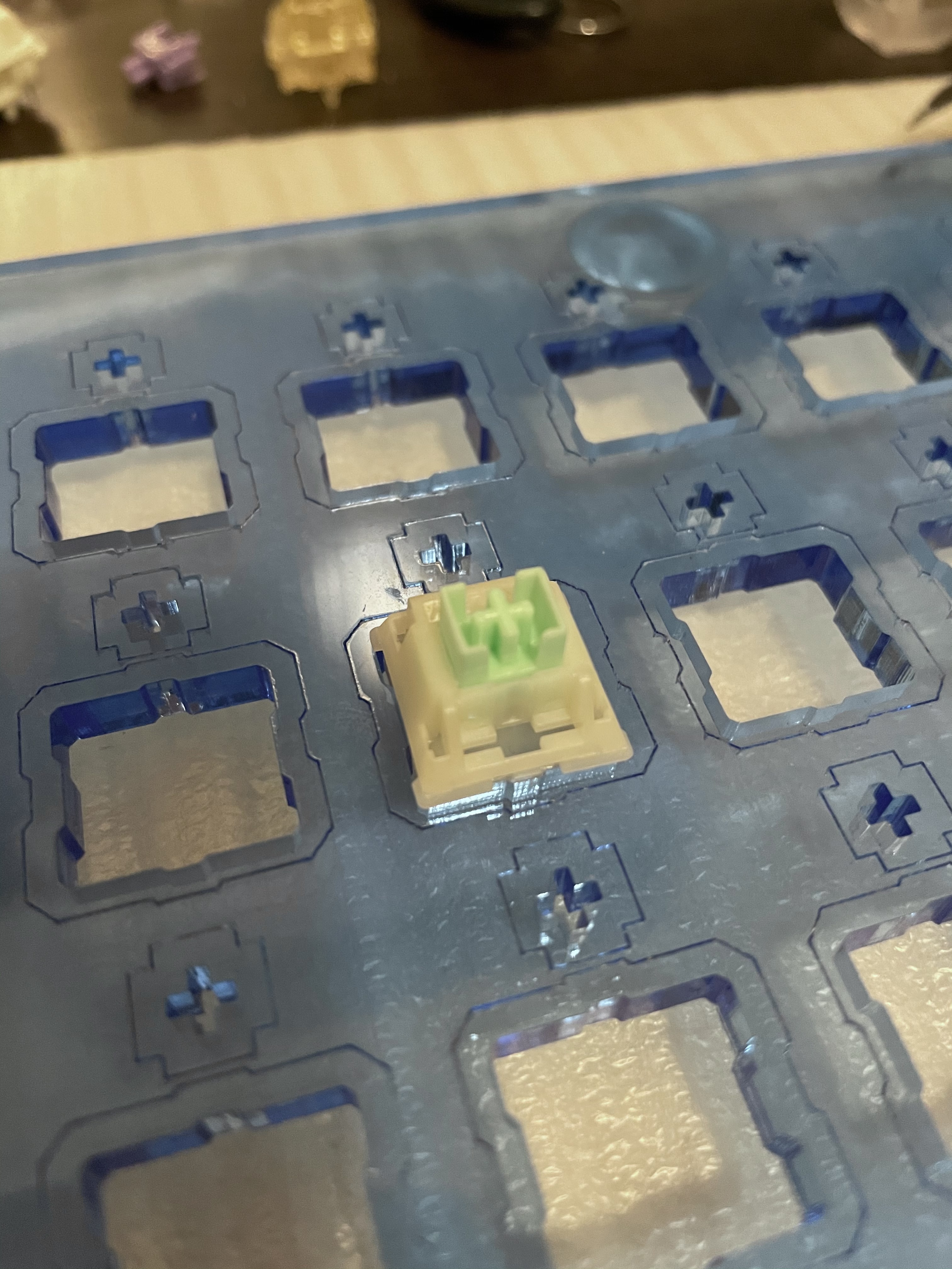

Sunday Morning (Failed) Frankenswitch: Bobaroo
Real quick frankenswitch experiment this morning. Specs are: Boba housing, Kangaroo stem, Boba 62g spring
The pros:
  • Much cuter than this stem in its proper housing
  • Nice downstroke feel/sound
The cons:
  • Stem doesn’t return
The boba tops are, somewhat predictably, too tight for this interesting stem to fully return: it seems to stop about 1-1.5mm short, which is better than I’ve seen on some other stems. Might be possible to address this with lubing and/or a stronger spring? Definitely want to try it with the Kangaroo springs, first, since those are longer and heavier so they might manage to push the stem past where it’s catching.
