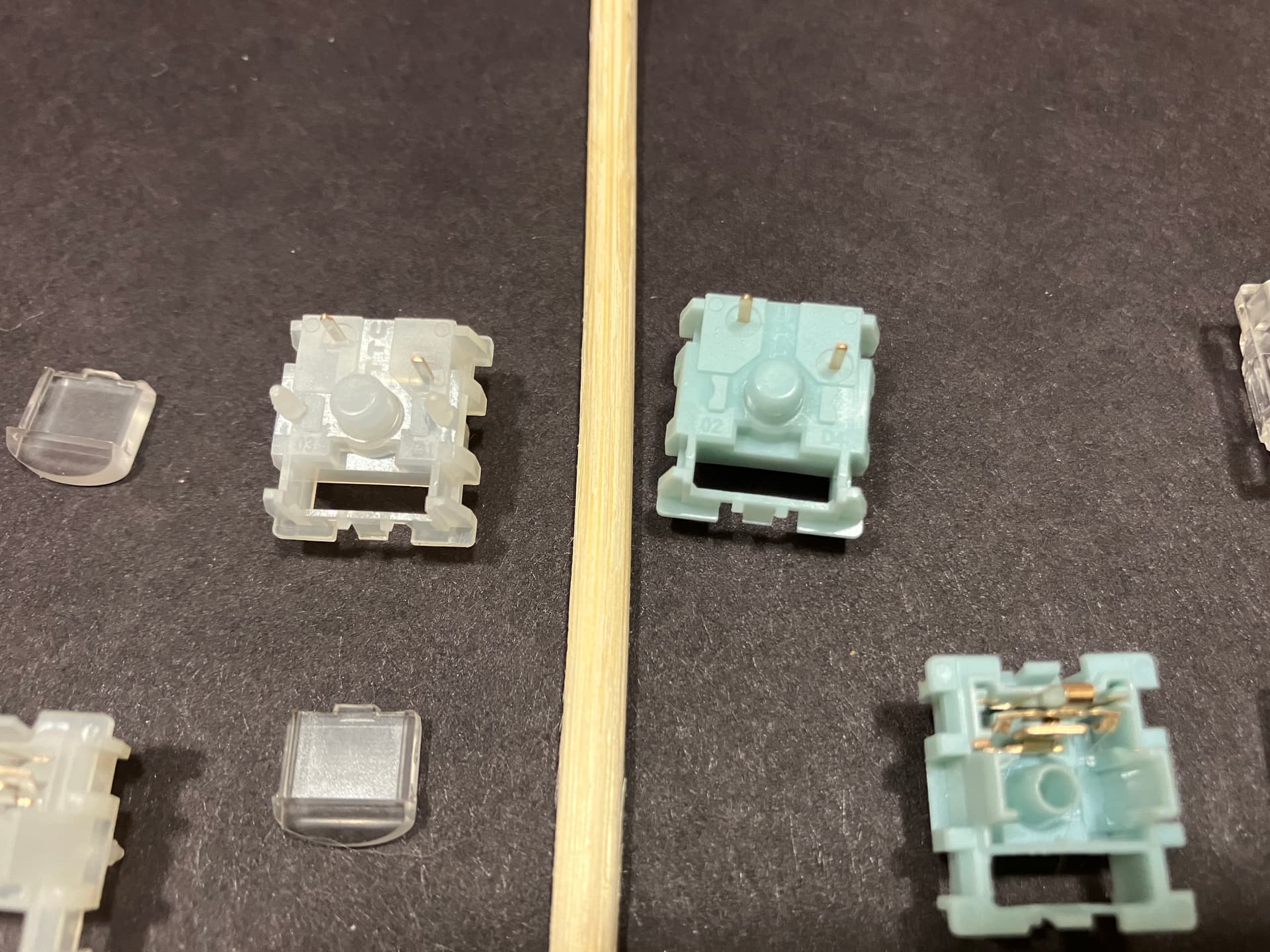

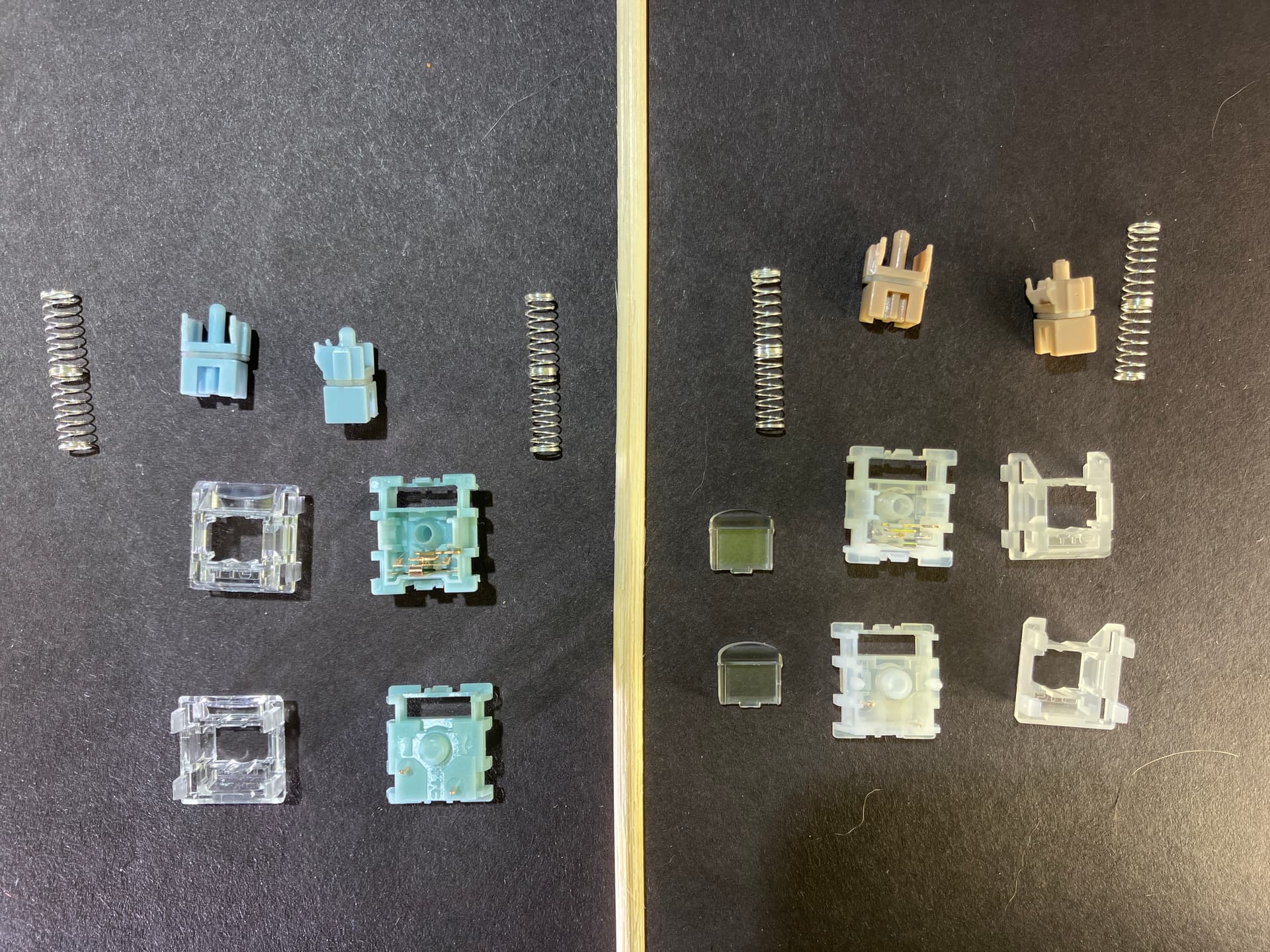

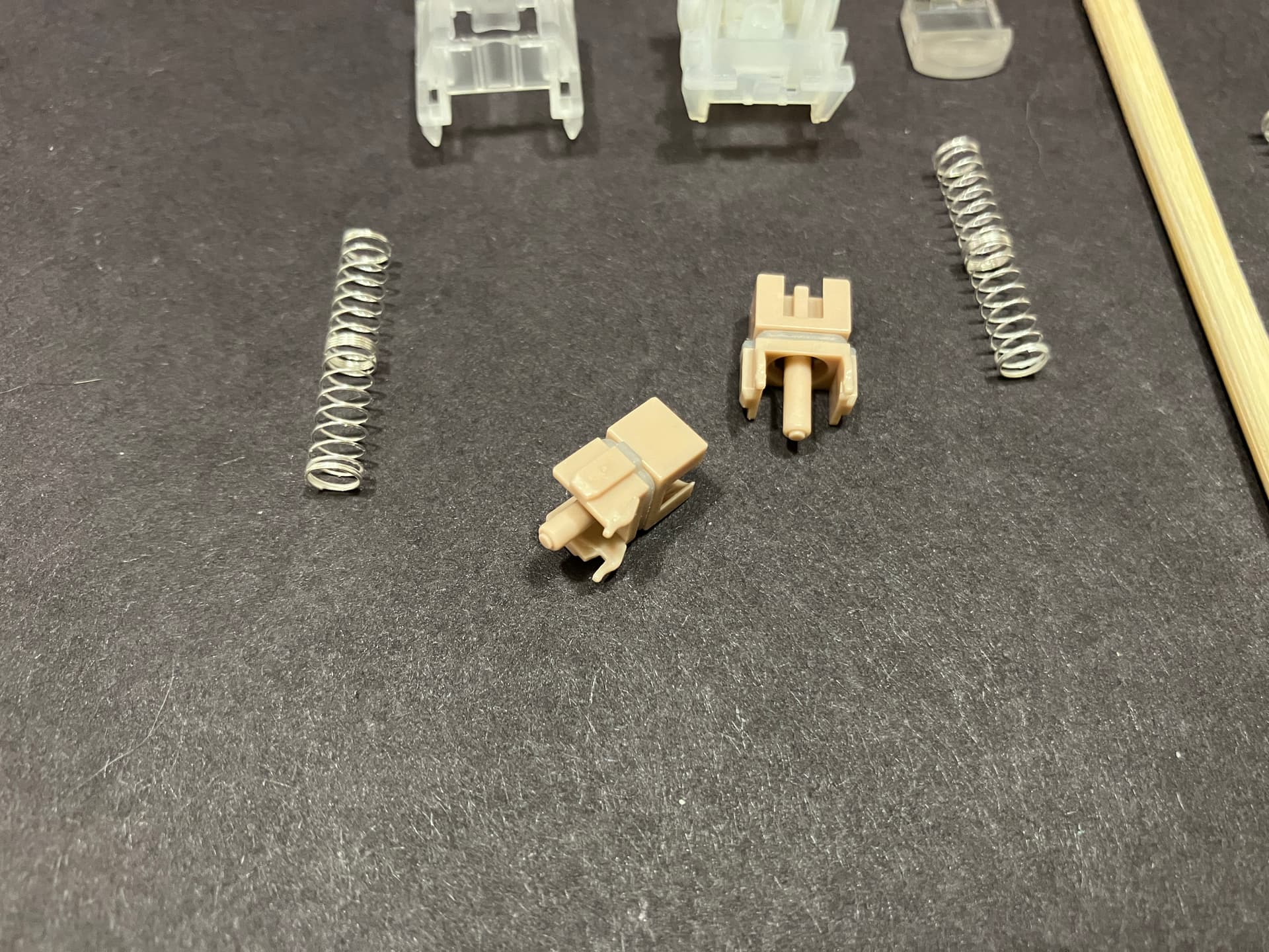

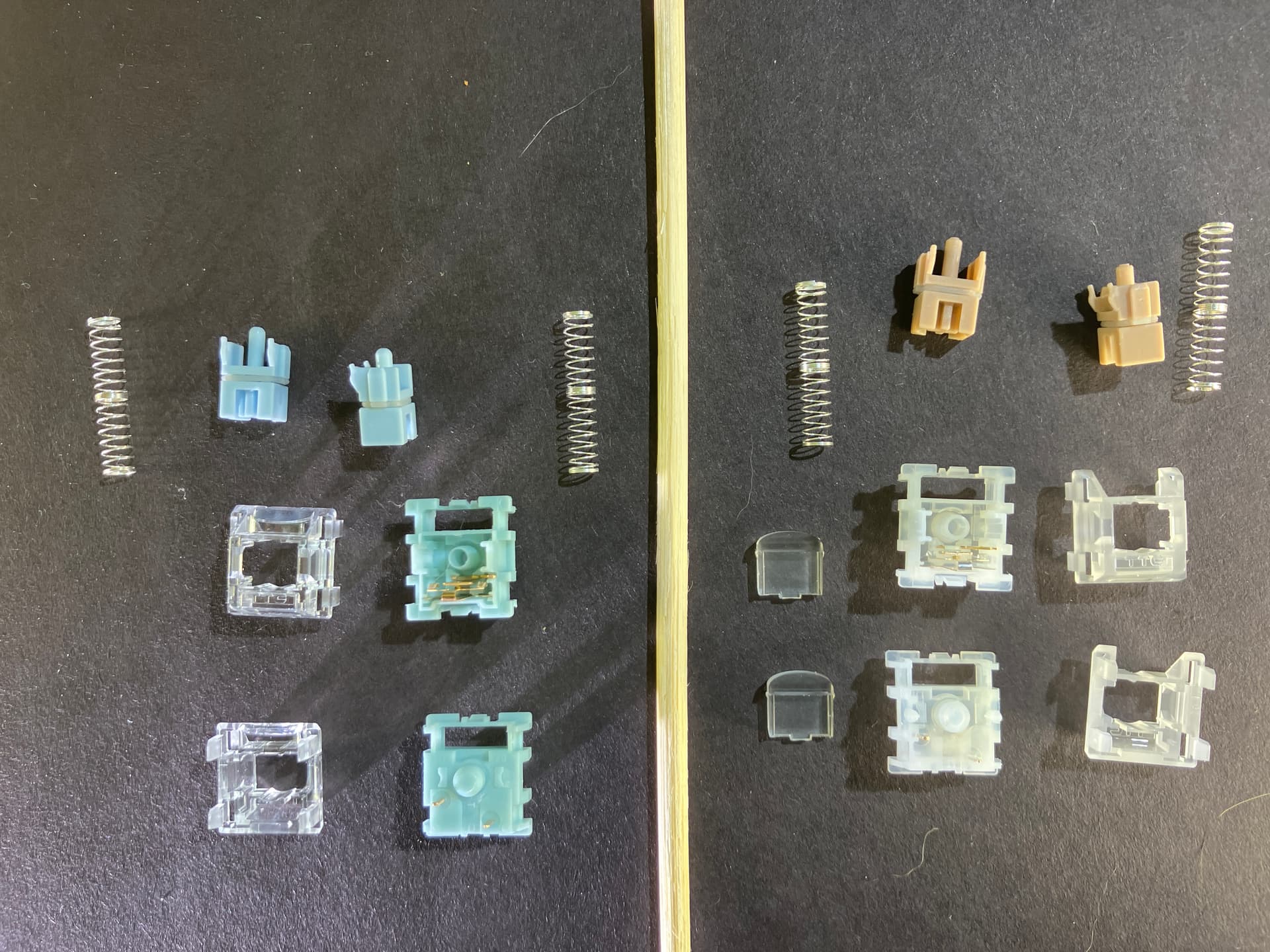

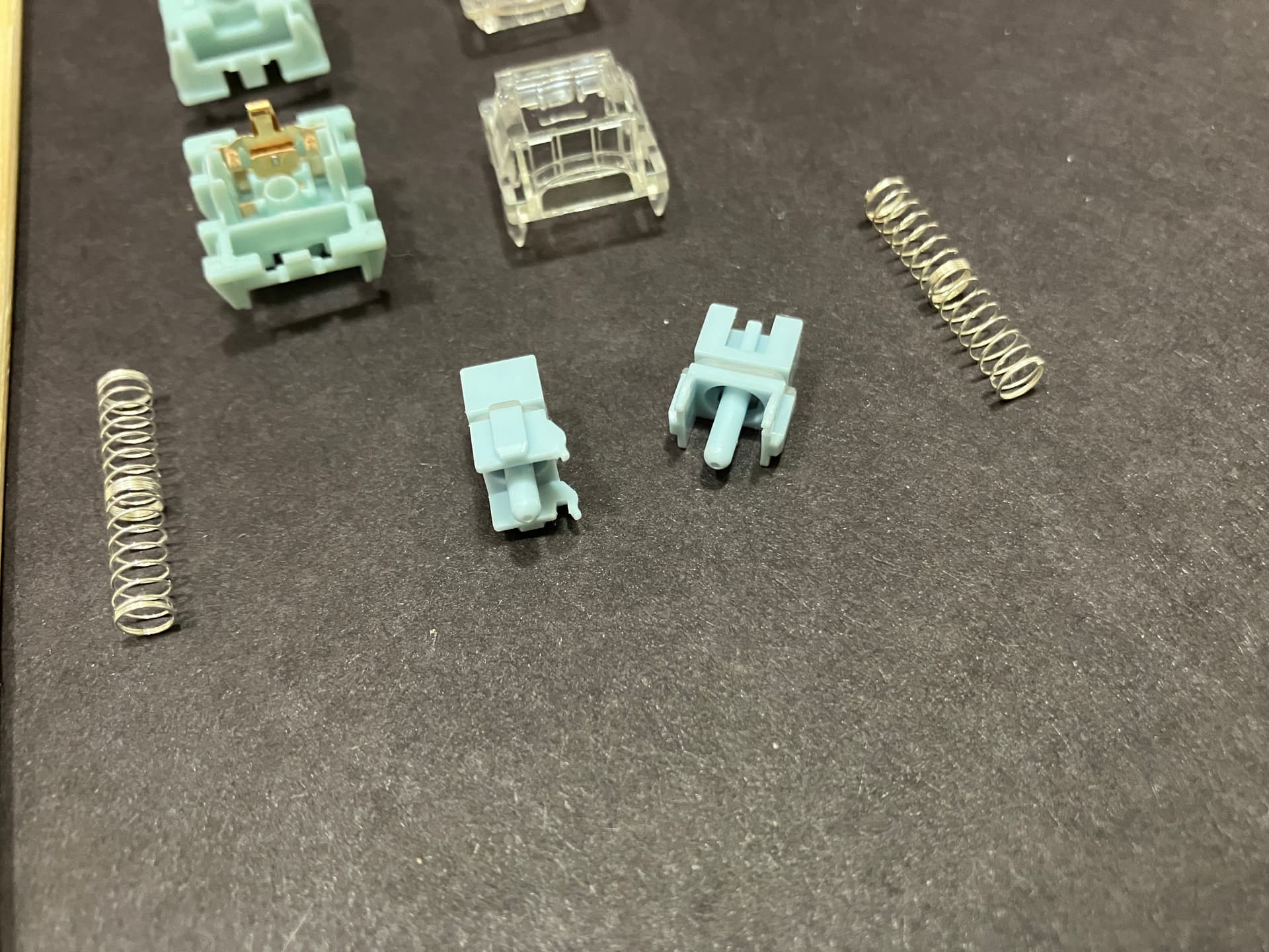

Differences I noticed between SwagKeys x TTC Peanut Latte (vs TTC Bluish Whites):
  • PCB mounting legs (“5 pin” instead of “3 pin”)
  • Top and bottom housing are both a milky-white, translucent plastic
  • Has a proper lens that is separate from the housings
  • PL pole measures ~12.7mm (vs 12.5 for the BW)
  • Pole bottom is flat with a slightly raised (1.1mm x ~0.5mm?) circle in the center (vs. a very rounded pole for the BW)
Side-by-side TTC Silent Bluish White vs. SwagKeys+TTC Peanut Latte.
Peanut Latte stems:
Silent Bluish White stems, for reference:
Side-by-side close up of the bottom housings, showing the mounting legs on the Peanut Latte.
