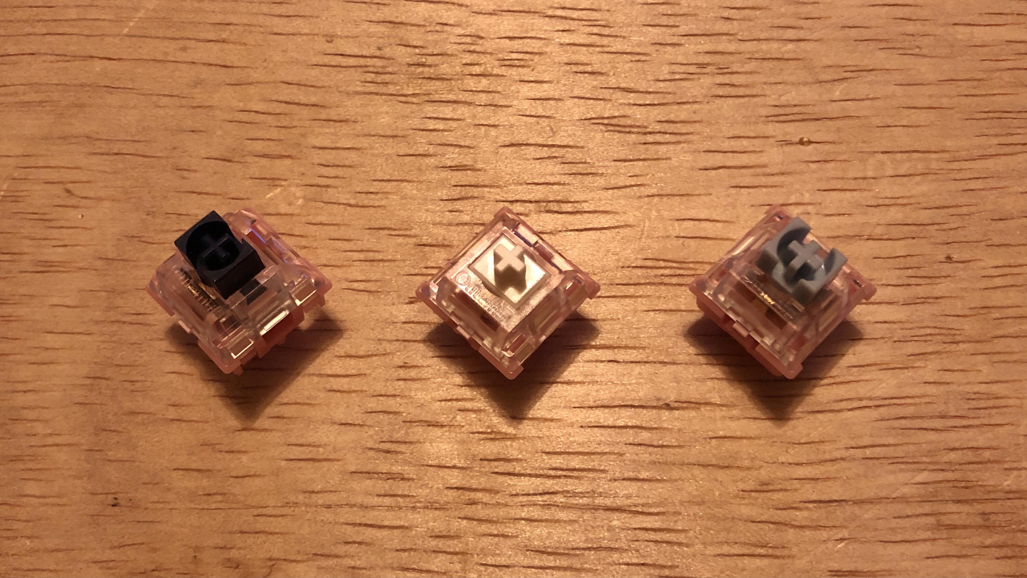

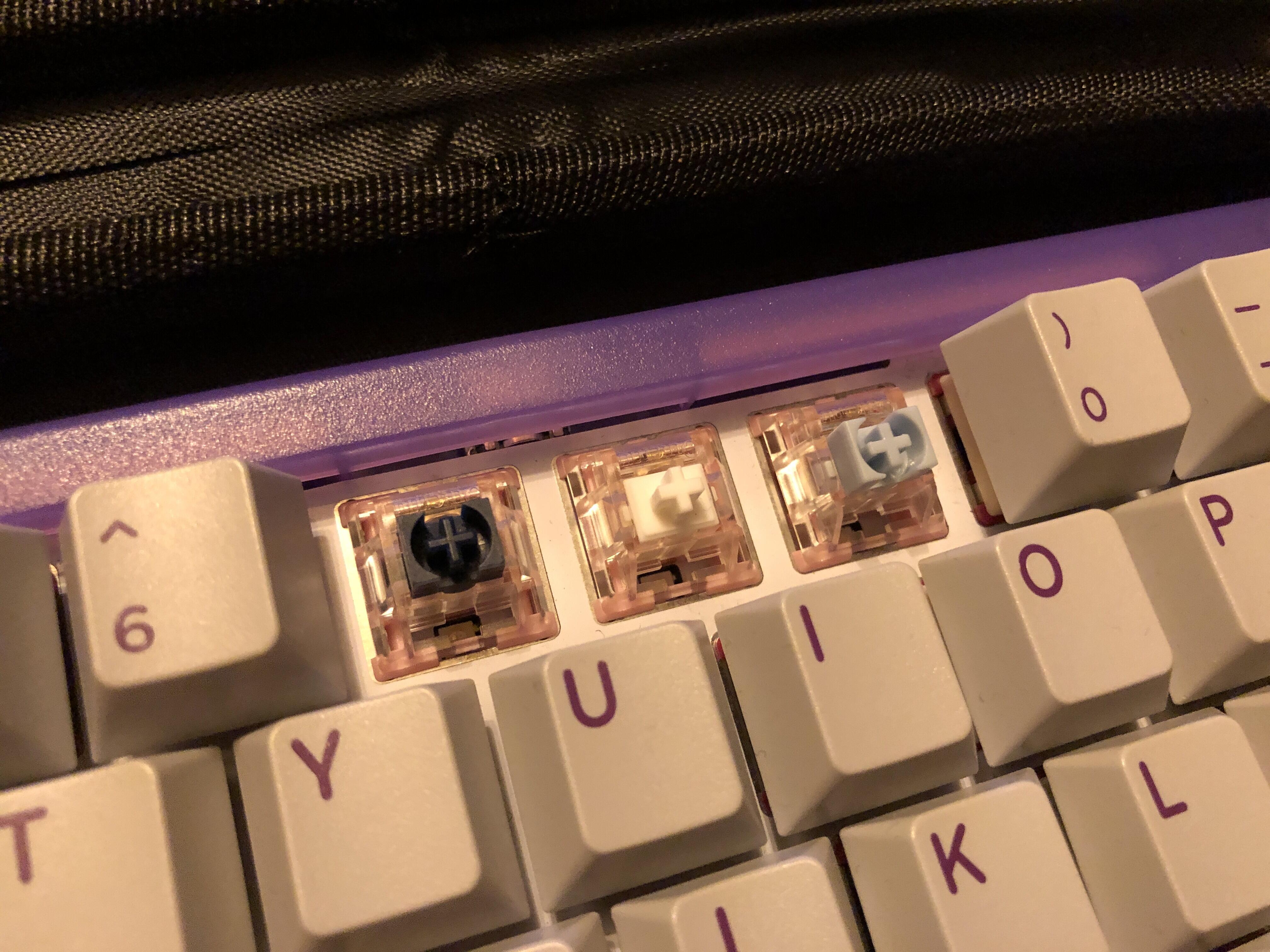

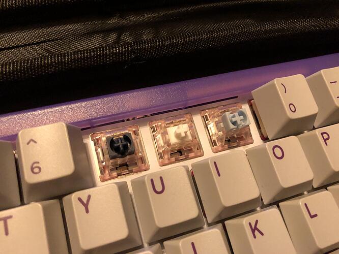

I feel like I have, but I couldn’t remember - so I pulled out my extras and tried three stems with Bobagums;
  • Blueberry Chiffon
  • White Lotus
  • Bluish White
They all fit! Well - as long as you use the clear-with-slot Gazzew tops with slightly relaxed tolerances. They look like this:
Leftovers:
I did test them.
All three function normally, and all three are actually pretty decent! In all cases I used whatever spring was originally paired with the donor stem.
  • The Blueberry Chiffon stem in the Bobagum housing definitely retains the discrete, almost crunchy feel while thankfully leaving behind virtually all of the ping. Almost feels like a BOX tactile. A bit of N/S wobble, very little E/W.
  • The White Lotus stem feels pretty clean and smooth compared to the last, returning to top more smoothly. It’s also much less ping-y than its donor switch, but also less stable having more wobble in both directions. It still makes the characteristic light-tactile sound - sort of a wiggly noise? Not totally clean but again sounds better than the White Lotus on its own.
  • I expected the Bluish White stem not to work for some reason, but it totally does. The ones I have are the older flat-bottom ones, with more recently made ones having a rounded bottom to the pole. This means they will be more quiet in the silent switches; not sure how it will affect non-silent ones. There’s a touch of ping here but I really have to listen for it. Bottom-out is pretty soft, with top-out sounding similar to the donor switch. More E/W wobble than N/S.

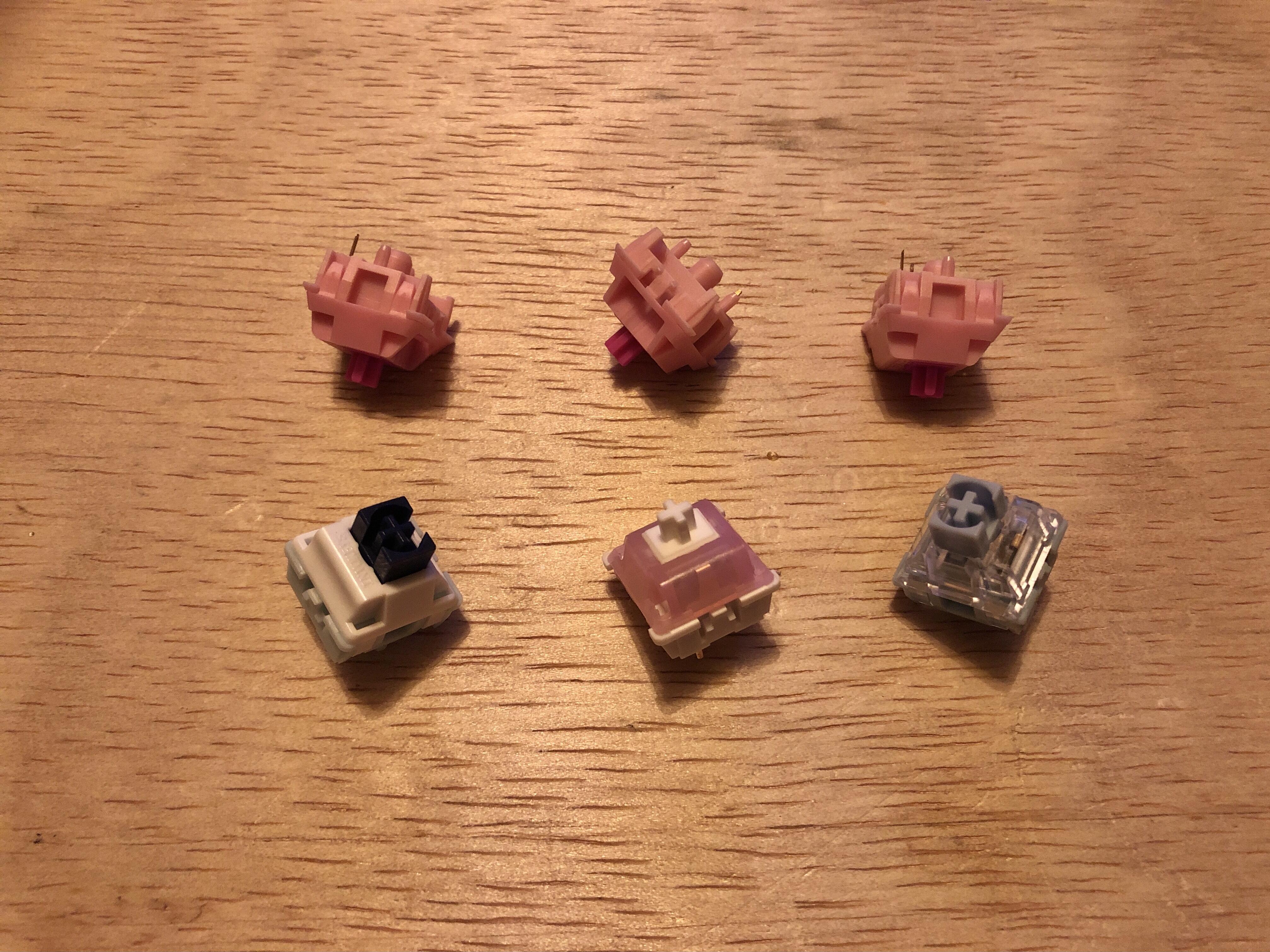

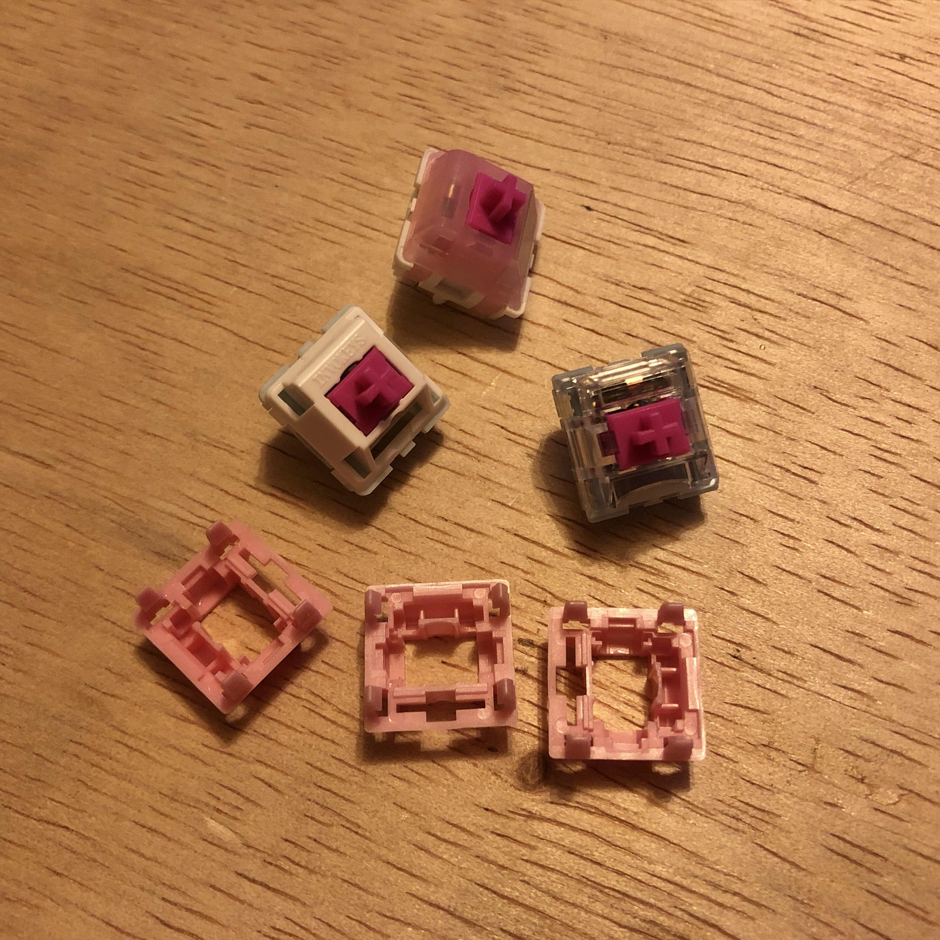

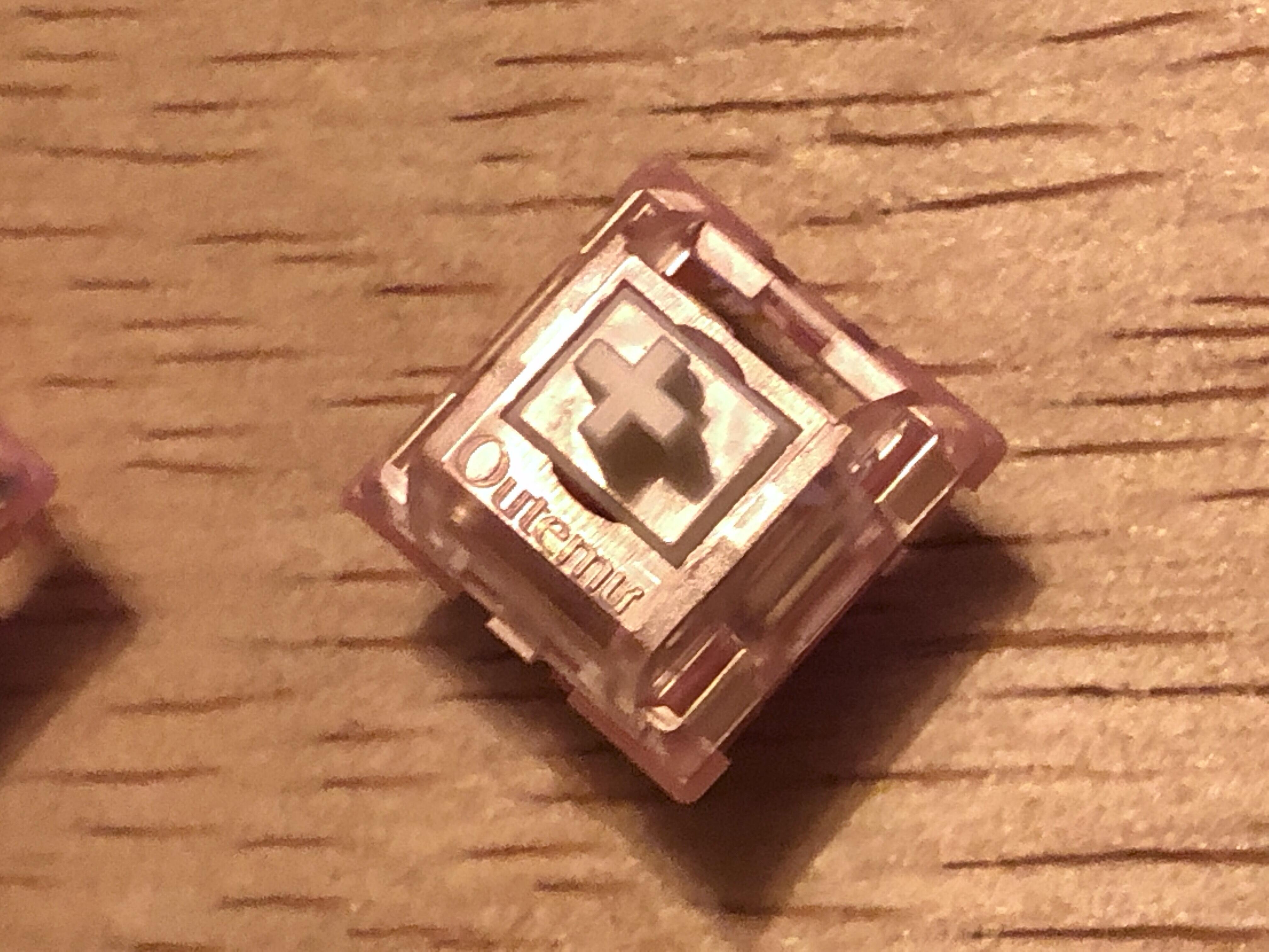

I gave this a try and they do indeed fit.
Compared with a stock Gazzew U4 (in this case an older Boba), a Lime with U4 stem:
  • does have more wobble
  • but also less leaf noise
  • thanks to that, more quiet overall
  • but light contact with the keys that aren’t presses will make more noise thanks to the dampeners brushing the top housing; there’s not enough play for this to happen in a Gazzew housing
  • with the Lime spring it is lighter, but more top-weighted; it feels a little more crisp, the whole experience a little more “about” the tactile bump
Thoughts, other mixes
I also tried the Lime spring in an otherwise stock U4 switch, and while I liked it more than the stock one, I still preferred the otherwise stock Lime with a U4 stem. Less wobble here, but more leaf noise.
Also I was wrong before - the Lime stem totally fits in Gazzew housings, and gains lots of stability. With the Lime spring I didn’t like the leaf interaction, it sort of hung when resetting the tactile bump - but with the U4 spring it didn’t have that issue. The bump itself was a lot more washed-out, but also more consistent feeling, both compared to just the Lime spring and the Lime switch in general.
So, stock U4 with Lime stem, not bad! Dunno about buying all the parts just for that, but I do like it, and it’s my second favorite of all these possible mixes, after the U4 stem in the Lime housing with Lime spring.
