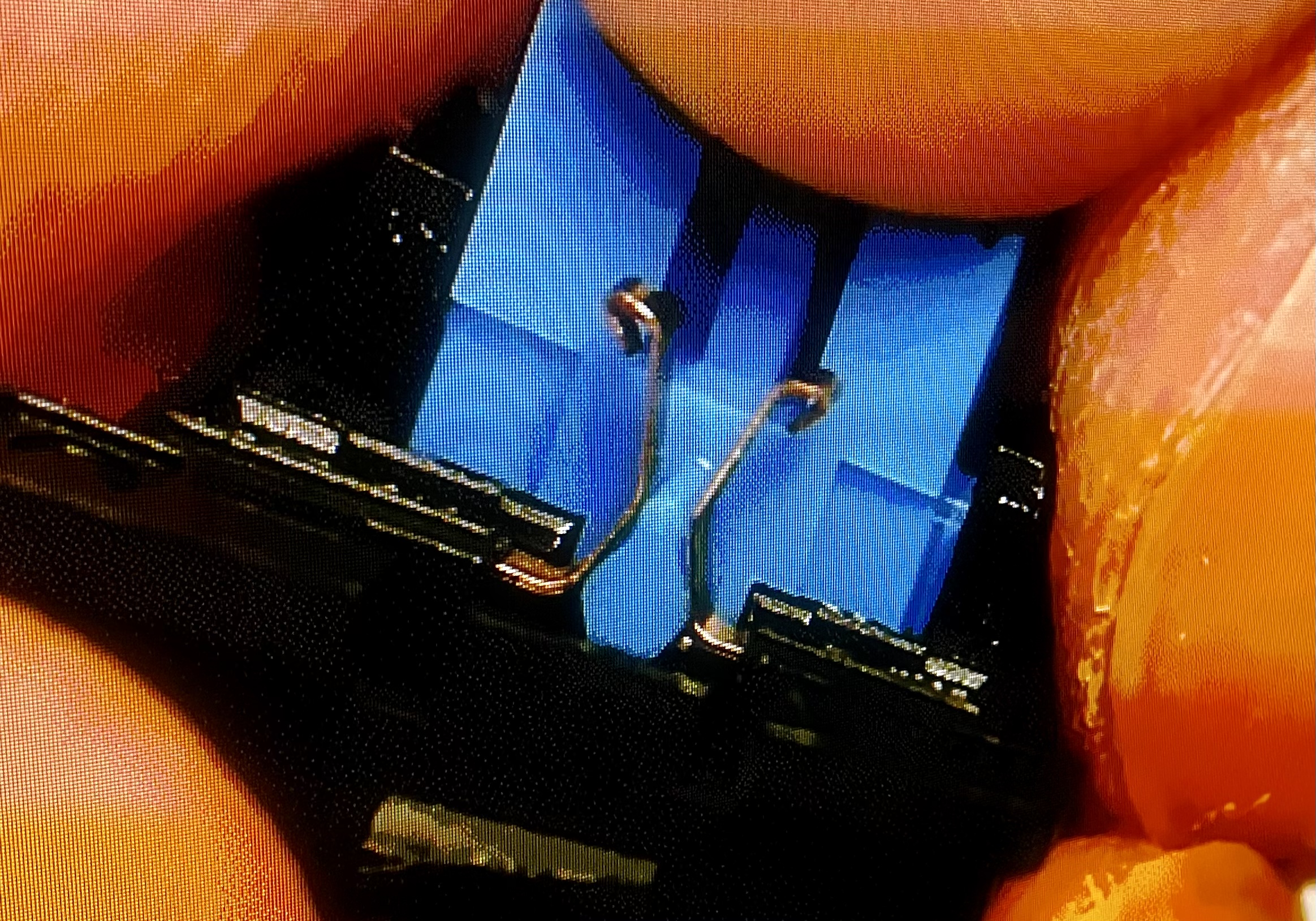

Ok so the Snap Blue switches really do use a totally “new” click mechanism. It’s neither a click jacket nor a click bar.
I put new in quotes because it has a mechanism a little reminiscent of Space Invaders clickies.
Basically a plastic diamond on the back side of the slider pushes apart two metal leafs that snap back together after the diamond passes through.
The sound is less sharp, but deeper than click bars.
