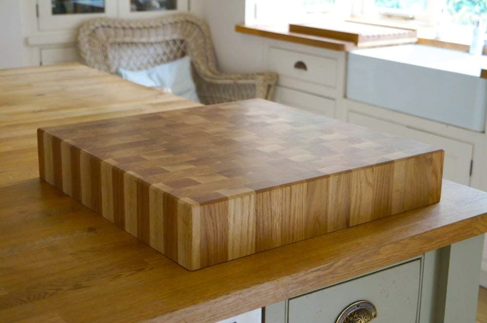

Just a thought, but what if you made it out of a large wooden cutting board? I always thought that’d be cool because they come is an assortment of wood grains, are already rectangular and of comparable height, are made from dense wood, usually stain resistant, and industrially sanded smooth.
Either way, good luck with the build and keep us posted.
That seems like a pretty cool idea. My router is yet to arrive, i’ll keep you updated for the first prototype.
