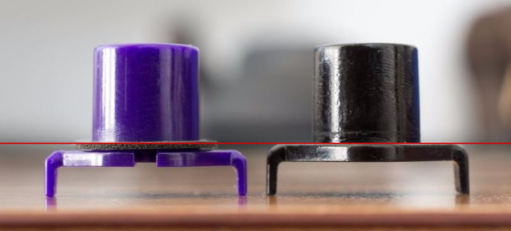

Another thing to consider long-term for the stabilizer housings is offering a “Type-S” plate that uses the taller Realforce model -S housings for the 2.25u keys (and this could extend beyond just a HHKB plate).
I may be totally wrong here (full disclosure: I’ve never owned a Type-S HHKB model), but currently one of the biggest drawbacks to the HHKB is that you can’t easily silence the stabilizer keys on it without noticeably tanking the key travel because it uses standard-height housings for those keys. There does exist a quasi-solution where you sand down the sliders and use a standard 1u foam disk, and it does help in reducing noise, but there’s just not enough material on the stabilizer to be able to sand it down and use the big boy 2.25u foam disc that the good lord Topre intended to be used. So having a plate that integrates those taller housings would easily allow for the usage of the OEM Realforce 2.25u sliders/discs and really turn this into a true Grail for those noise-conscious thockers.
I believe the difference is in the sliders, not the plate/housings.
For the 1u sliders, they just have a thinner base/longer barrel to compensate for the ring. But on the 2.25u stabilized sliders, they use a thicker foam ring (roughly double the height), and so they also increase the height of the housing to compensate.
I don’t have any pics on hand, but years back when I sold/traded some purple sliders, there was definitely a noticeable difference in the height of the housing (and slider) between Realforce silenced and Realforce stock. I have a bunch of keyboards arriving Friday/Monday, so I may be able to take pics if there’s any interest (will have stock sliders/housings, Rev B purple sliders/housings, and ancient Rev A purple sliders/housings).
Interesting. I’ve never actually used a silenced Topre keyboard or seen its internals before. I prefer the stock sound. But I’d like to take one apart eventually and inspect the differences.

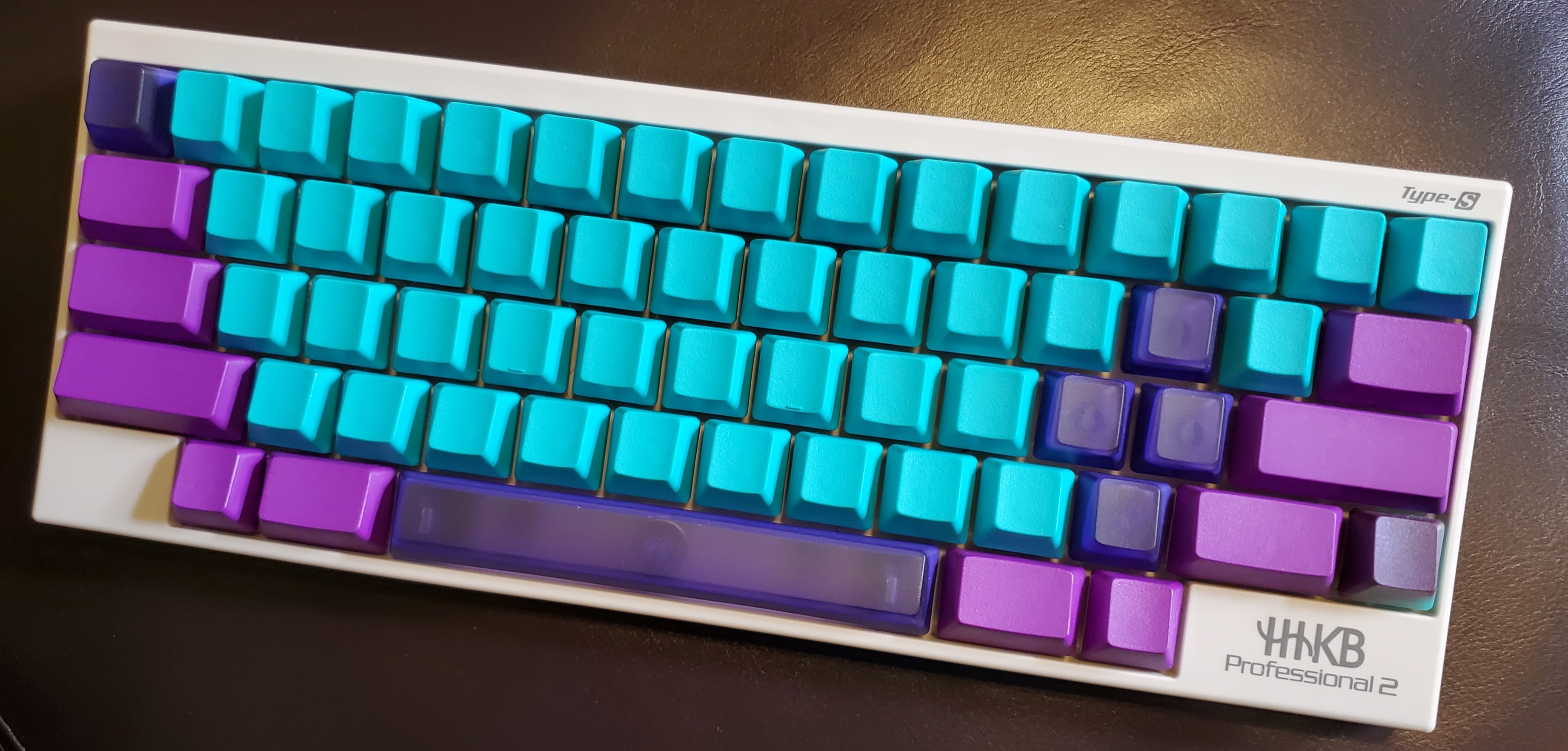

I haven’t bought any keyboard cases in a while, but I’m so in for this. I hope purple or even a cyan case is available since that would match my keycaps on my Type-S.
