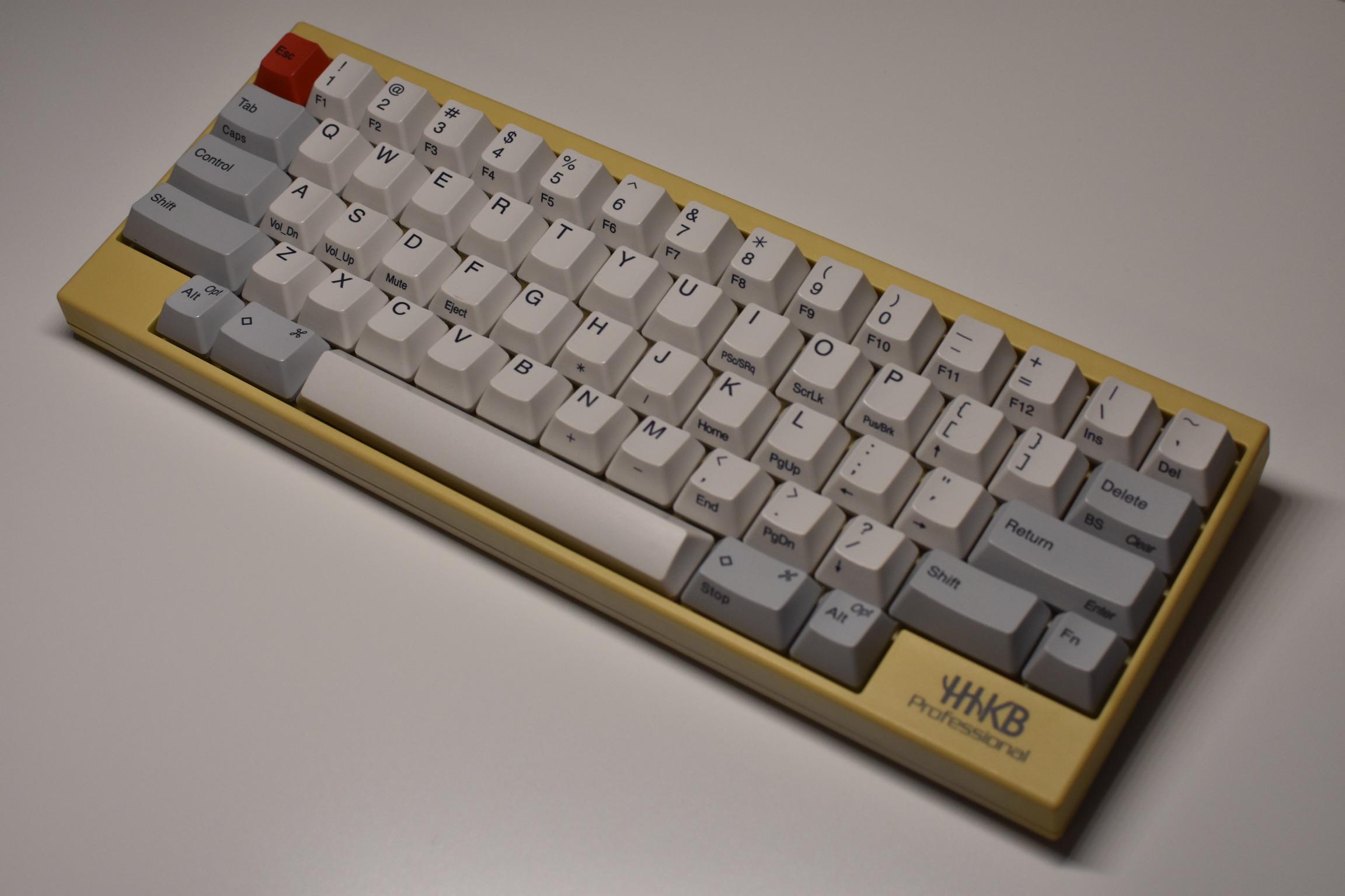

Would be too late in the piece for this round but any possibility of a yellow colourway if you run these again, as an ode how most white hhkbs end up?

Is that really natural colour change? Looks so uniform

+1 for yellow!
