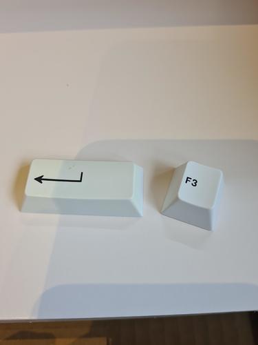

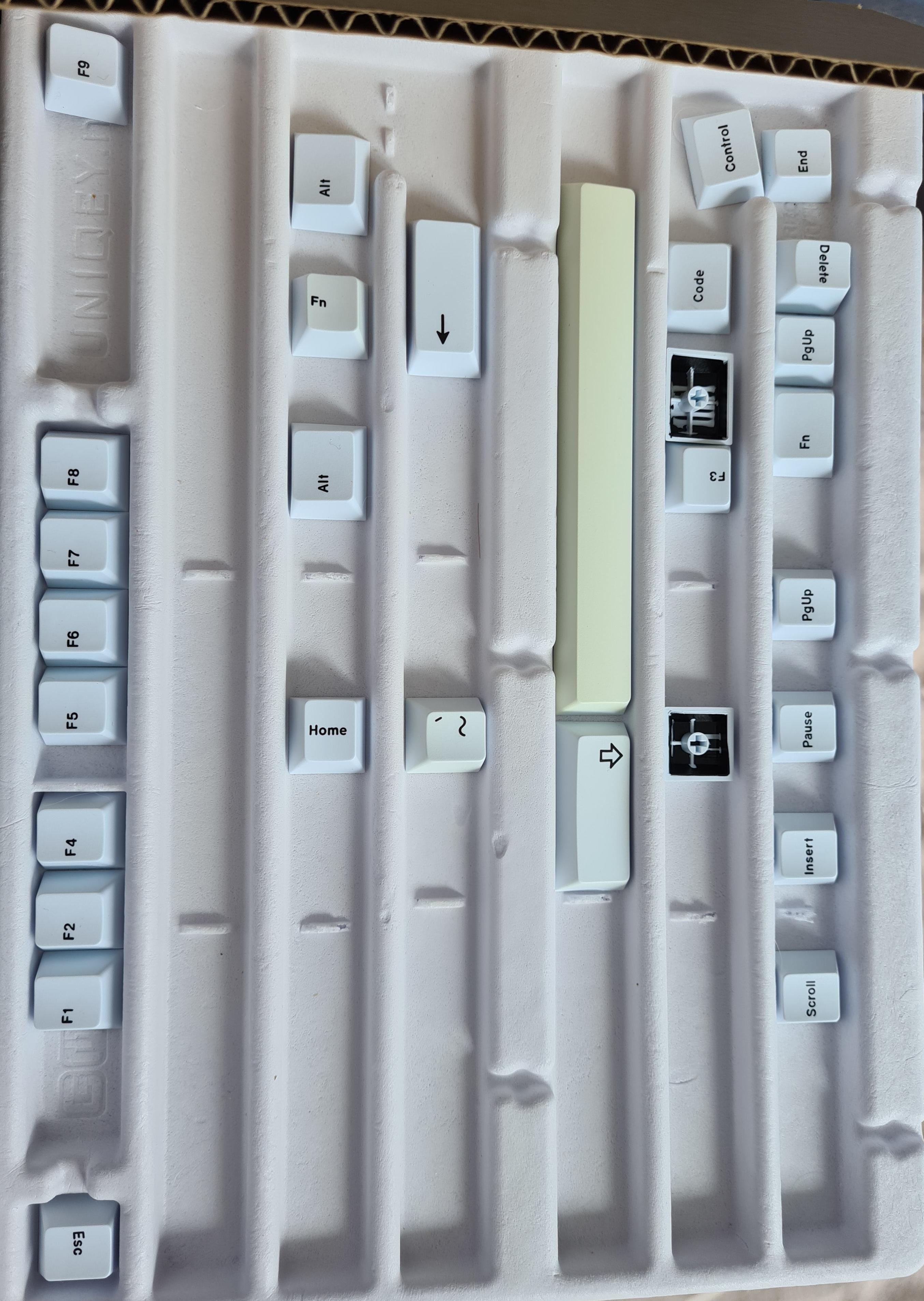

GMK Bleached is yellowing after 4 months

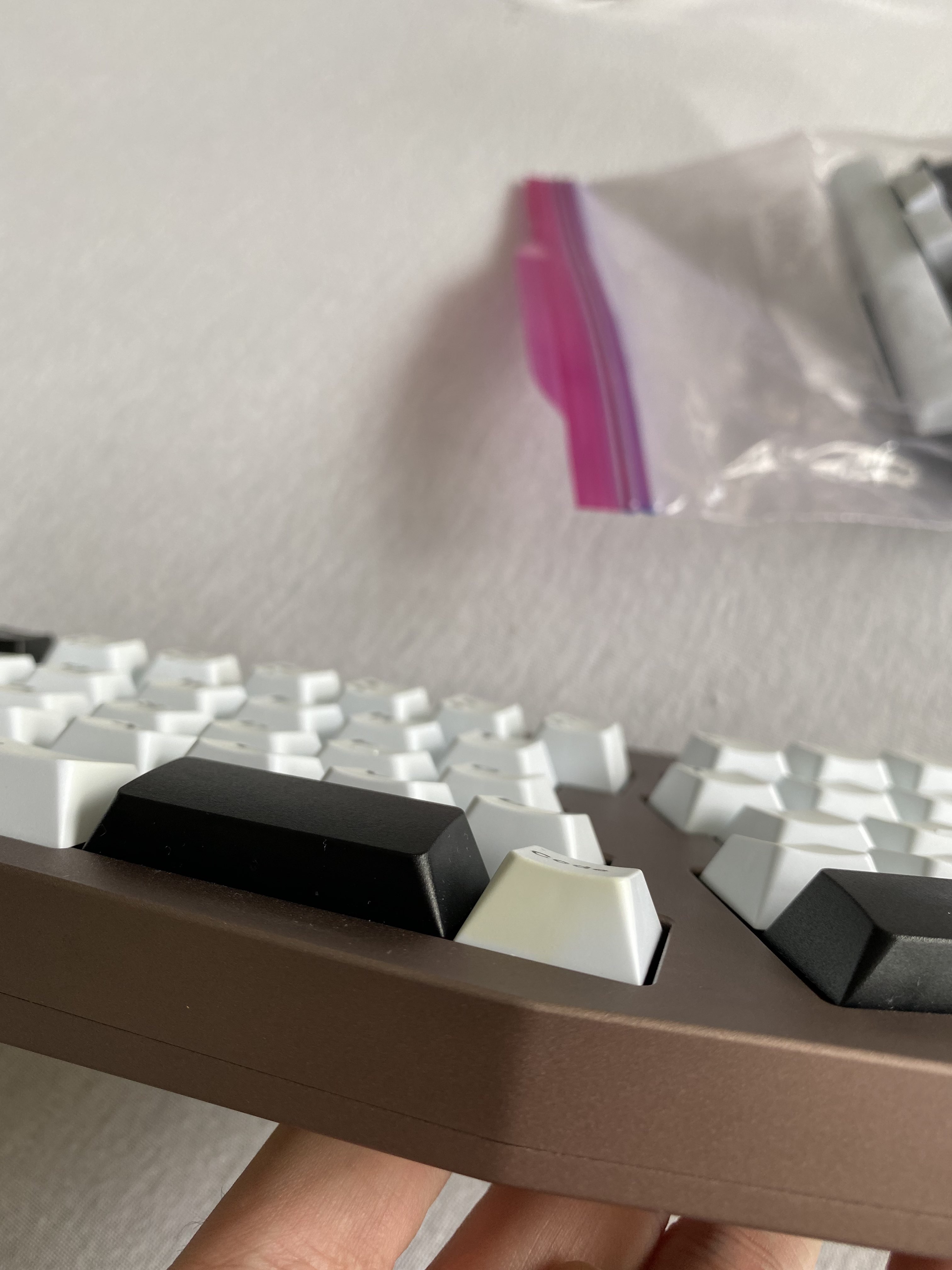

Not mine but another example
It’s crazy
From the same person

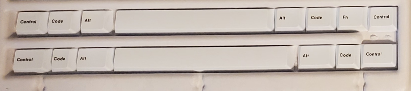

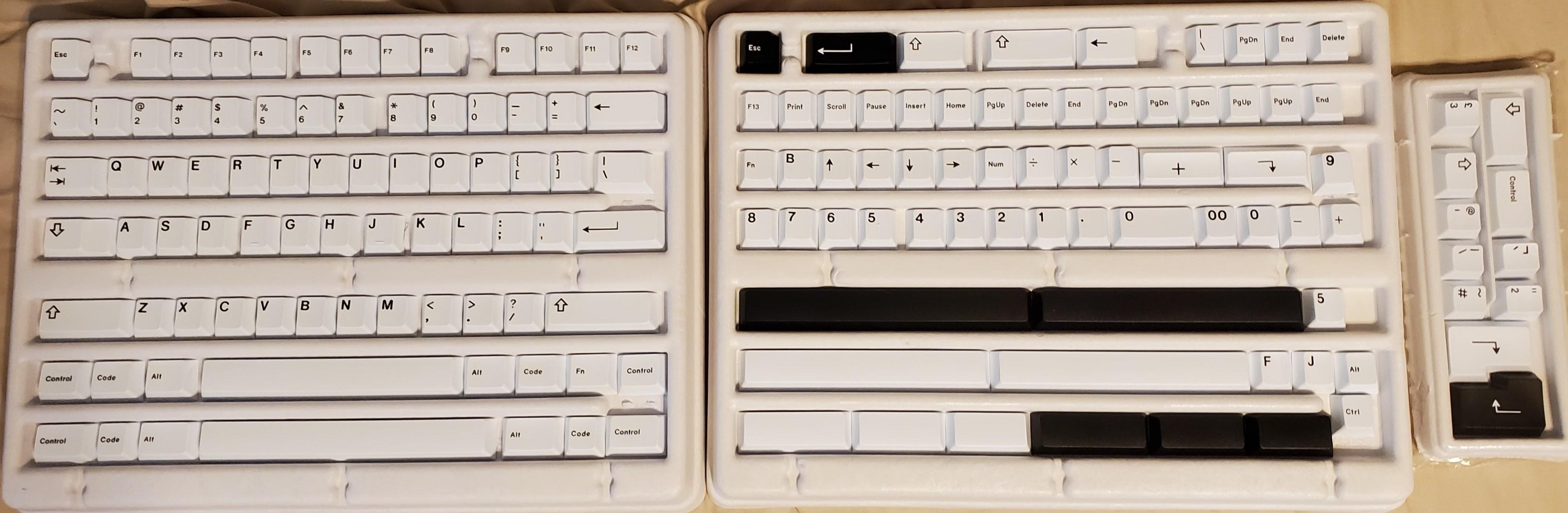

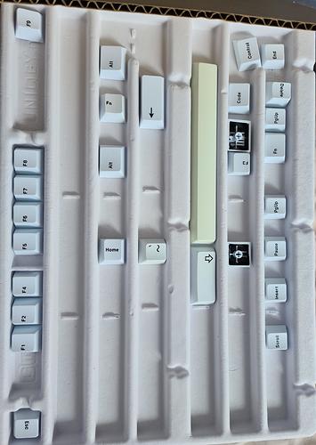

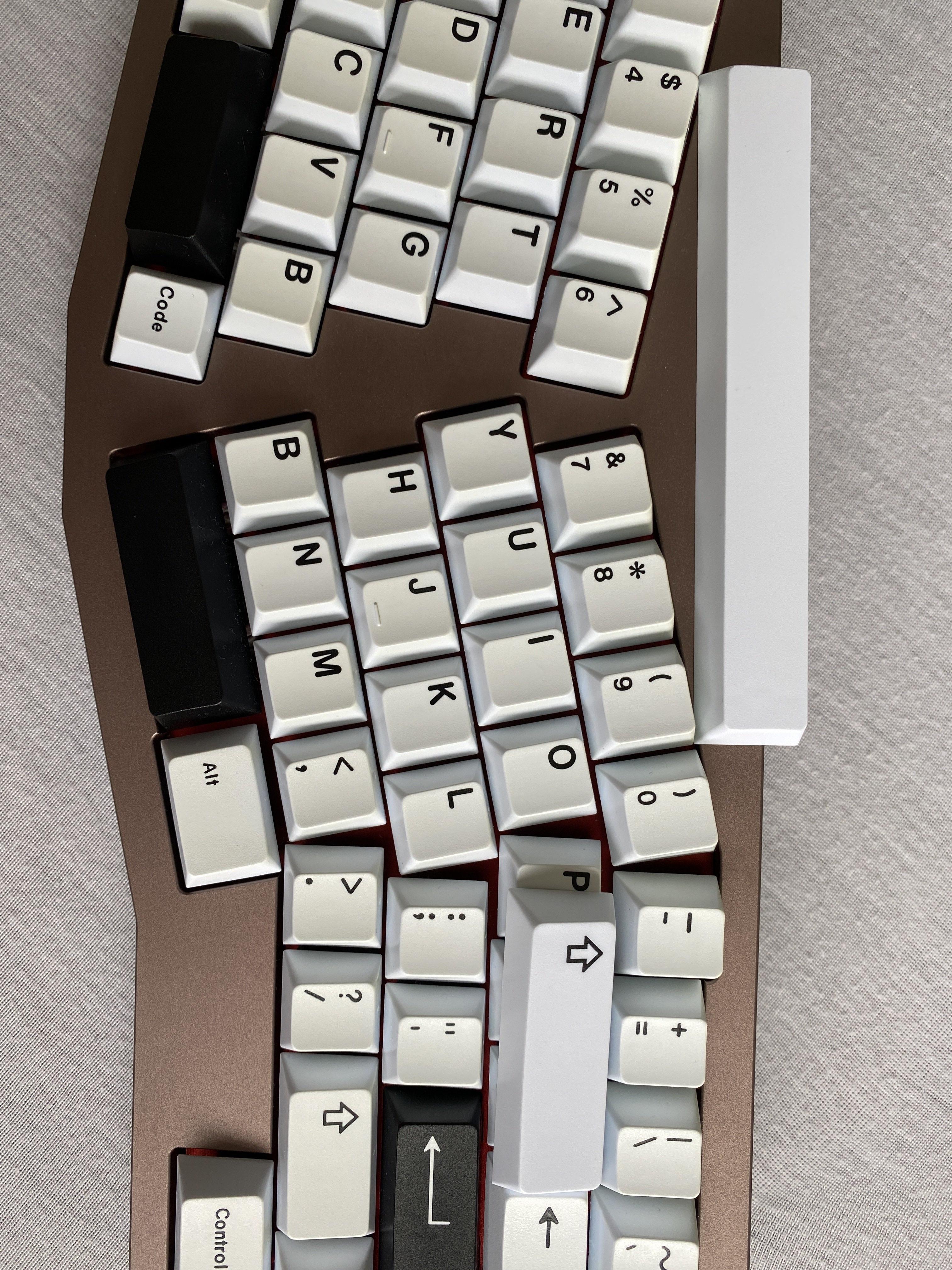

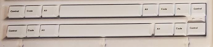

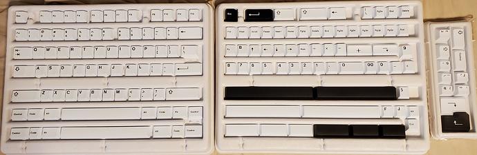

After seeing this thread I figured I better check my Bleached set out. I did have it on a couple boards so far & it sat on display for awhile. Not in the view of any windows, but not protected from the light they let in. Thankfully my set has yet to start yellowing it looks like! Makes me really wonder if this issue is just down to plastic quality? Bleached was being produced in the right time frame to have some sets made from the usual plastics GMK used & some made from the plastics they got after the shortage began.
Sorry about the potato pics, but just wanted to show my set has yet to start yellowing. The bottom picture in particular is a really good comparison. I have never used the 6.25 space row yet & only have had the 7u space row on display.

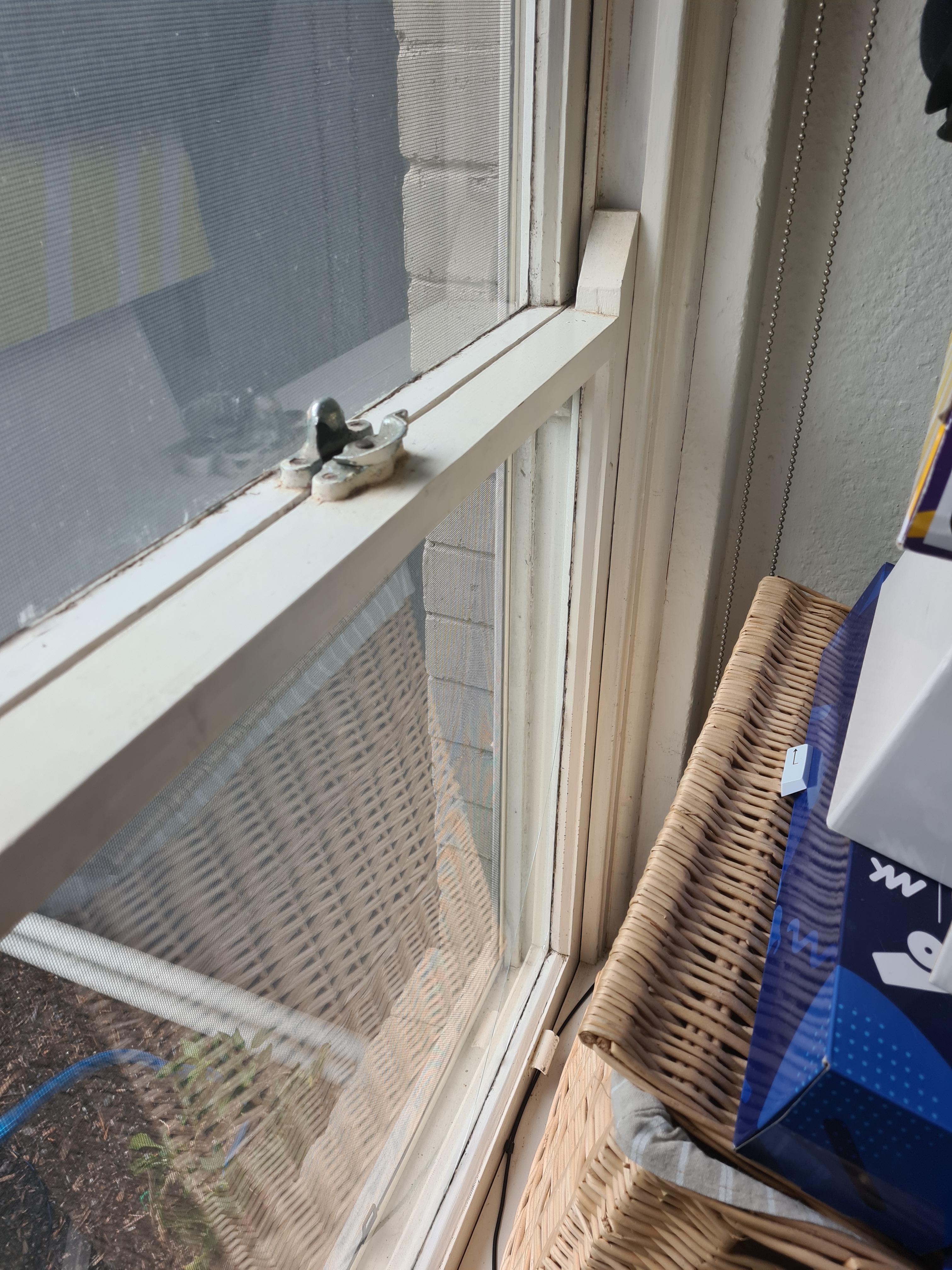

Might have to also do with the harsh Australian sun, all the pictures sent are from beautiful Sunny Australia.
I’m going to Do a test, will report back.

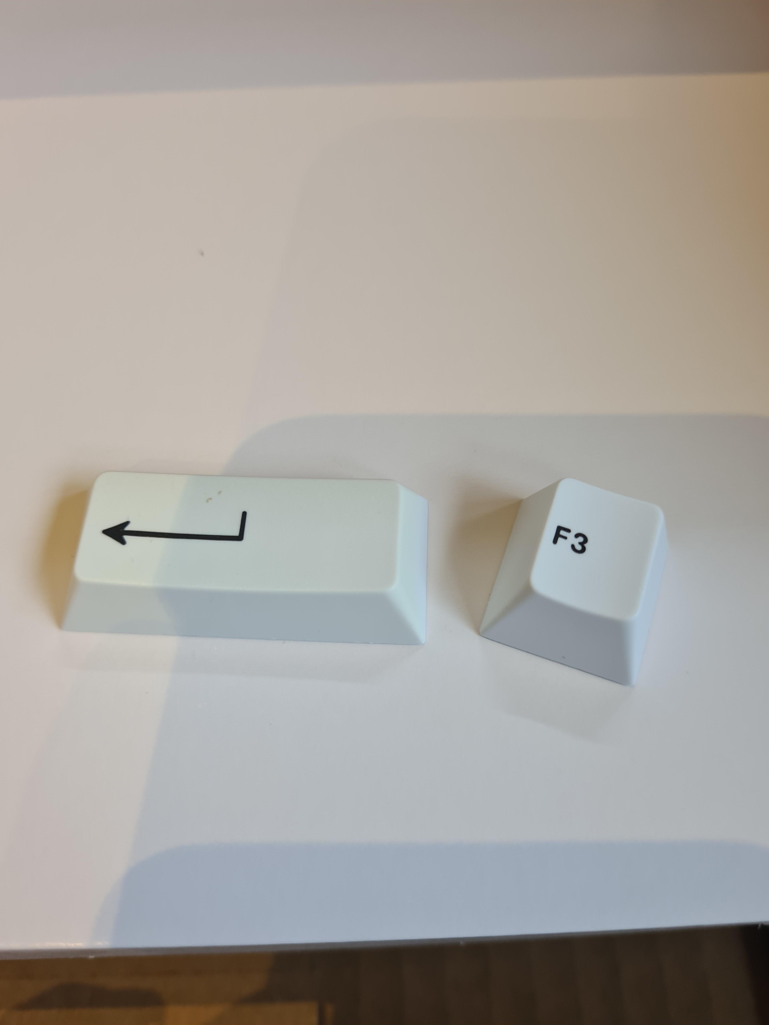

Enter next to f13 (never used)
Enter by the window

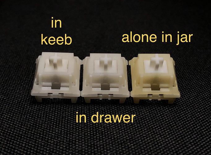

According to hbheroinbob himself, Bobas switches should not become discolored. May be worth following this topic about Boba U4 plastic aging on r/mk.
Geezus, those are super yellow. I wonder if the bottoms are as discolored.
As weird as it sounds, I can’t think of a better explanation than what Paul is saying there - yellowing to that degree is not gonna happen on its own - especially not on the time-scale of weeks or months.
The only plastic I’ve seen discolored that bad is stuff that’s been sitting out in the elements or in abandoned buildings for multiple decades. Seems like there has to be some chemical accelerating the reaction - and I’m not convinced Bobas would turn that color even if left out in the desert for thirty years.
Agreed. It’s bizarre to see something yellow this quickly.

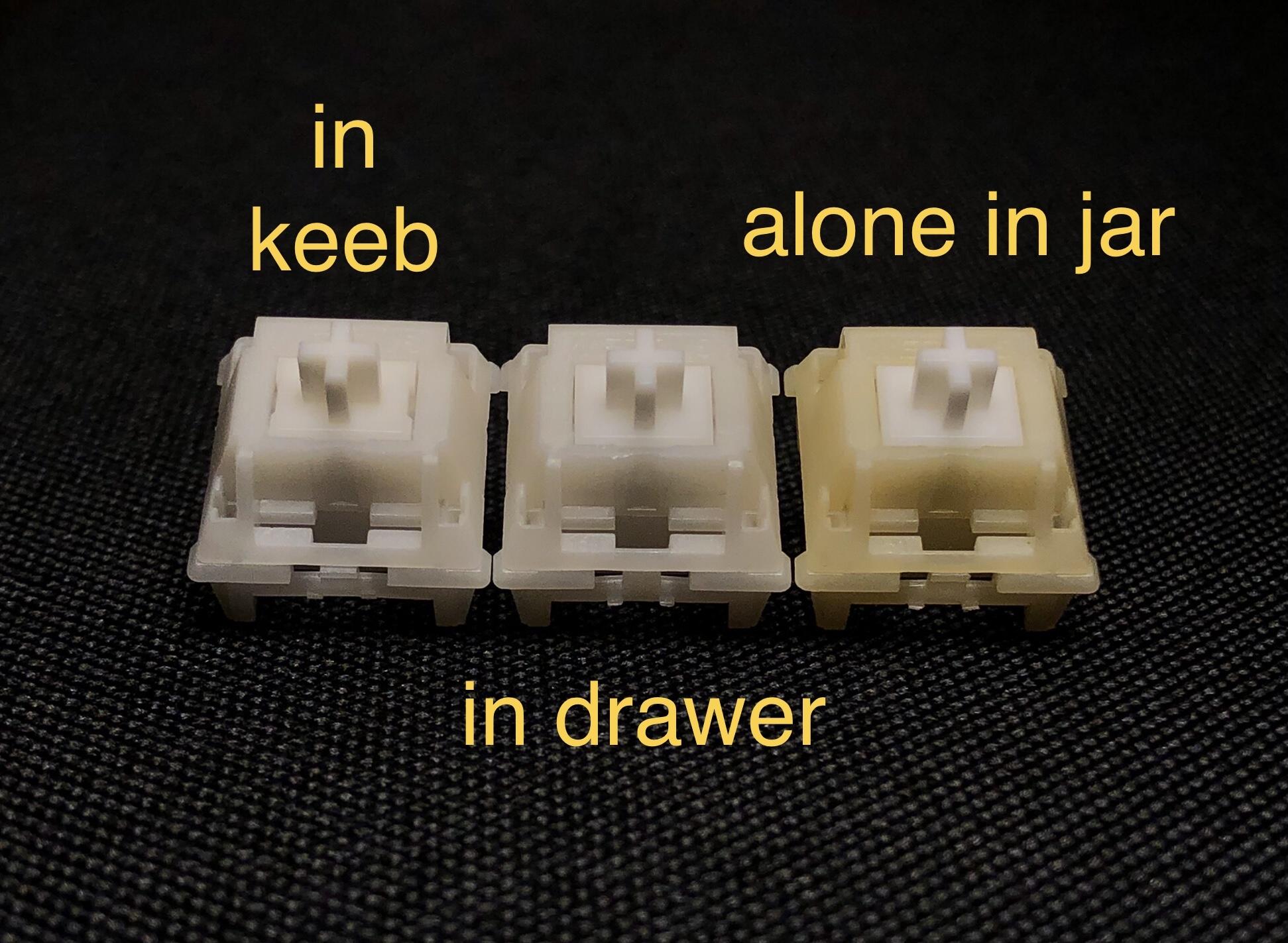

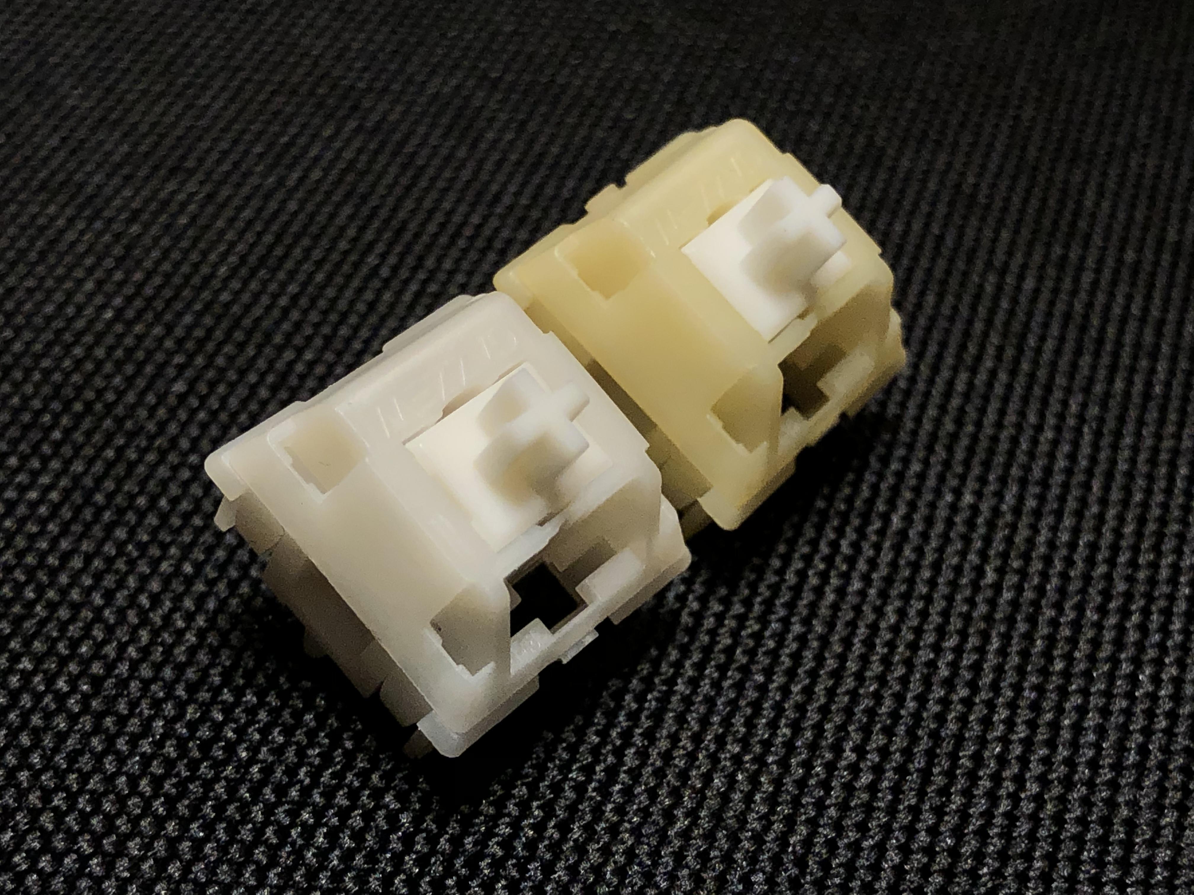

The person who posted the switches photo claimed they don’t smoke or vape and the switches were soldered in their board the whole time under keycaps… and not like stored on their car’s dashboard in Abu Dhabi or something.
Makes me wonder if they were exposed to something before (or maybe after) they got to the user.
If the bottoms are as yellow, I have to assume it’s some kind of corrosive atmospheric phenomenon.
Perhaps a super small batch was unintentionally produced with subpar plastics, and they were hoping no one would notice.
I think that’s the most likely scenario; very unlikely it’s just UV.
Maybe the switches were stored in a combined keyboard and bromine storage facility? heh
well heck

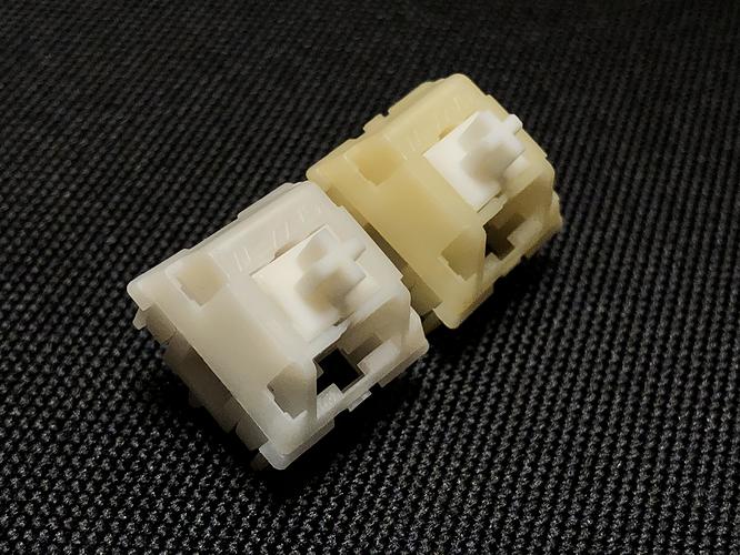

A little more detail; the discolored one was by itself in the jar I had been keeping a set of 68 in - the rest have been in one of my keebs. The normal one next to it is from that set. The jar was sealed but not exposed to much light.

ABS plastics can yellow even when not exposed to sunlight due to oxidation. This oxidation can be accelerated due to higher temperatures (hot room in Australia or greenhouse effect in a glass jar) or plastics that do not have enough anti-oxidents mixed in (some GMK batches yellowing faster than others)

Just a small update on my keycaps, boy is it looking worse and worse.
