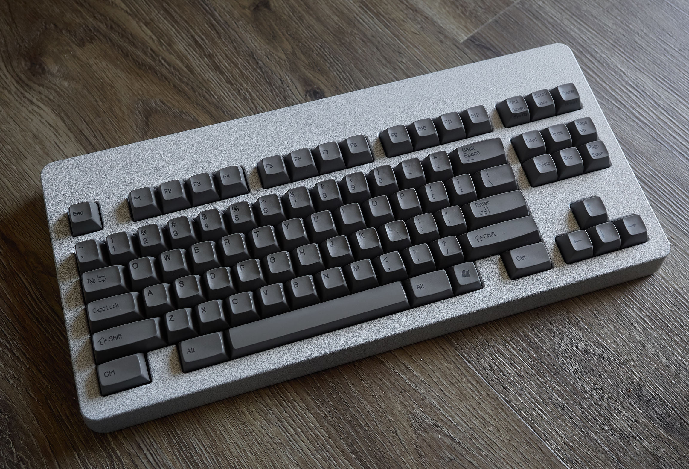

[GB] the Norbaforce Mark II
Indeed. The factory has finished all the work as of Friday and I’m just weight for them to arrange the freight shipment back to me.
I finally dug out my camera after moving -

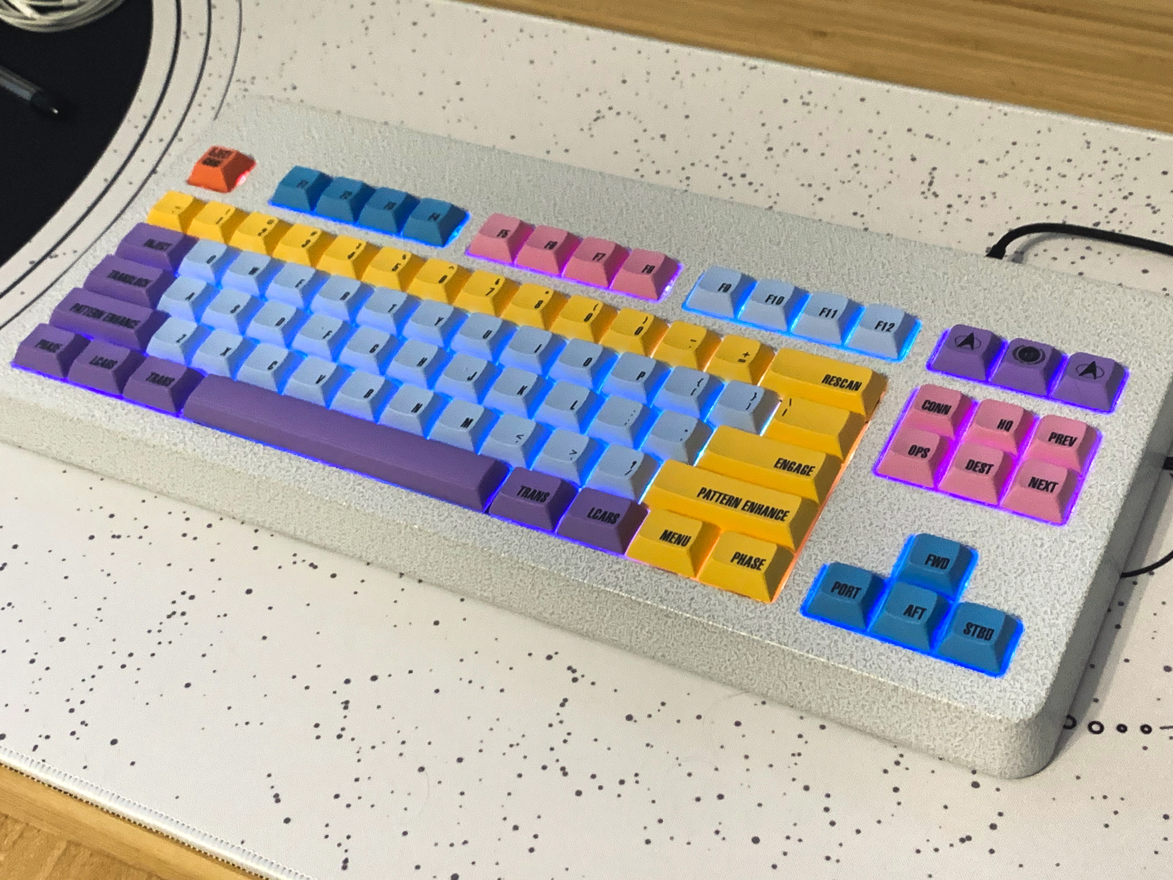

Ordered some RGB deskey silencing rings the other day, and they were delivered this morning. I went through the same routine as my novatouch:
Removed sliders
removed housings
lubed plate around housings
reintalled housings
installed rings
put sliders back in
Not hard, but tedious. I also took the opportunity while it was apart to add extra lubrication on the stabilizers.
I have to say, even with all of this work, the RGB Realforce still doesn’t sound nearly as good as a factory silenced FC660c or my deskey modded Novatouch. I really think it’s the springs under the domes. They seem to rattle during keypress. I hadn’t noticed it on my previous topre boards, but you can hear it if you get close.
Not a huge price to pay for such a lovely boad though :slight_smile:

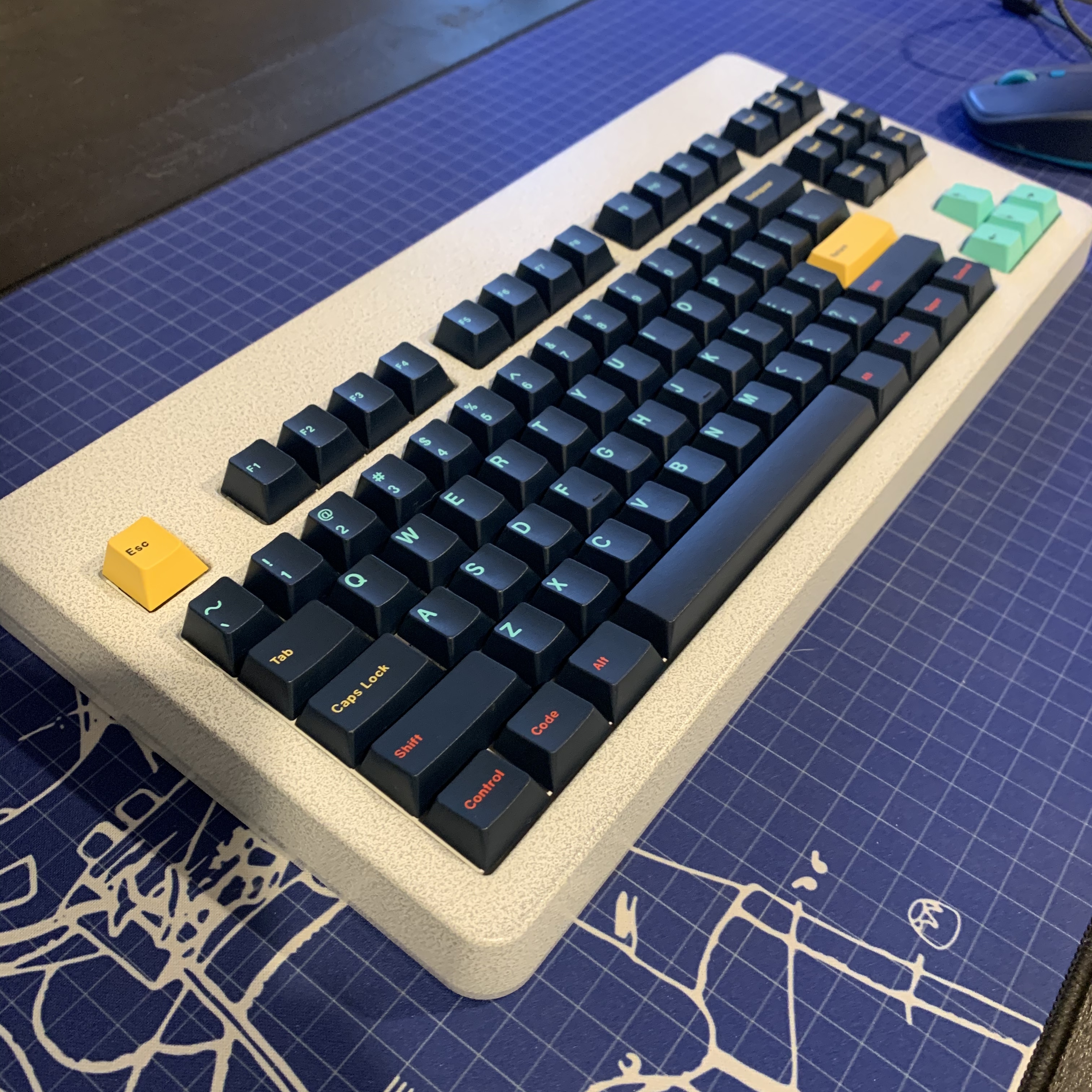

Well I did it.
VHS norbaforce
Realforce r2 rgb
Deskeys 3 silencing rings (rgb variant)
Lubed with 3204
Lubed stabs
Gmk metropolis
Sorbothane sheet
I couldn’t be happier with it. Thanks @norbauer! Brilliant work.

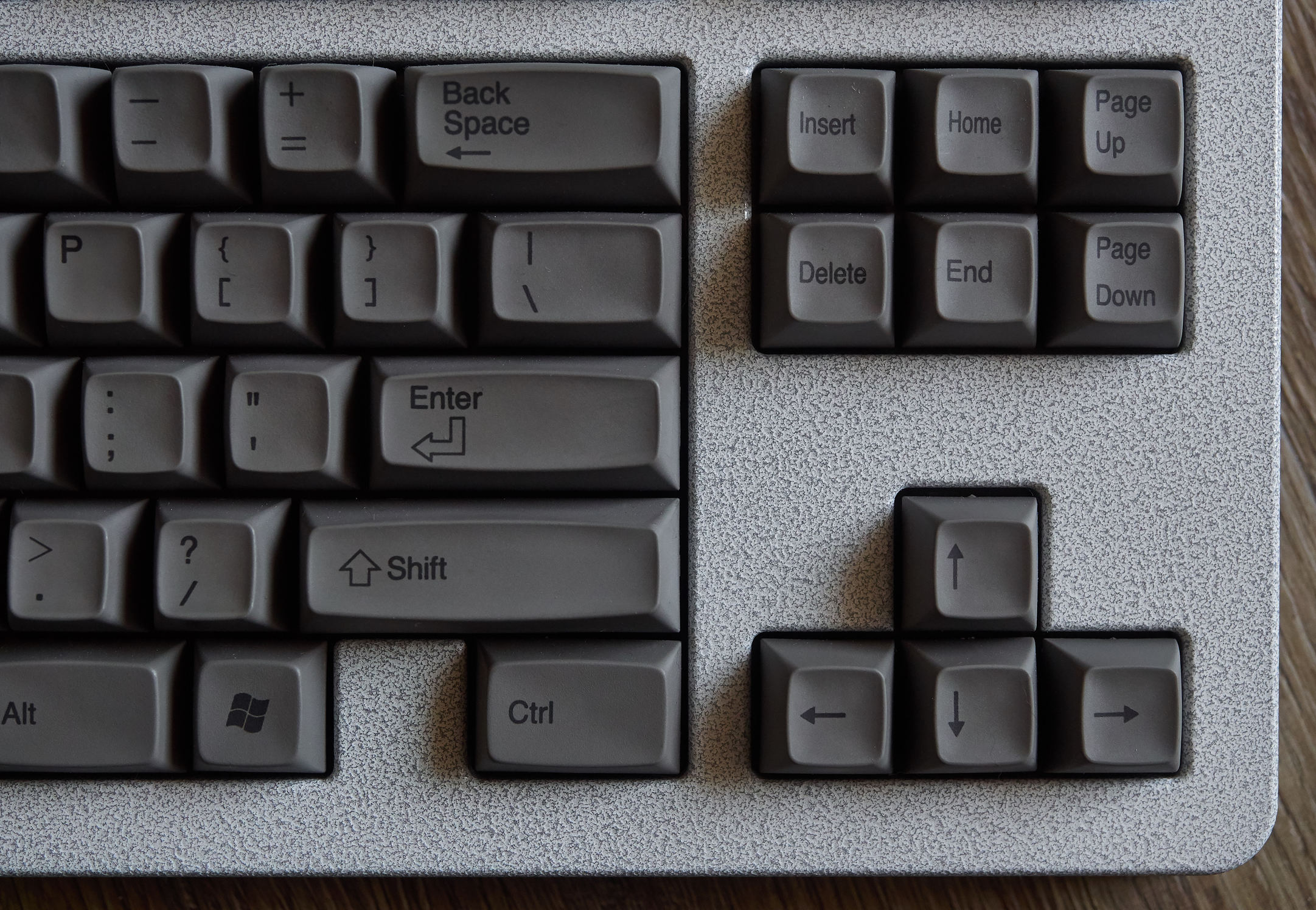

It’s less noticable with DSA caps. Current setup :slight_smile:
horrible photo, but you get the idea. I forgot how good 0 degree incline with DSA can feel. Top 10 board, right here.
