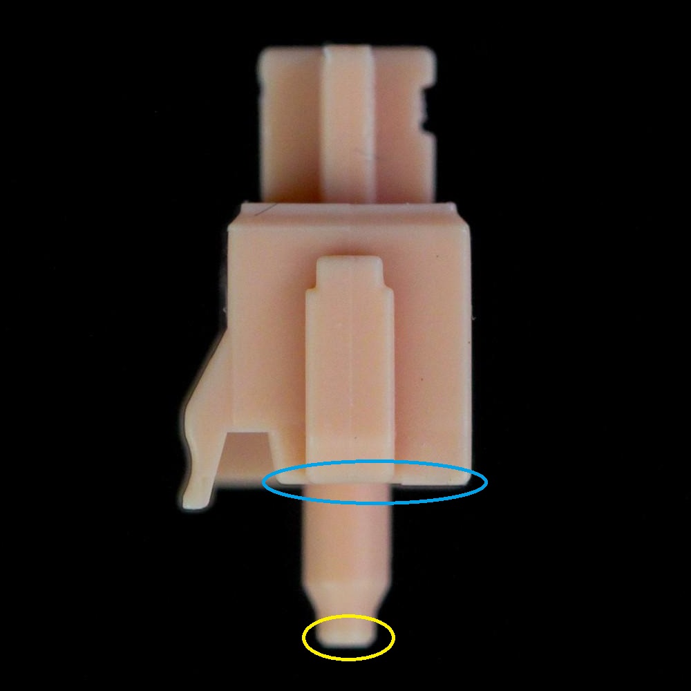

Long pole switches are a phenomenon caused by using switches with longer than usual poles, resulting in the stem bottoming out on the pole (yellow) rather than bottoming out on the stem rails bottom (blue) like it should.
Pictured: Kailh Halo true stem with the long pole, the stem of the OG long pole switch, the Holy Panda
Originally it was made using Kailh stem (Kailh housings had deeper well) in a non Kailh housing, later companies produced switches with just enough length to hit the housing before the rails, without sacraficing travel.
Thanks, that’s a very clear explanation. Maybe this will have a salutary placebo effect of causing me to feel they’re cutting me short no longer.
