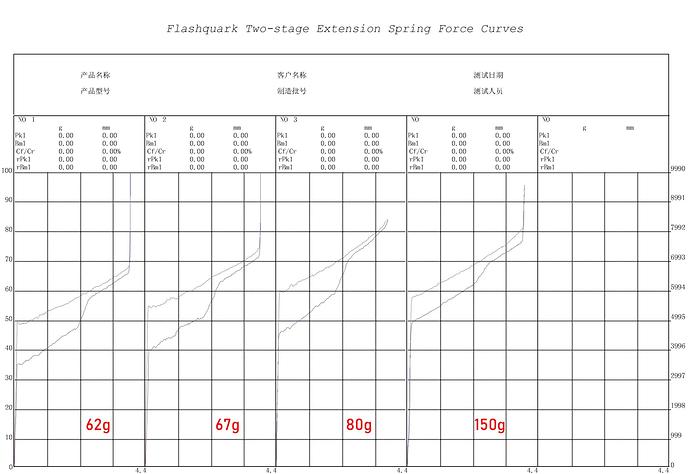

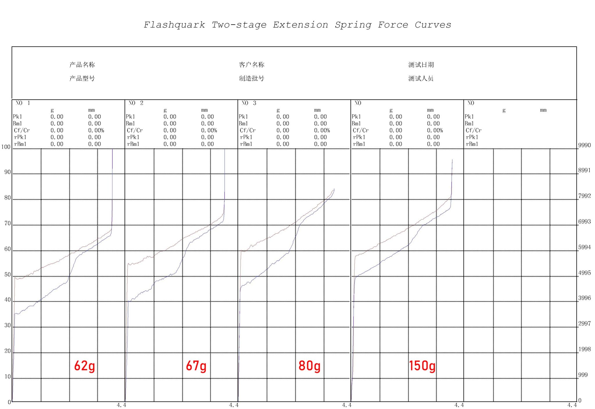

Is there a force graph available for two-stage springs?
UPDATE: nvm. I found it one at Flashquark site. Interest. So same linear slope on downstroke then a sudden collapse in the middle of upstroke?
Force curves and finger feeling don’t go together ![]()
But I would say the 58g I got from Flashquark.com feels soft and nice downwards and upstroke is snappy like a 68g spring.

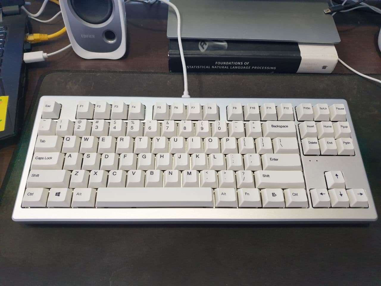

Just received the AR87 with Cherry MX Blacks. I’ve been planning to desolder them and add Unholy U4s… but surprisingly the MX Blacks feel quite nice to type with. They aren’t too loud as well which is nicely welcomed. Will probably try using these MX Blacks for a bit
Looks great. Too bad AR87 doesn’t allow switches to be opened without desoldering because I think Cherry MX blacks are best when lubed, both feel and sound wise.
