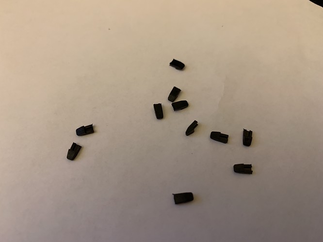

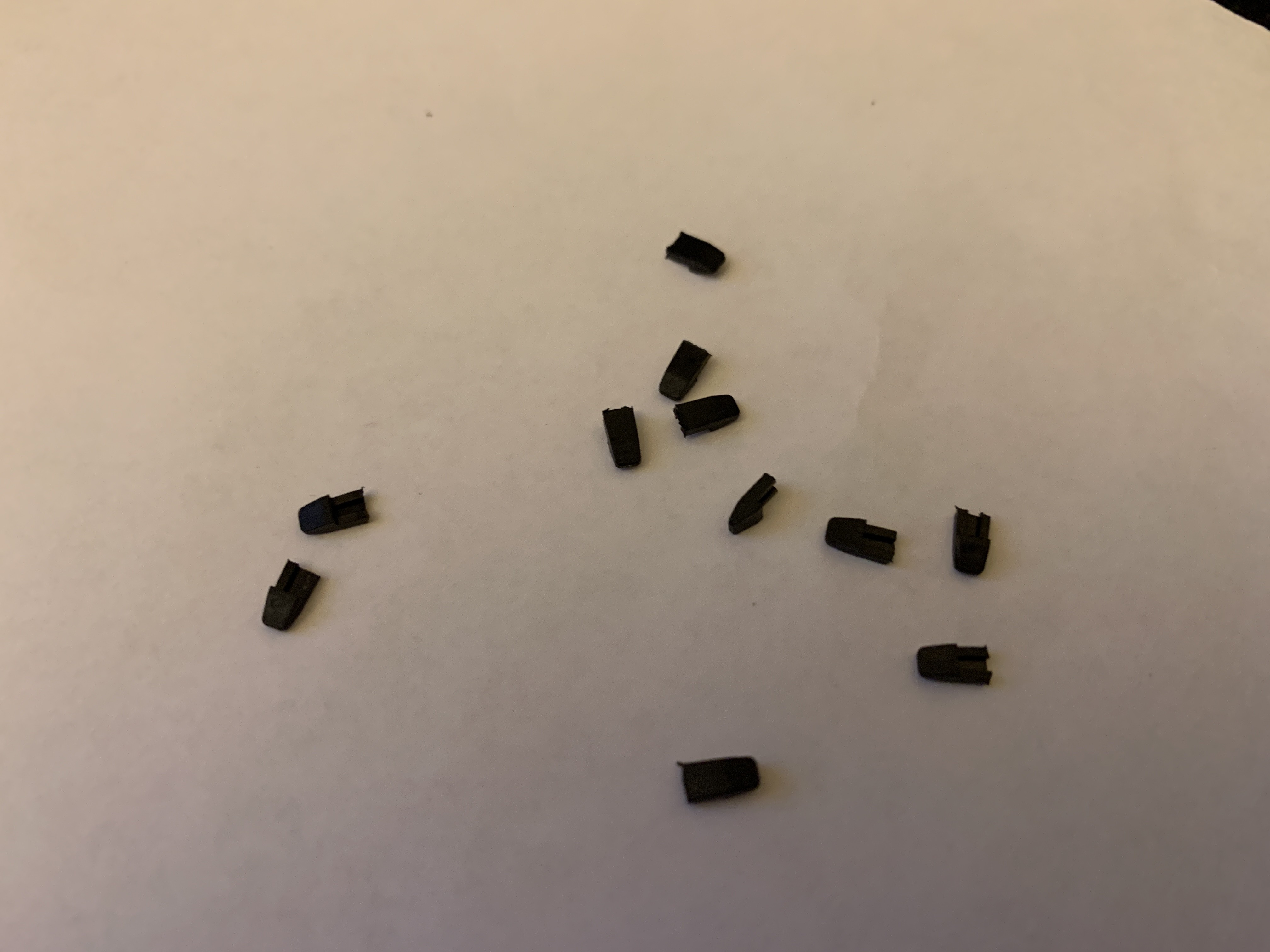

Legs on NK Dry switch housing seems to break off easily. Found that two out of 62 installed switches had a leg broken off.
HP and Cream legs are brittle too but you can tell when they’re about to break off they don’t return back to position after opening them up frequently. I couldn’t tell with NK Dry until I found the broken off legs while removing the switches.
UPDATE: I had removed switches from only two rows when I posted this. While removing the remaining three rows, I found 11 more broken legs. That’s 13 broken legs total. Almost felt like a horror movie.
I threw away the first two but here is the photo of the 11 I found later.
Yikes, that’s a lot of broken legs just for one keyboard…
I have never seen that many broken legs from one keeb wtf…
What type of plate were you using these with? I had a similar issue with Dorp HPs in the brass plate for my E6.5. Although that was an ultra tight fitting plate.
I had POM plate without gaps on the side. Never had broken leg problem with other switches but now I’m wondering if pulling out the switch very slightly angled to the side could exert enough force on the legs to break them. A few switches had both legs on a side break off.
Hmmm, that could have contributed to them breaking. Although TBH on a POM plate, tight fitting or not, pulling the switches out at an angle or straight, I really do not think this should happen. I’ll check some of my NK dry yellows in a little bit to see how brittle the legs on the top housing on mine are.
