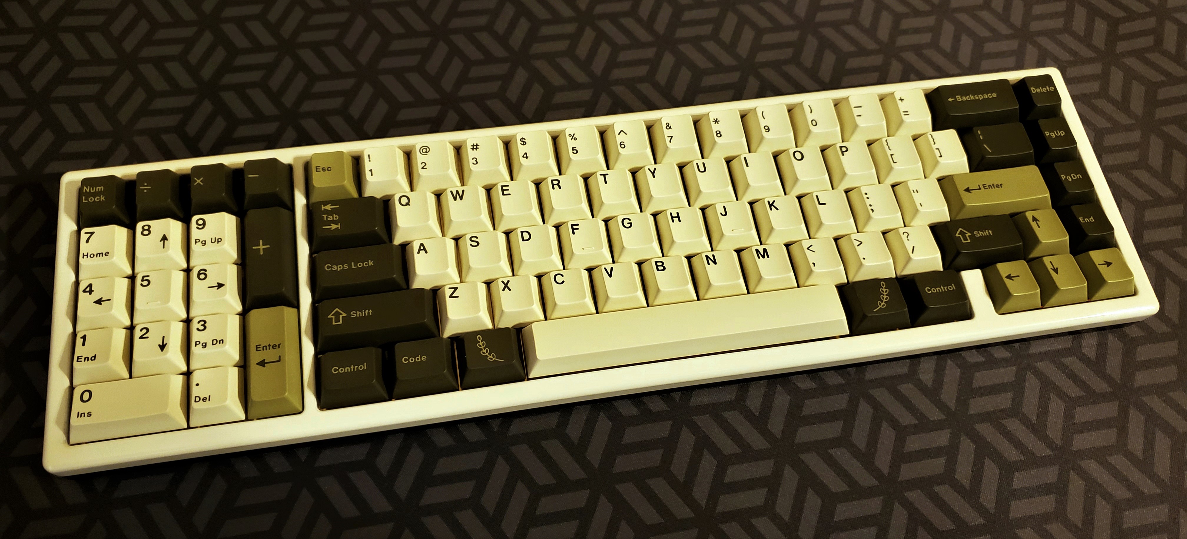

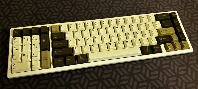

It’s a great combination. I REALLY wish I had known about CRP Desko when the GB happened [in Canada, no less.] I have two polycarb kits, so Desko would be great.
At least I have a CRP in GB.
Yup. CRP Desko is the best keyset I have. EnjoyPBT and GMK are nice but feels flimsy next to CRP. It’s not clear why though. Slightly thicker walls or perhaps the PBT mix they’re using? The difference is almost as noticeable as SP made SA keycap versus other SA keycaps.
I wish they’d add some more modern keysets to the line beyond the weird classics they have. I’d jump on CRP Modern Dolch Light or CRP 2048.
